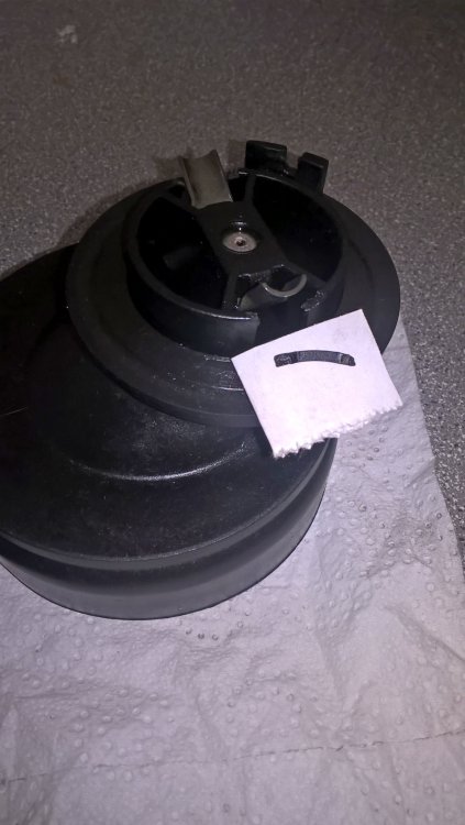

  3. Thanks totoro Knowing someone else has done this is very useful. Sad as it sounds, I'm looking forward to trying this because it means the car's back on the road (got work and a hospital appointment within next week). Hopefully engine type (AUB etc) will be irrelevant, can't see it being any different. I take it the damaged item is only good for the bin now and not fixable?
  4. Thanks sepulchrave, Appreciate the confirmation. Thinking about it now, the item in question is just an extenstion, so it should just "plug/twist in" when I get one...I think the one side broke in the hands of someone else when the spark plugs were changed at sevice time, and I managed to break the other (now weaker) side 🙄

  6. Hi rum4mo I didn't see anything else that had dropped off...the tiny part as shown on the small piece of paper was hanging off so I grabbed it quick! Re fitting the filler cap to cam chest directly, great idea, I'll try that tomorrow but it does look to be slightly too big. I've looked online and have found this on the bay...just seems a shame I likely cannot re-use my existing filler next as is. Does anyone know why they break like this? And any tips for re-fitting should I find a replacement? Should they just clip back in easily or is there knack to doing it? I'd like to get in back and up and running for later this week if possible, for work etc
  7. Hi, Today I swapped out the last v old coil pack (they're probably the originals and had done 123K!)... to fit the last one I had to remove the pesky oil filler neck. Whilst I managed to remove it, and the new coil pack went in a treat, it now appears a tad broken. I noticed that a smal bit a metal had snapped off. I'm unable to refit the neck as it's just very loose even when lined up with the location notch. I've attached a shot of the offending item. Is this somehow usable or just junk now?
