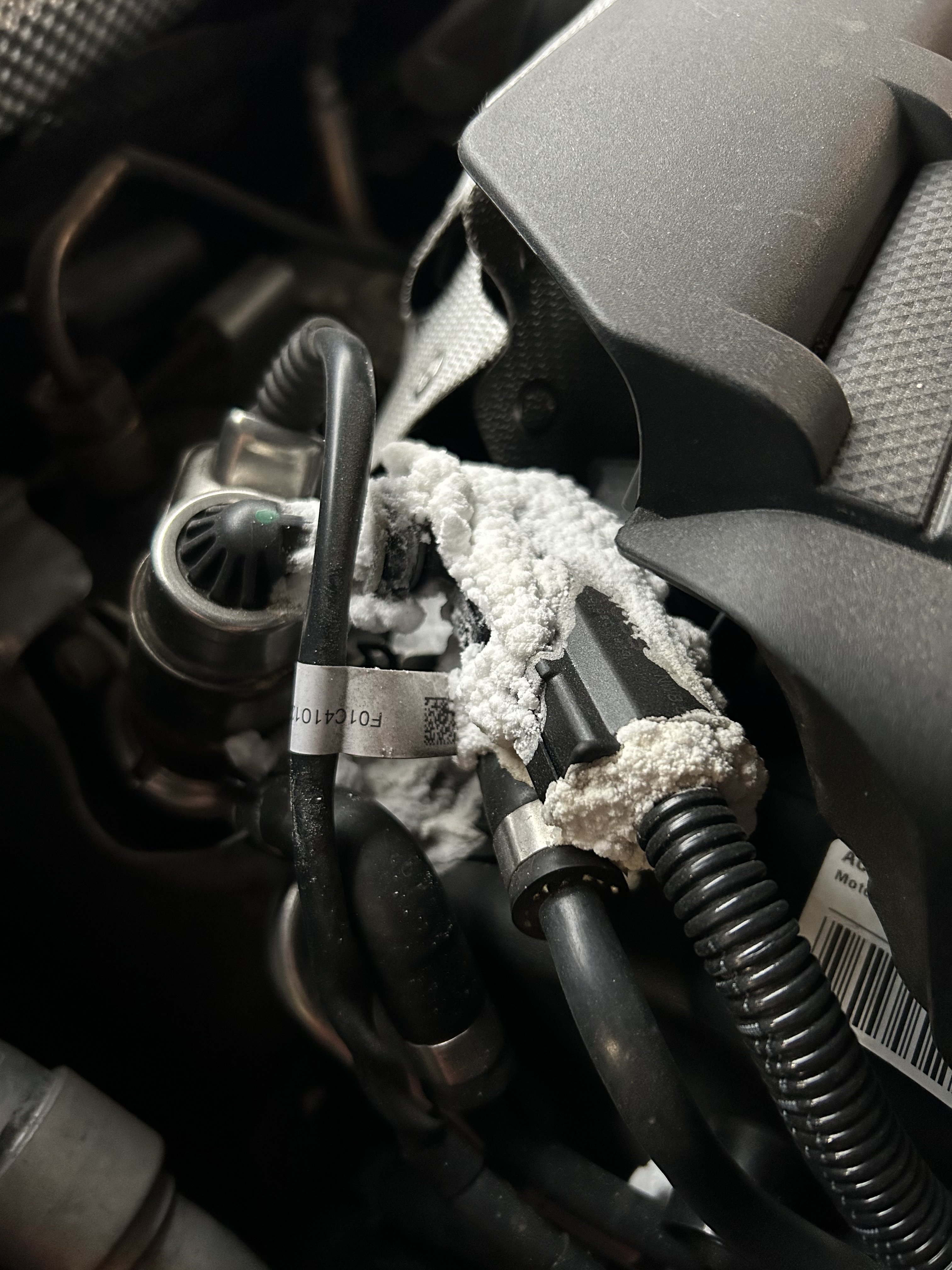

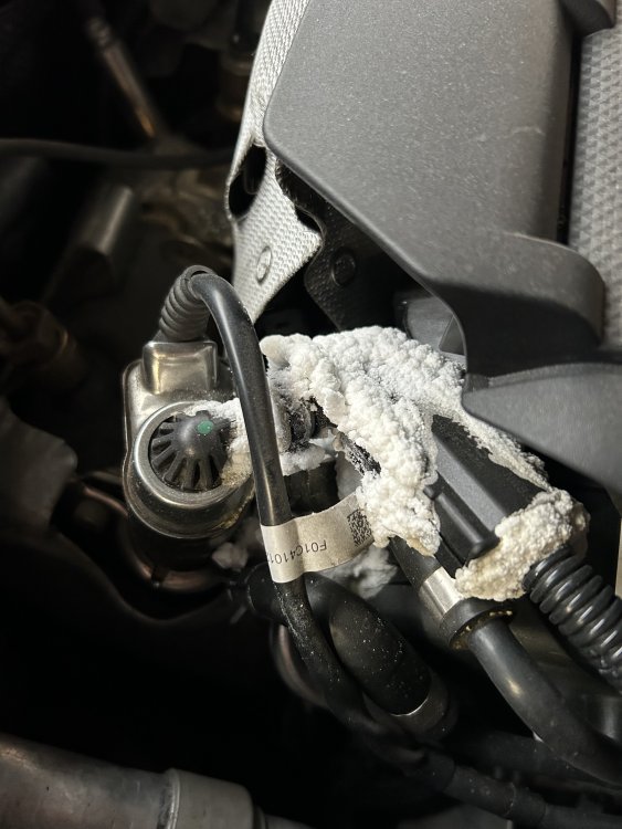

Anyone who replaced the Adblue line from the injector and back to the Adblue tank?
Yes, that solved the problem. I bought this: https://www.skoda-parts.com/spare-part/3q0131984ac-ad-blue-line-front-skoda-39383.html It took two hours and the most problematic part was at the back I wanted to avoid taking down the fuel tank so it was very tight but it worked. Tape the new one to the old one and pull from behind. Good if you are two people in certain moments.

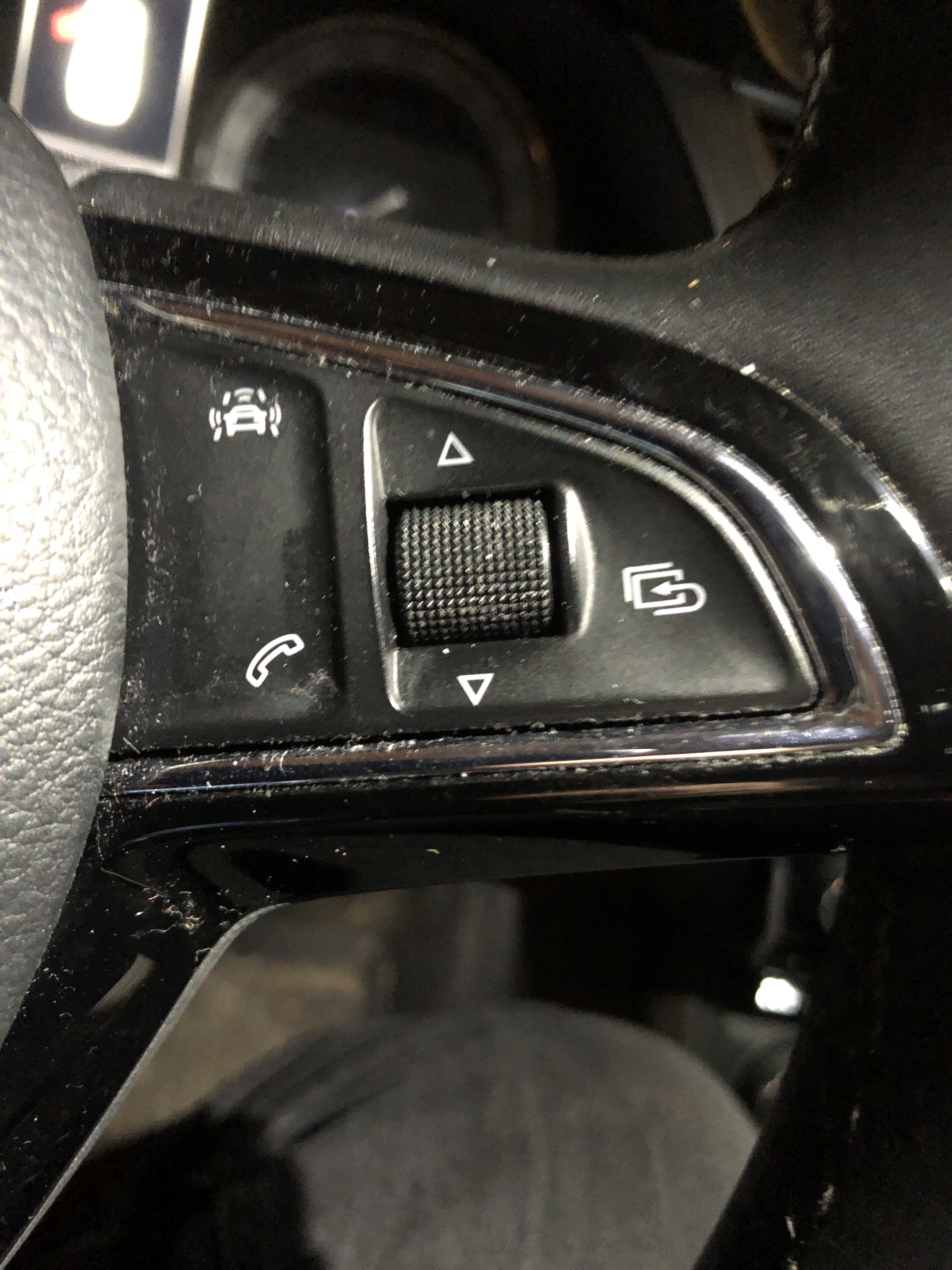

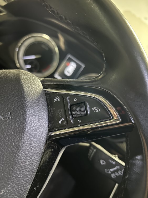

Repair or replace steering wheel buttons
Hello everybody I am experiencing problems with the right small wheel on the steering wheel. The small wheel that scrolls in the menu of the Maxidot display. Some days it works flawlessly, but some days it doesn't register at all that you are spinning the wheel. Either if anyone knows if it can be repaired or if that part needs to be replaced what is the part number for the part?
I managed to replace it yesterday, it was the feed line.
Yes I did and the leak is coming from this part that’s why I want to replace it.

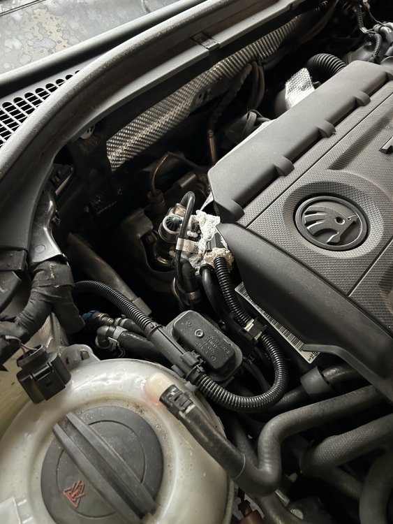

I’m trying to replace the Adblue line and can’t figure out where it’s connected in the back. Anyone here who has done this job?
Skoda Superb 3V5 with error code P20E8 Reductant Pressure Too Low
Hello everyone! Got at Skoda Superb 3V5 with the error code P20E8 looks like the attached image. What to do?
