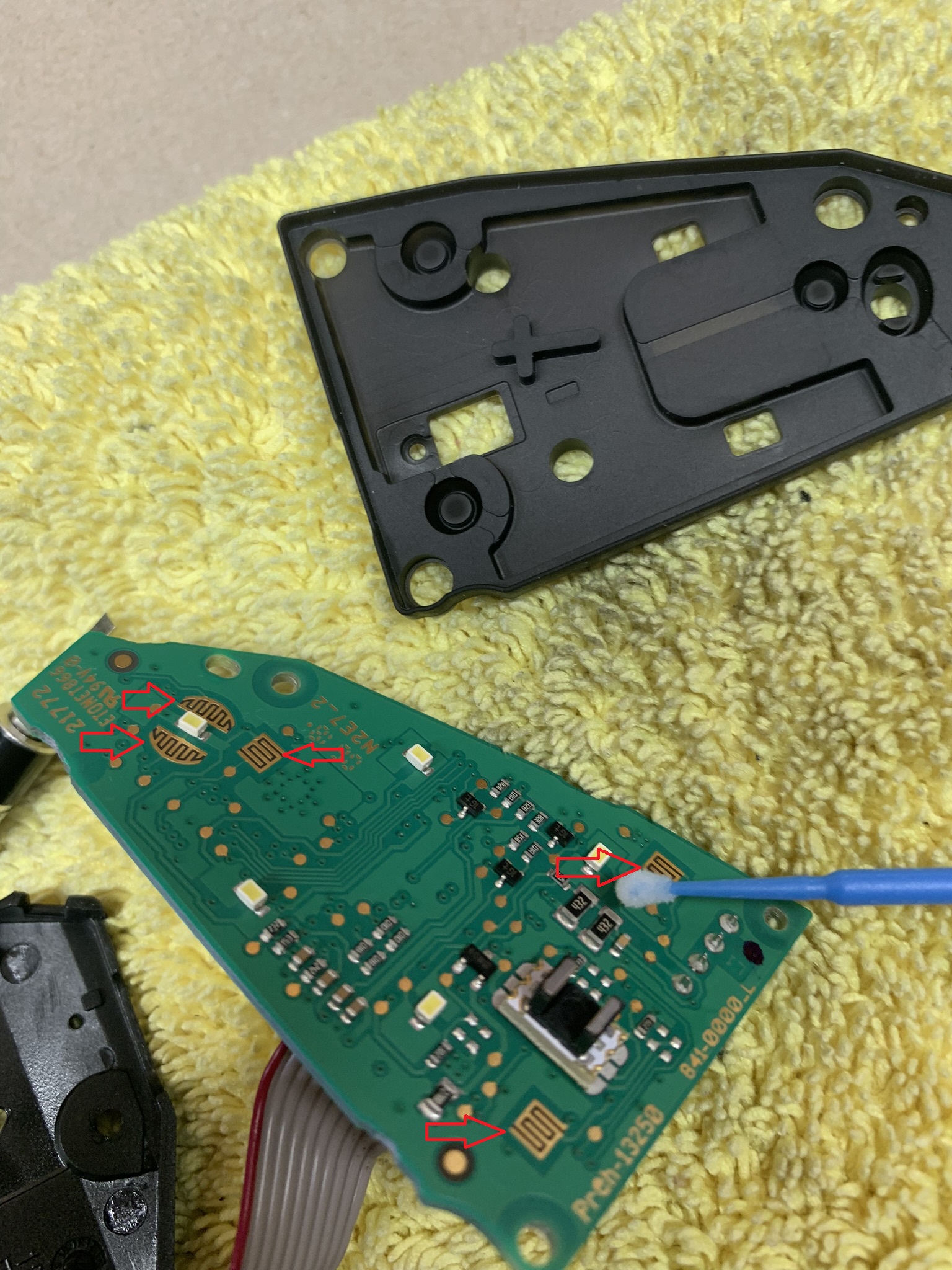

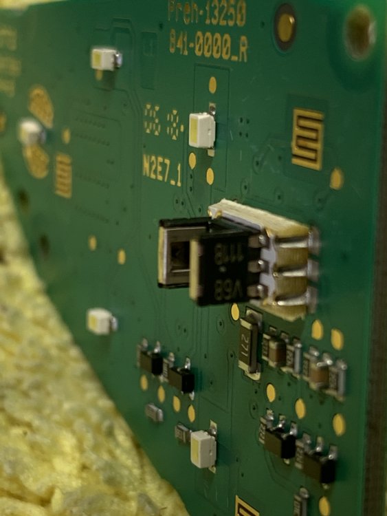

Thanks for a great guide! I have had problems with my right navigation wheel for a long time and opened the wheel up a couple of days ago and cleaned it. In my case it wasn't enough, one/some of the six solder points had come loose so I had to re-solder them so now it works again almost completely without problems, at least much better than before!

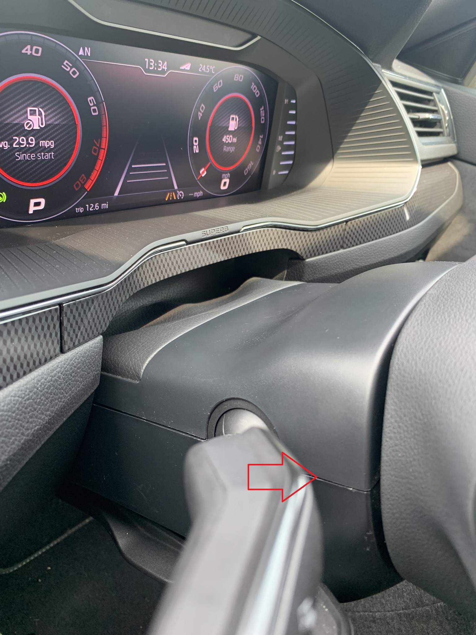

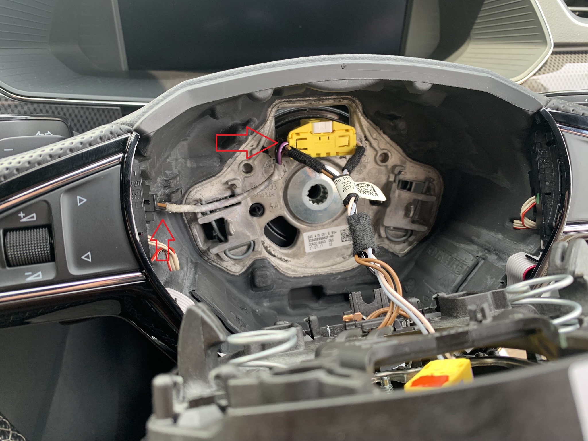

Why the need to remove the upper steering cowl?
I can release the airbag on my car without disturbing it and it looks to be still in place in your photo.
Scrub that, the photo shows the top of the steering wheel boss and not the cowl but I still cant see what its removal aids, perhaps the airbag clips are different, on mine I have to push in a short screwdriver or drift in line with the steering column axis short enough to not hit the instrument glass (plastic!)
Great guide which should save people loads of grief and money.
Edited by J.R.
Removing the upper cowl is just to give a bit more space and prevent scratching any trim. I think you are right about being able to do it without removing, but for the extra 10 seconds if seems worth it to me :)

Hi This a a great guide and gave me the confidence to tackle the barely working, right hand, rotary switch on my Yeti.

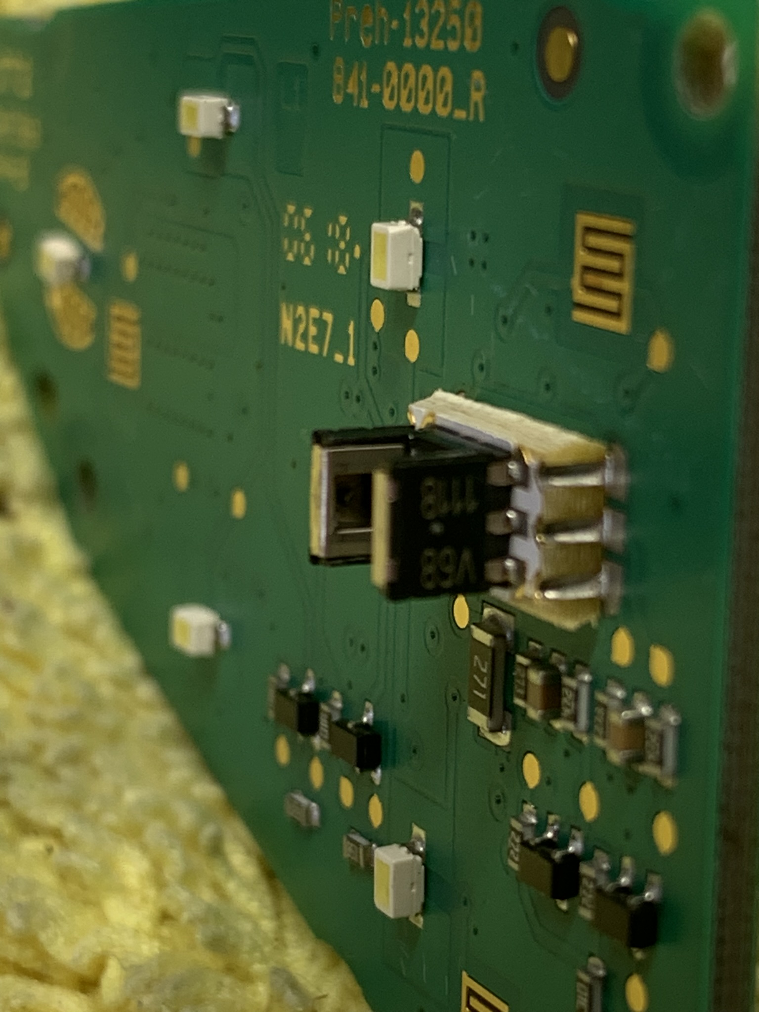

When I had dismantled the switch I found that it was spotlessly clean and thought there would be nothing needing to be cleaned. I did however clean the U shaped optical switch with IPA on a cotton bud and removed the thumb wheel to check the little windmill on the end of the thumb wheel. This interrupts the optical switch when the thumb wheel is rotated.
After re-assembly the switch has been working correctly for the last 4 weeks. I suspect that there is a component problem on the circuit board or may be a design issue, as just a wipe with a cotton bud  shouldn't have made that much difference.

crazy how that tiny sensor has such an effect on the controls!
