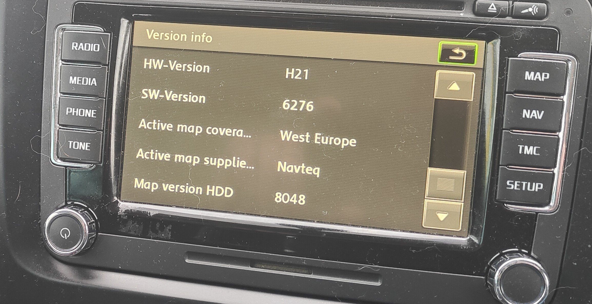

  11. I`ve attached pics of the unit and as you can see when you look at the second pic, the bluetooth audio is greyed out and press it as much as you like that doesn`t change. When paired with the car andI check the phone settings it`s set to play blutooth audio through the skoda pairing so I really am at a loss to undestand why this won`t work..
  12. Hmm, this may be the issue then as although the option is there to play bluetooth media the button is always "greyed" out?
