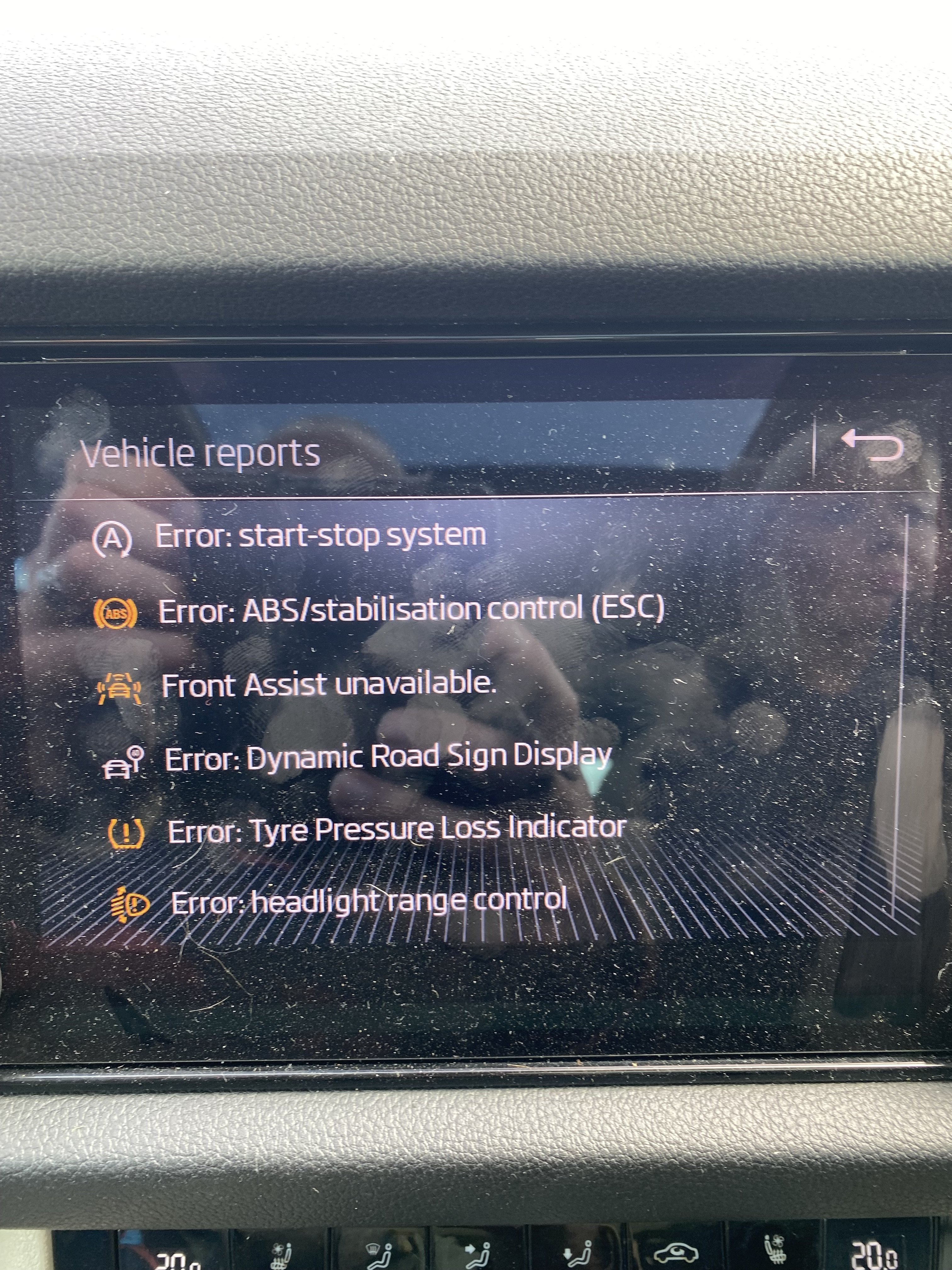

  2. I recently had issues with my braking the car and steering wheel juddering when braking - So front discs and pads replaced - still and issue Rear brakes and pads also replaced - juddering improved not as violent - but still there - but now check brake pads lights come on - then whole internal screen blank you can still hear music when phone connected but screen blank but also no more sensor warning light on dash for brakes??? Its starting to cost me a fortune...considering a new one either Mark II or nearly new Mark I L&K
  3. Hi All well it wasn’t the battery it was actually as was above the front right hand speed sensor and the wheel bearing…. The timing marks had been scrapped away so the garage replaced the timing sensor and the wheel bearing cleared all error codes and all is now fine with it.. thanks for all your support and suggestions very weird that a speed sensor can cause so many unrelated error codes… but that’s modern tech for you….
  4. Thanks guys, My battery replacement was a BOSCH 12V 70Ah 760A so a bit more strength than the original - I tested the voltage and its 12.57volts - and the terminals are tight on so I dont think its that and its had two 16 hour runs too and from france so should be okay?? I don't know how to code it - not sure what that is so I'll mention to the garage about it?? The main error seems to be ESC failure then tyre pressure - then all the other ping in, then as you start to drive more error codes come up ESC starts flashing and it affects the driving until that light stays on hard which is usually within the first few hundred yards. The power steering stops, stop start stops, the reverse camera stops loads and loads of errors come up TBH. Parking pilot, intelligent lights, etc etc loads that seem totally unrelated to ESC..??

  7. What was the issue / resolution as this has happened to me in my kodiaq today travelling back from southern France - no power steering either & lots of sensor failures
