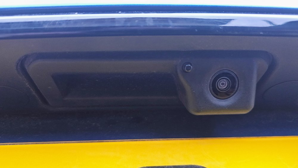

  1. Hi all, I bought my 73 plate Sportline hatchback in August last year from (the now defunct) Hayselden Skoda in Doncaster. All was ticking over ok, but I couldn’t become the ‘primary user’ of the car. As I live in Lancashire I ended up contacting my local dealer, Simpsons, and got it booked in with them for them to sort it out. After saying they wanted it for two days, they had it for a week and when I got home I realised the reversing camera was no longer working and it wasn’t saving the S-PIN either. I spoke to their service department and was expecting them to get back to me, but they never did, so I chased it up before Christmas, the earliest they could give me a courtesy car was this week (yes really!) so it went back in yesterday. I picked the car up this afternoon and they said they couldn’t solve the problem with the S-PIN and believed it was something related to to the reversing camera which they told me ‘wasn’t genuine’, and that as it was plumbed through the infotainment system it was affecting/interfering with the S-PIN. I’m not at all convinced by this explanation. They advised me to contact the dealer I bought it from. I didn’t know Hayselden had gone bust, so left Simpsons and tried to call them later. When I bought the car I was led to believe the reversing camera was a factory fit item from new. Is there any way I can confirm this, e.g. option/PR codes and if so where can I get them? I have an OBD reader, would this be able to help? I was also led to believe the car had the auxiliary heater, but I don’t seem to be able to turn that on (thought it was possible to do through the app from the phone too) and I’ve never been able to get the virtual foot pedal to work either. The car is great and drives very well, I’m just getting hacked off with the tech niggles. Any suggestions gratefully received. Thanks, Ed

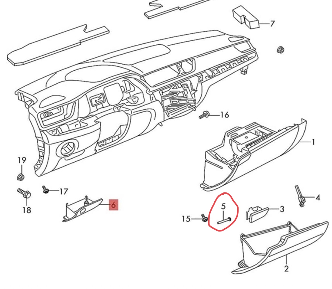

  3. This post above shows the way the pins go through the arm from the glove box lid.

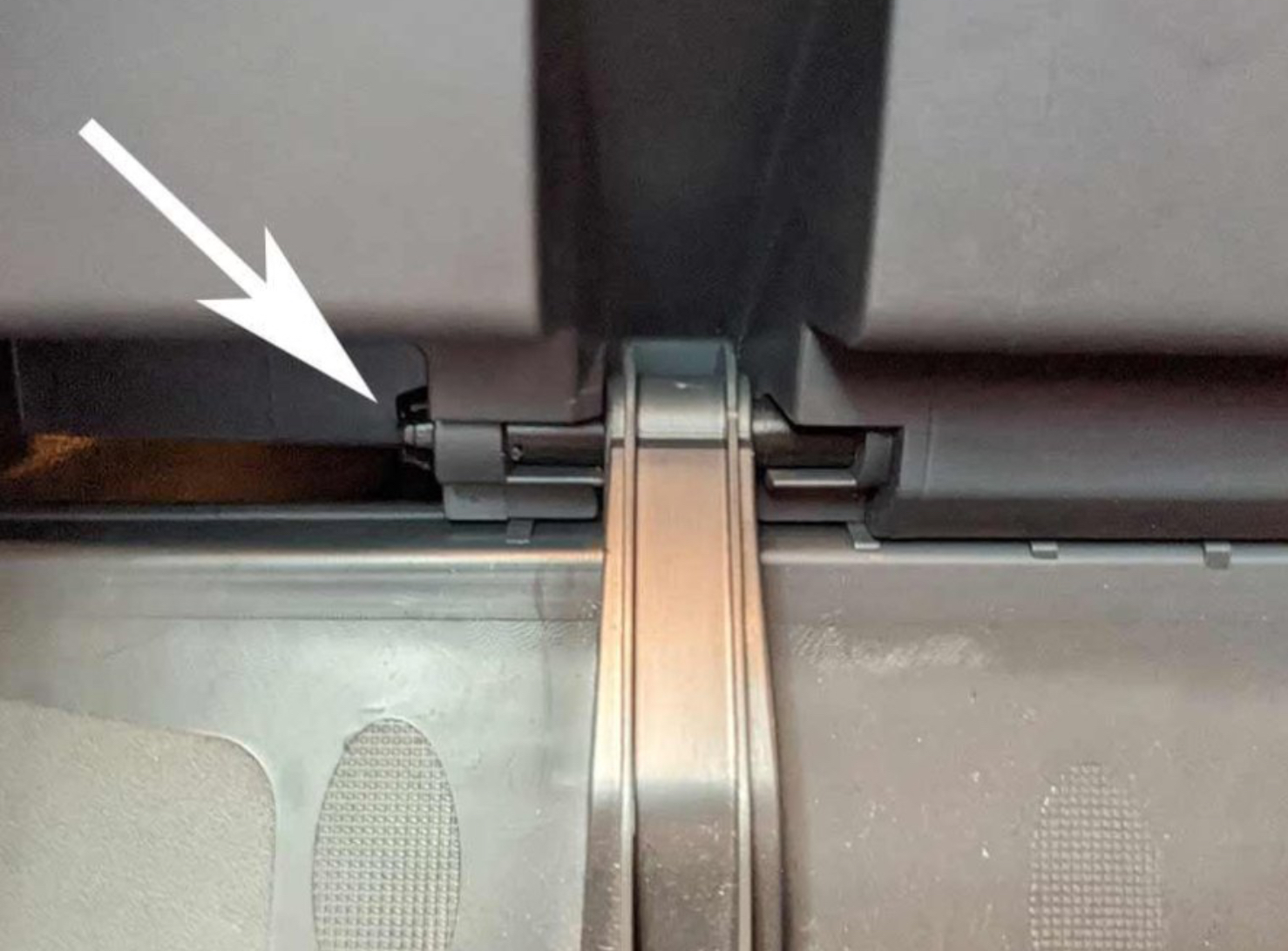

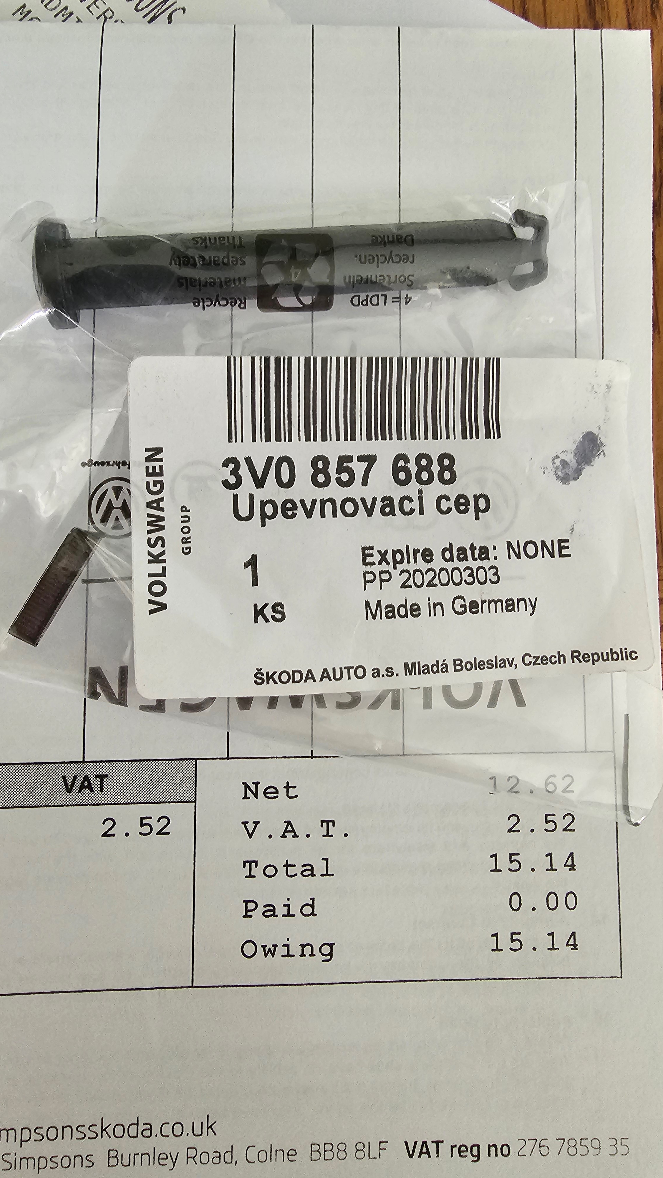

  4. @mattbuzz on my 2017 Superb it’s not possible to unclip the glove box lid in the way John says as each hinge has a hole which a plastic pin passes through, so there’s nothing to unclip. To get in to replace a missing pin I’ve just removed the 6 torx screws, basically removed the whole glove box and turned it upside down to get to the pin. …and yes that’s how much the dealers charges for a new plastic pin £15.14! Even the parts guy was a bit sheepish and embarrassed when he brought it out, asking did I really need it and did I know how much it was?
  5. I think the part I’m looking for is number 5 in the attached picture, anyone have a part number or a source other than the dealers? They want £16 for two ~50mm long plastic pins, grrrr.
  6. Sorry to resurrected this, but my glove box has just half fallen out when I've opened it and it appears the hinge pin (as arrowed in abcd's pics above) nearest the middle of the car has disappeared completely. I'm flummoxed as the only place I can see it could go would be into the passenger footwear, bit there's no sign of it at all. Any ideas where I can get a replacement without going to the dealers?
