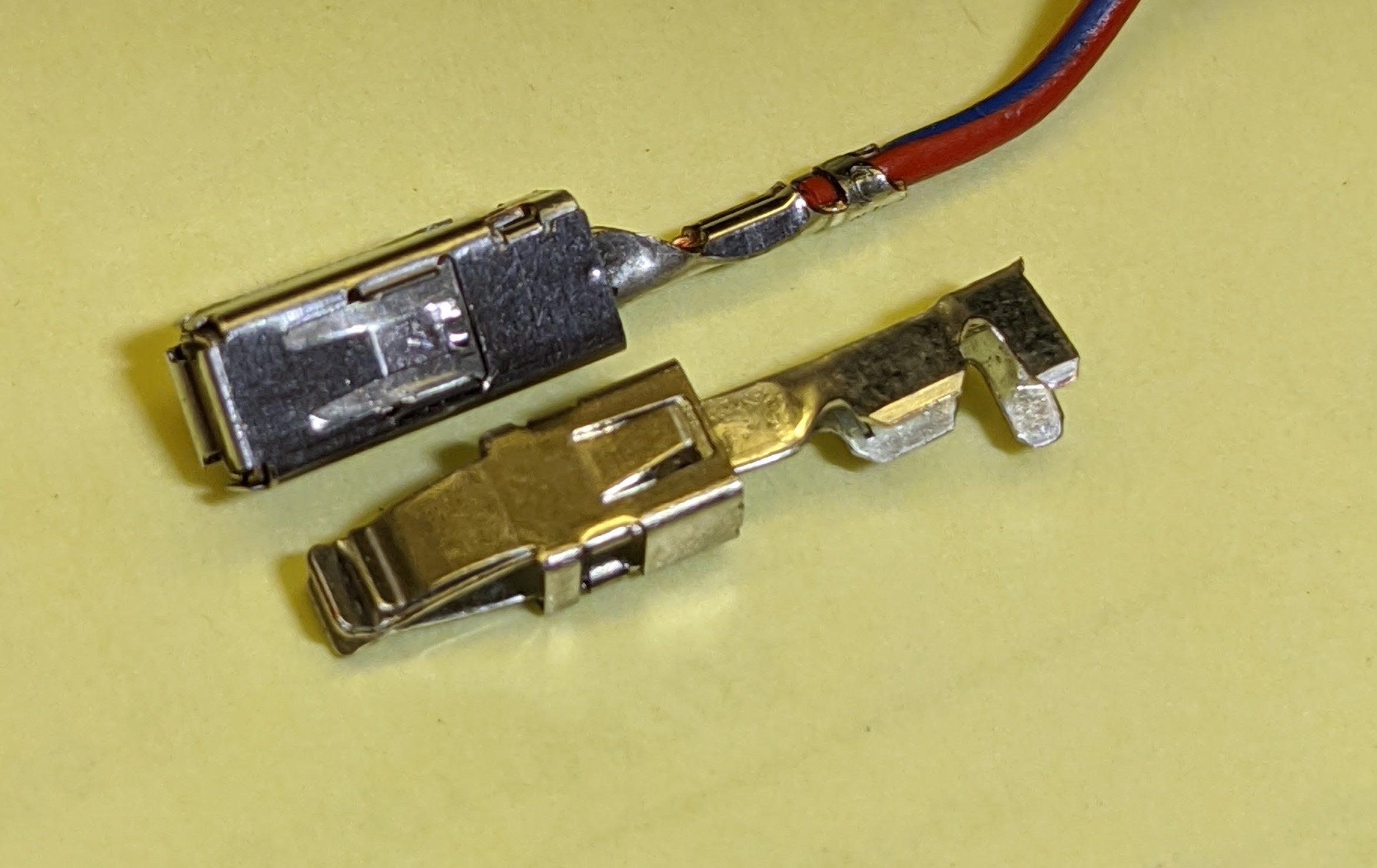

  3. In case this helps anyone else: I did this a few weeks back and spent ages buggering around trying to get the JPT fitted connectors on a couple of looms I was adding to latch into the fusebox. In the end I had to give up and rely on the secondary lock (the purple strip) to hold them in place. It'll be absolutely fine, but frustrating and a job not done 'properly'. Well today I got hold of a similar fusebox from a scrapped car and very quickly realised that JPT will never latch. MCP 2.8 connectors are needed instead! Photo attached - JPT (TE Connectivity AMP Junior Power Timer) crimp terminal at the bottom - I've used these in previous generation fuseboxes (Octavia MK2 etc) and received several ready made looms for current MQB models, to fit to my Octavia MK3, with them attached - so naturally thought they should fit! Whereas top connector, crimped to a cable, is the MCP 2.8 (TE Connectivity AMP Multiple Contact Point) connector that is actually required in fusebox Octavia 3 and other MQB models for minifuse connection. Note different latch position.

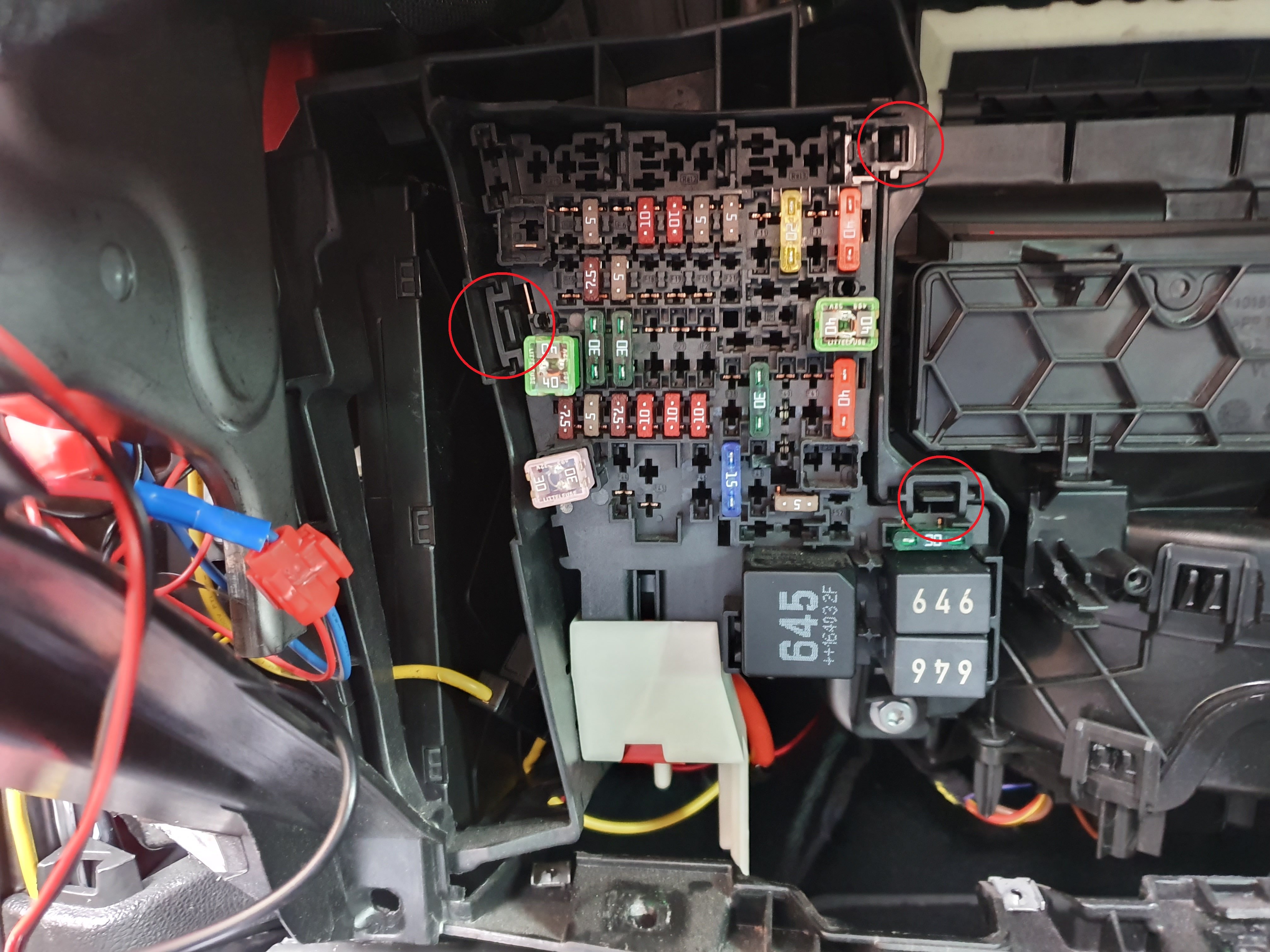

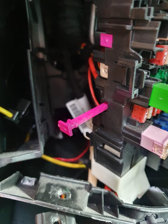

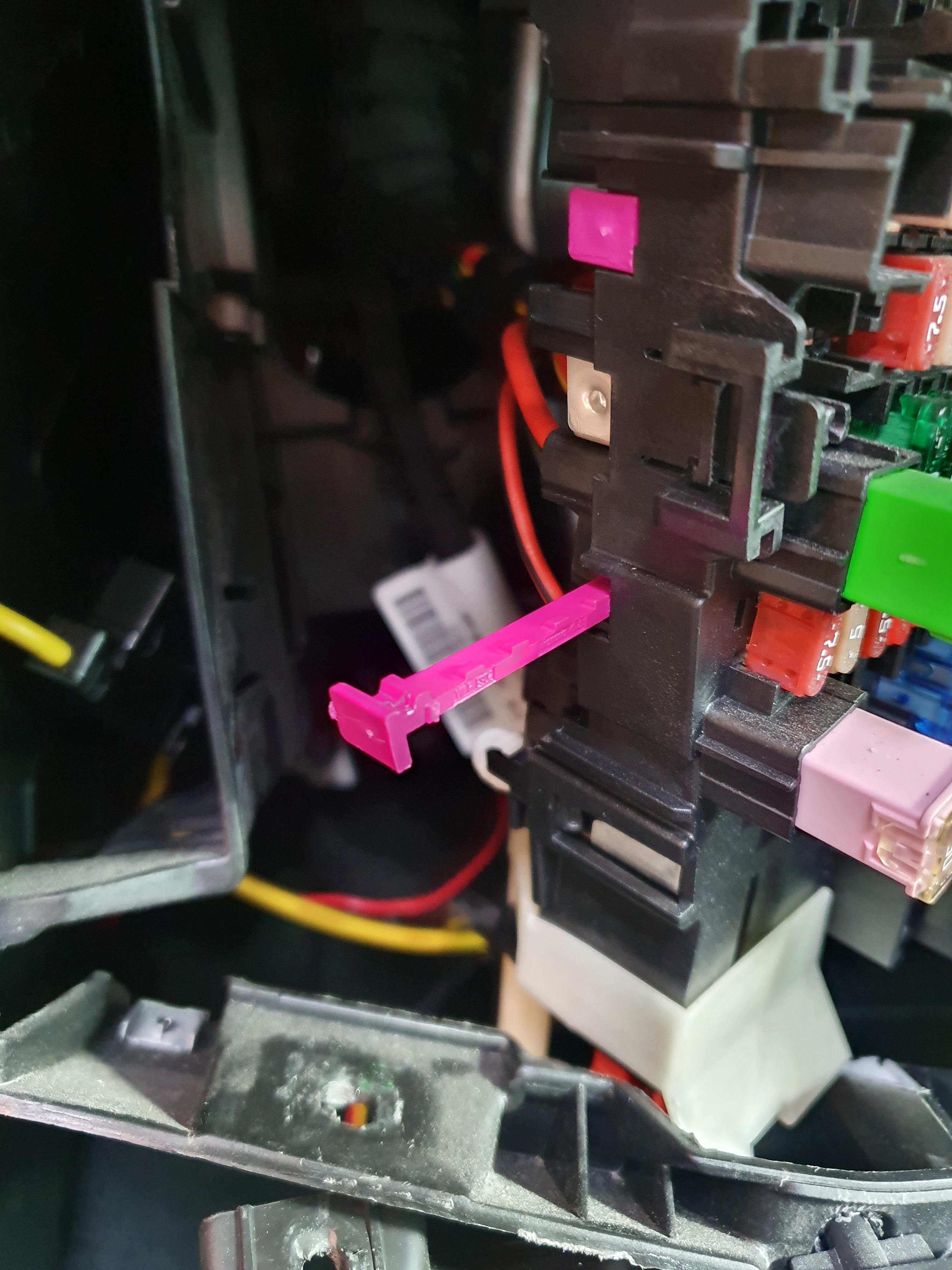

  4. Has anyone successfully added a circuit to the Octavia 3 fusebox without disassembling the whole dashboard? That is to say, pushing cables with JT/JPT connectors in to the back of the fusebox, not using the add-a-circuit fuse taps. I've wired in my OEM reverse camera recently, it's the correct loom with a JPT connector for 12V so I'd like to connect up to fuse position #18, as it should. I've had a bit of a poke around, but I couldn't see a way to get the fusebox forward enough to release the purple locking strip, Some success stories would help give me motivation to return to it another day, rather than leaving a temporary bodge in place! I've shamelessly borrowed a couple of photos to demonstrate from our Cupra friends at: https://www.seatcupra.net/forums/threads/retrofit-heated-seats-a-complete-how-to.457156/ The Octavia has a crossmember passing straight over the large white shield/connector near the bottom of the box, but this looked to be integral to large parts of the dash.
