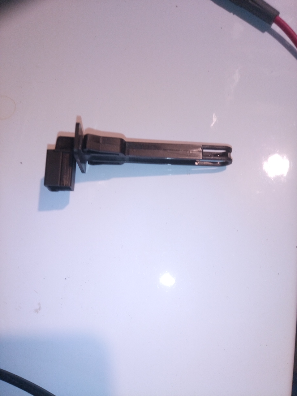

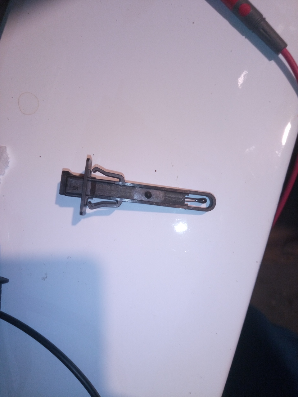

  2. I went to the holiday few days ago and it was very hot, about 35C outside and about 40 inside. I closed passengers vents but this did`t help. I suspect that evaporetor sensor is not good, anybody knows what the originals sensor worth in ohms should be? On the pics is the actual sensor.

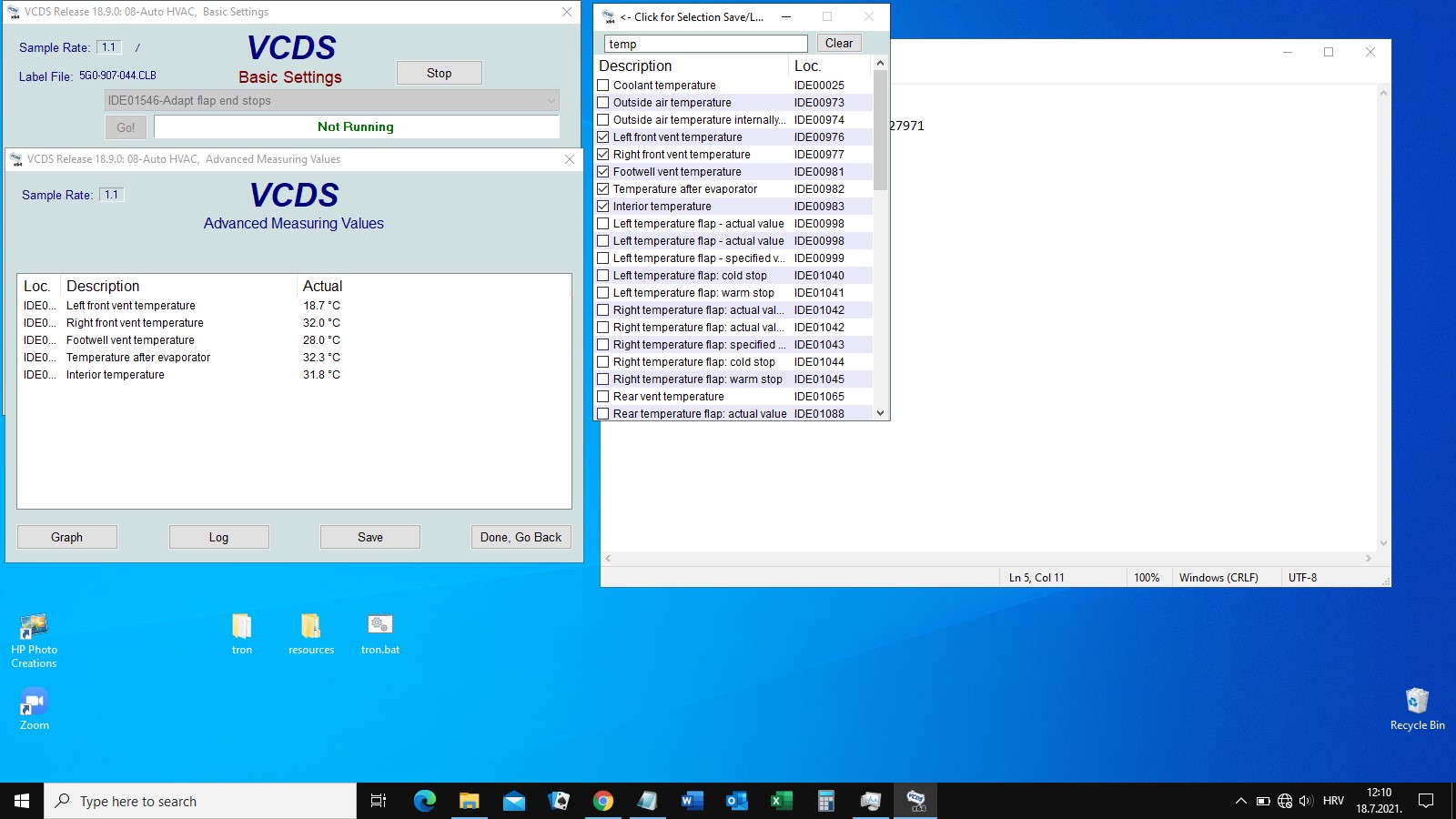

  7. I recorded this video and you can see that motor for the right flaps is working and the gears are turning, because of that I think that this flap is working, Only if they don't spin in idle and the fault is inside the evaporator housing but I think that's unlikely. Here is the link for video it is to big to post it here: https://photos.app.goo.gl/q2f1cRUi2fu7n11o8 If I will have time I will measure blocks for the right temperature flaps, I am going avay to the weekend.
  8. No help from this hread, this is when heating is not working, nothing to do with A/C.
  9. I have a problem with the cooling in the car, the left side is cooling, and the right side is not, it even heats up a bit. I was in the service because I thought there was no gas, but they told me that the air conditioning was working well and that the pressure and temperature in the pipes was good, and that the air deflector was probably not working well. I checked all the air deflection motors and they all work, I also checked all the temperature sensors, 4 pieces, took them out and tested them and they are all OK. I scanned the climate with VCDS and there are no errors. I measured the temperatures when the A / C is running and it can be seen that there is a high temperature to the right front and behind the evaporator. Does anyone know what the value of the correct sensor after the evaporator is? This is suspicious to me because the measured temperature is 32.3 ° C behind the evaporator and in the right cooling opening. Does anyone know what the problem might be?
