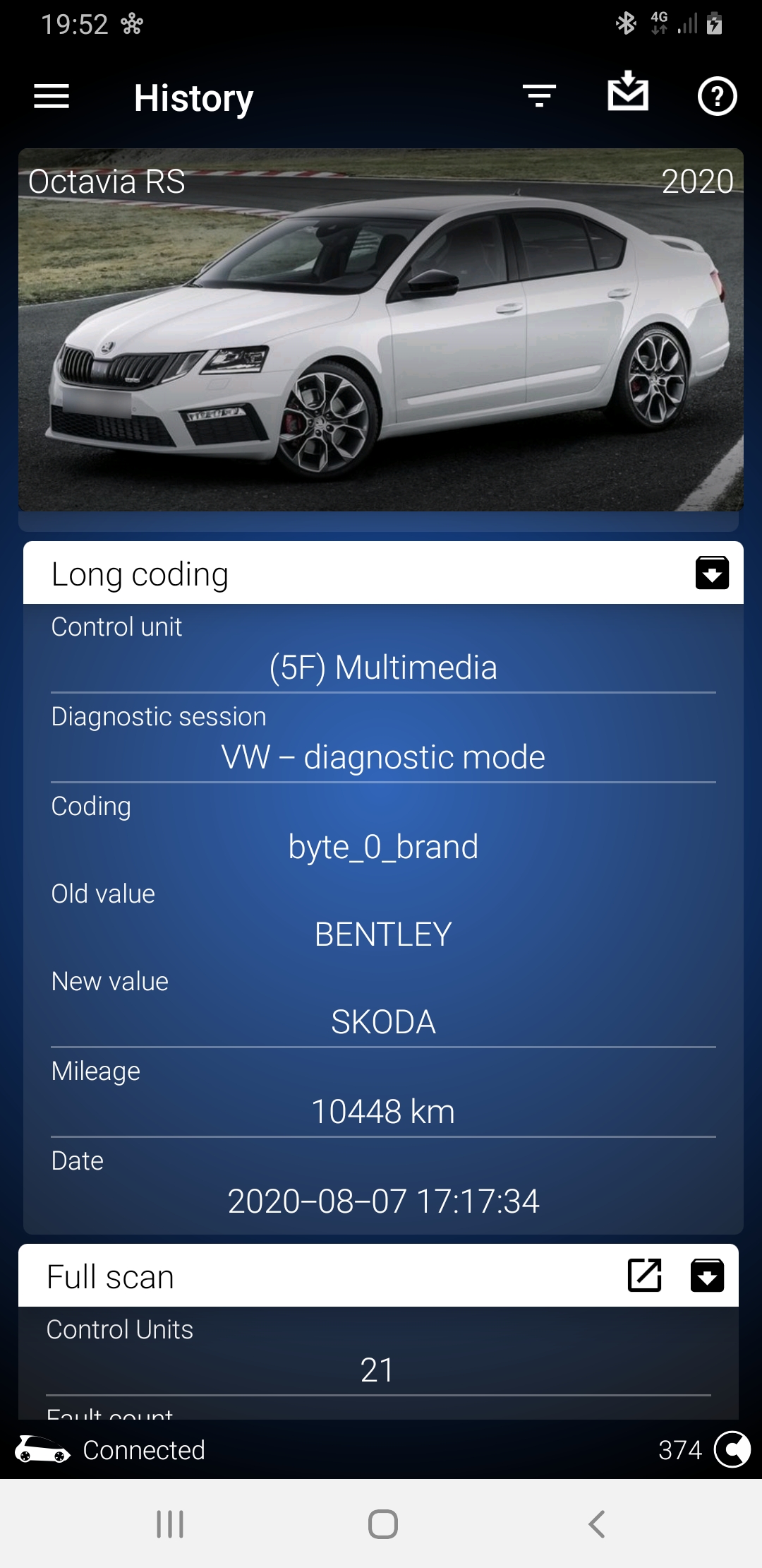

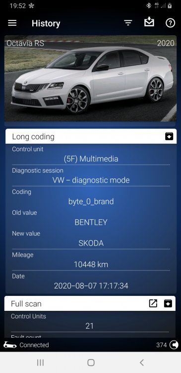

Using OBDEleven I just tried following the guide at the top and the options are not available and the calibration of synchro points isn't there, can you give me any tips on getting this to work, cheers
Control Unit 2 for transmission. Go to basic settings and that should bring you to the below page. Then simply click into the relevant setting you want.

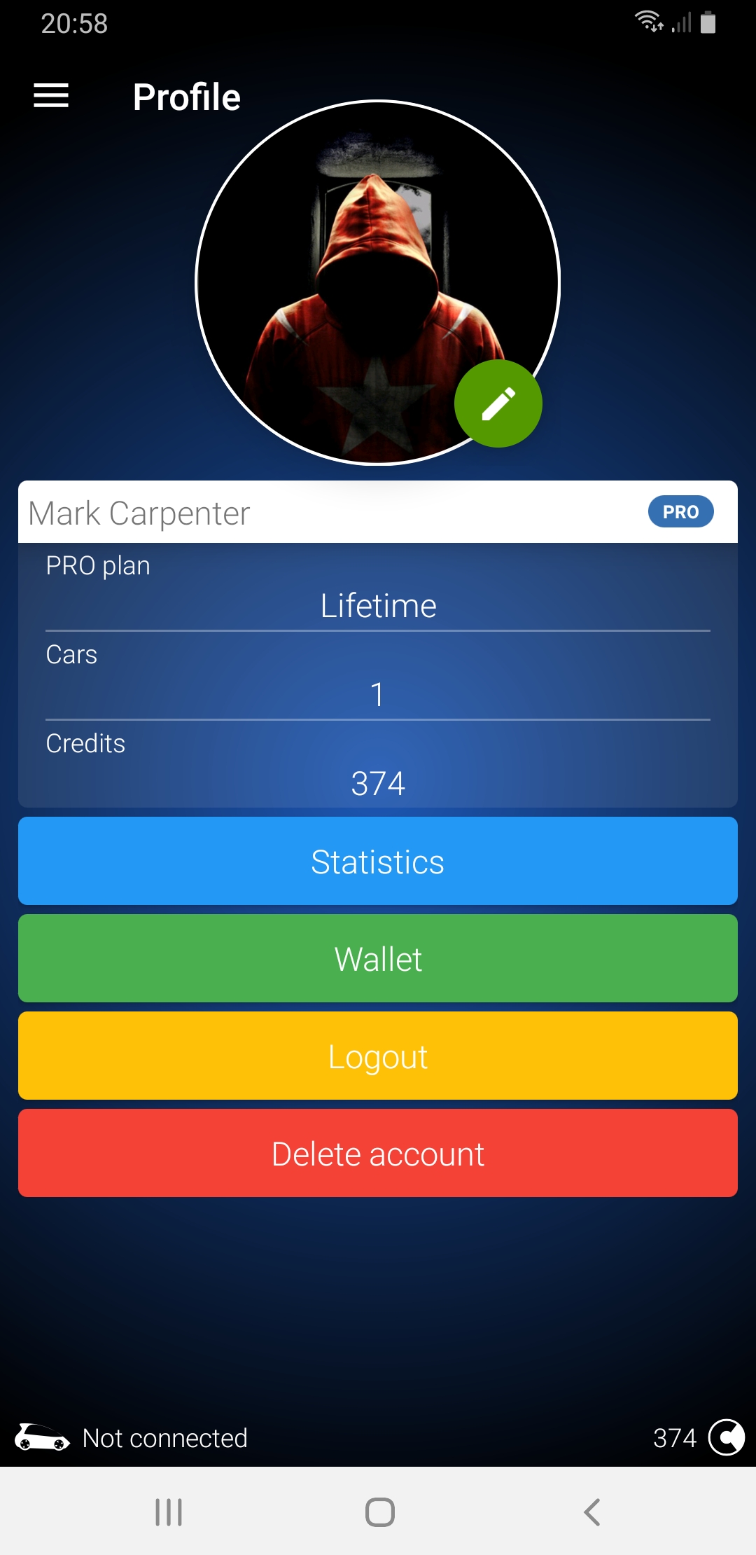

Do you have the pro version of OBDELEVEN?
Must be my gearbox I think DQ381, I do have the Pro version and I was changing displays in my Virtual Cockpit earlier ok so it is working aright but when I try and go through the gearbox options, Resetting all adpation values it tell me the function is not available.
Cheers
Edited by esoxecosse
The top image is how I received my car back from Border Skoda in Dumfries when they eventually updated my infotainment software, seemingly I have a Bentley..lol
I would imagine there will be a different routine for your gearbox. There is an app within OBDELEVEN that does it all for you so it might be easier to do do that.
