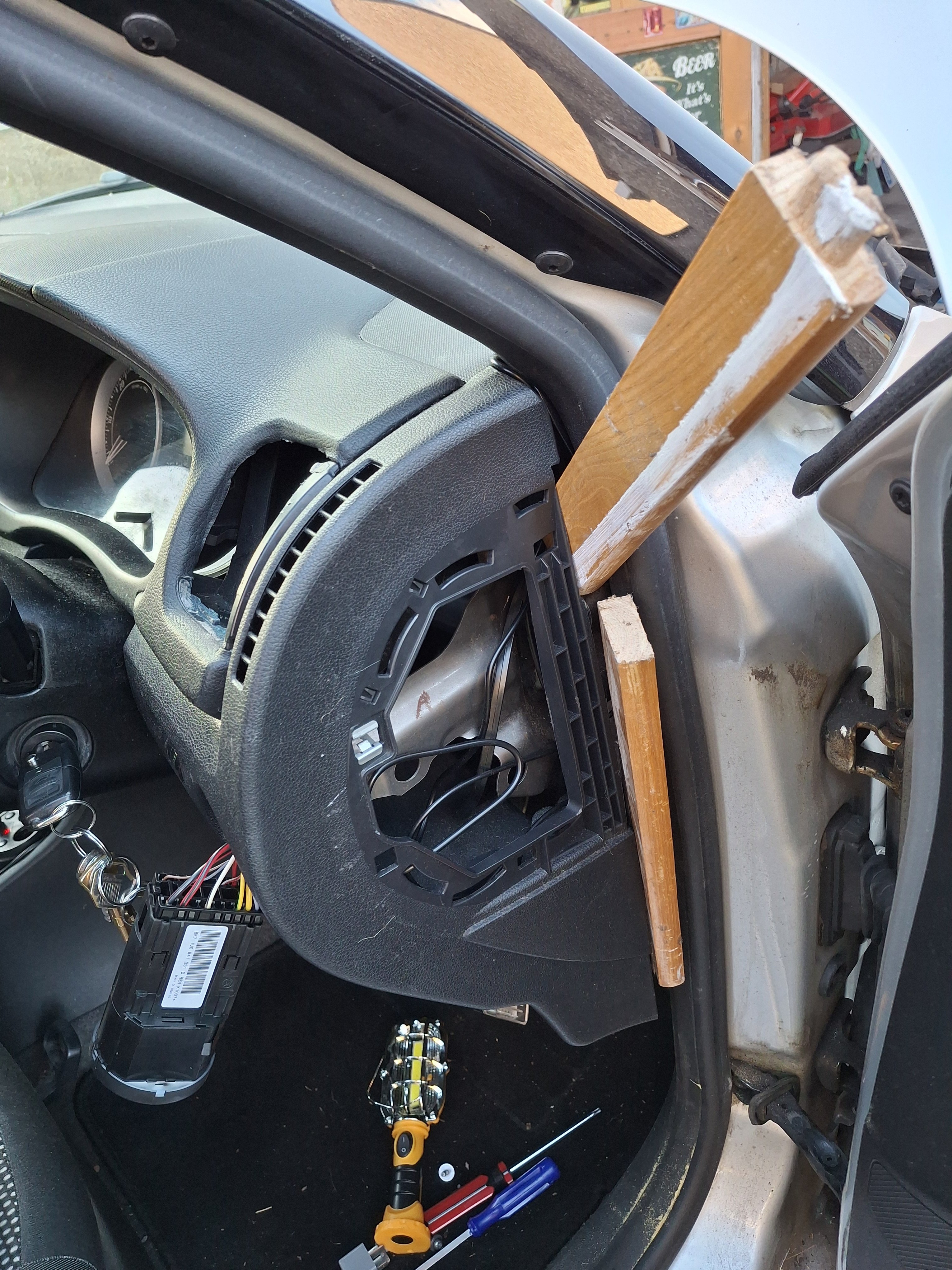

  7. Found another screw at top of and inside side cover same as previous one.With both out and screw along fue bar out was able to pull the trim and wedge with wood pieces sufficient to get hand in and waggle old relay free , and then push new one in. Not easy as took a lot of waggling to free

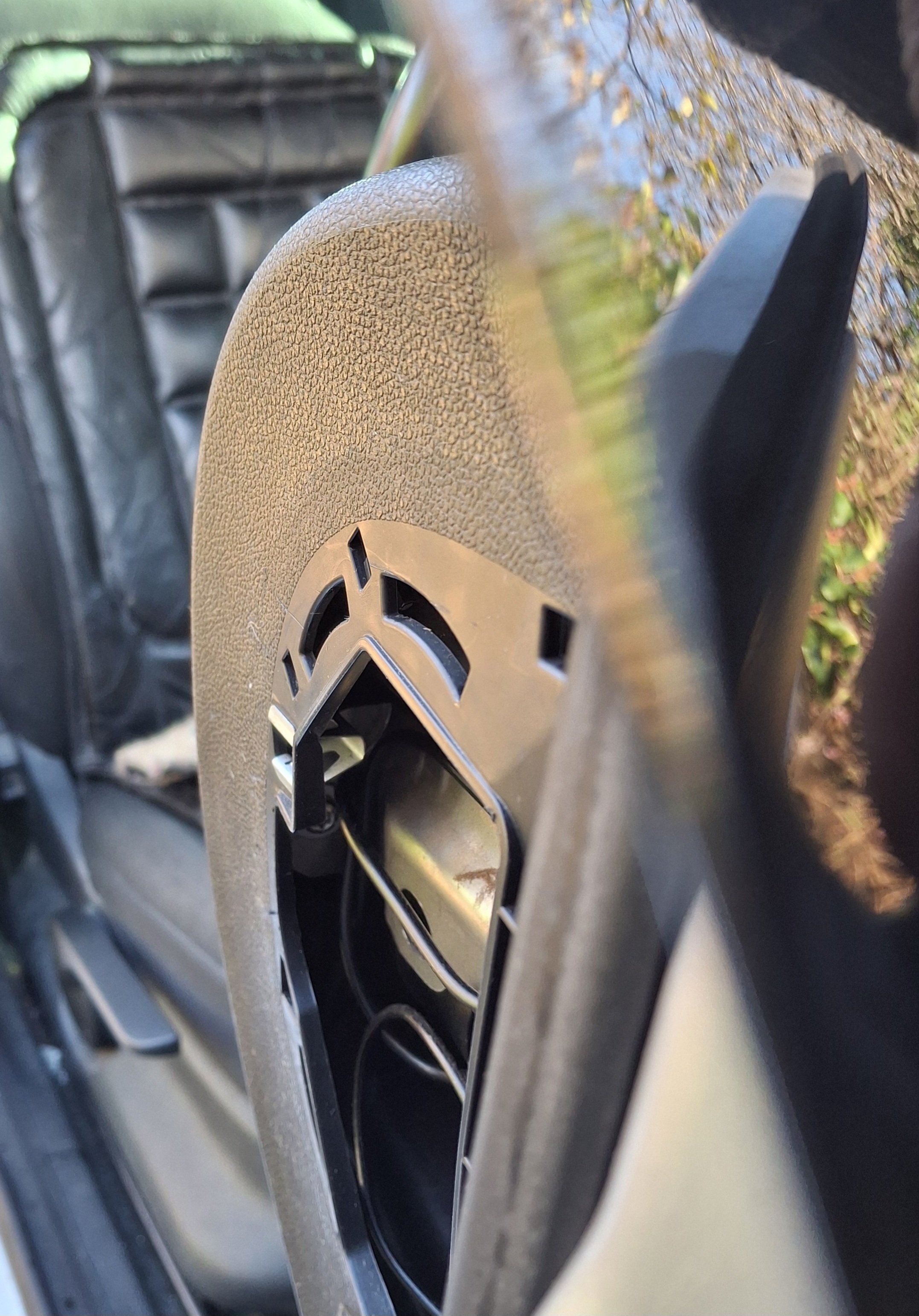

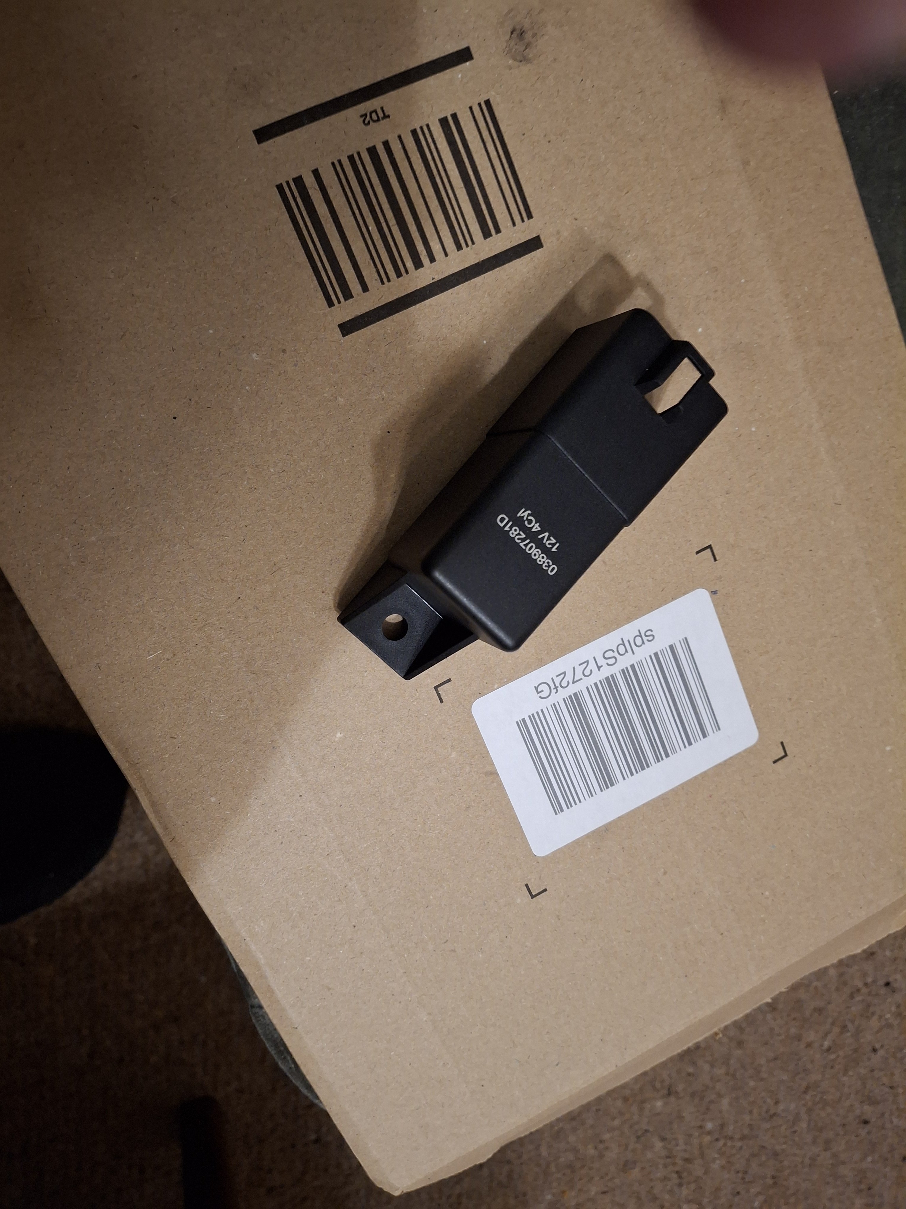

  8. Think I have found why trim will not come away , possibly due to a recessed screw inside dash side cover. Found a video detailing removal of dash on Fabia 2 and the clue was there. Also see my photo with hidden screw only just visible behind plastic lug.. So correct relay should arrive soon and hopfully be able to install .

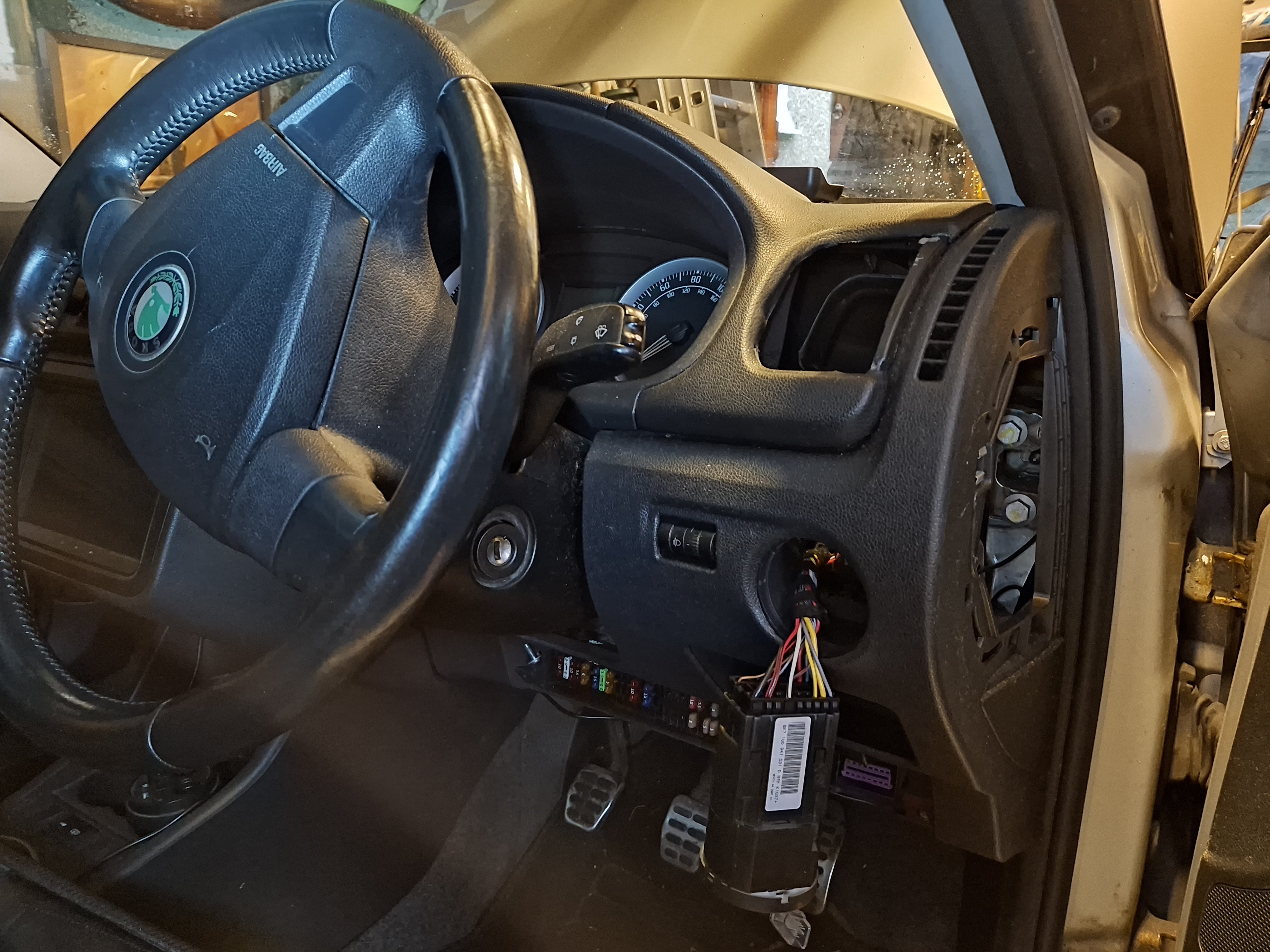

  11. Struggling to clear trim away to gain access to relay panel behind fuses. Any advice that was on the internet seems to be no longer available. Taken 3 screws out at fuse bank level but trim does not want to come away easily.Any advice would be welcome.May be Im not being brutal enough .Also replacement relay comes with bracket I hope it's the right one. Scout 2007 1.9. Thank you.
