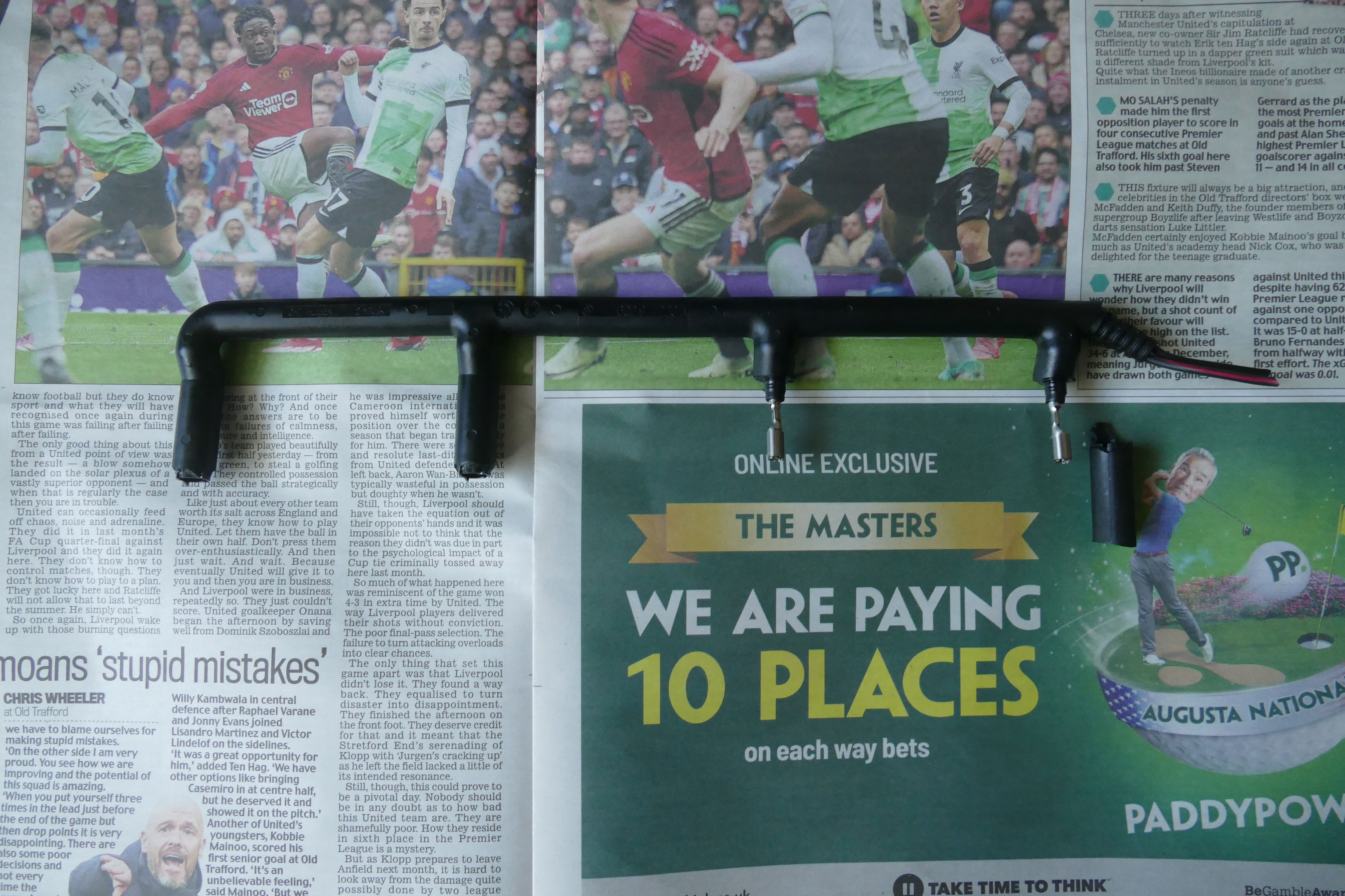

  19. I wonder if anyone has changed the glow plug rail harness on a 1.9tdi BSW engine. I found on mine whilst checking the resistance values that the plastic ends on two of the glow plugs had snapped off leaving just the copper connection exposed to the top of the glow plug . All the information tells me that the correct replacement is Glow Plug Cable Repair Set METZGER Fits SEAT Cordoba SKODA VW 00-10 6Q0971220A which comes with a long length of wire and plug attached.I don't think I need the plug as the wiring to the existing rail disappears into the main loom.So I'm wondering if I can get away with a less than half price alternative from Amazon which is the Jandra Car Glow Plug Rail Bridge Wiring Harness for- 1.9 TDI 038971782B which may fit and has no plug? My intention is to splice and solder the wires together and cover with heat shrink. A two wire affair I'm assuming one wire is for power and the other a sensor but I cannot find anything to confirm that. With some trepidation I have carefully replaced the glow plugs (88k miles) using a small low vale torque wrench set to 15nm and after two months of spraying penetration fluid on top of the glow plugs. Just need to sort out the harness.
