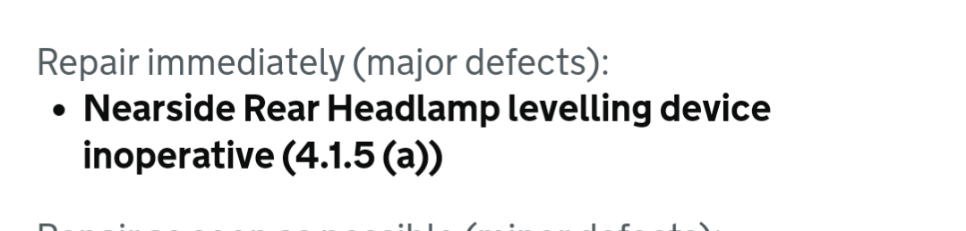

I have just failed my MOT because apparently the rear nearside tail lamp on my late MK2 Superb Laurin & Klement saloon has failed and isn't auto levelling. I am confused as I have never even heard of this as a feature. Scanning the car with Carly shows no codes relating to the lights at all. Is this a thing? Is it a common thing? I am hunting around on Google and finding absolutely nothing about self levelling rear lights. I would appreciate any advice here as my MOT is up in 5 days 😞- Additional Jack Points

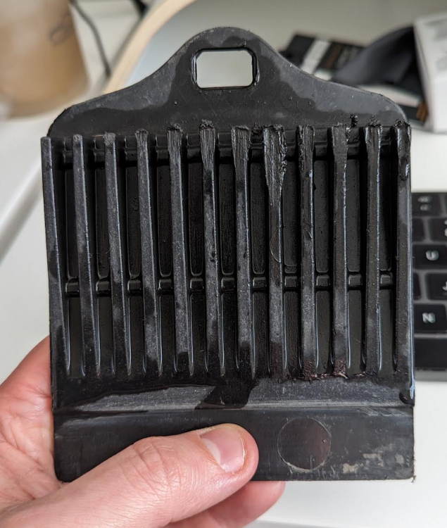

Sorry to bump an old thread but figured bumping old threads is better than making new ones on already covered subjects. Just had to get my Superb 3 in the air and was rather stunned when looking under the car at the amount of plastic covers and no obvious points for jacking the car. Obviously no complaints about the covers as I like that for underbody protection but... for this sort of thing it's frustrating! In the end I removed what I assumed was a jacking point cover (there was one in the same place either side) which had a soft rubber insert in it which you could push in (?!) and put a thick piece of cardboard in there and jacked up on that as when I tried on the sill itself the rubbery paint protection cover seemed to be deforming and trying to split which made me grimmace. The only mystery was that I realise upon putting the car back down there is something running around the edge of the jacking point which almost looks like a wire or similar and I'm worried I've damaged that... I also managed to break the jacking cover point and need to order a new one.. I attached the picture if someone could actually re-assure me that these are indeed jacking point covers and not for something more important! Just have to rant about this. Why aren't there just obvious jacking points, on cars, for doing this sort of thing?! It would make everyones life easier and make working on a car so much safer!- What have you done to your Superb III today?

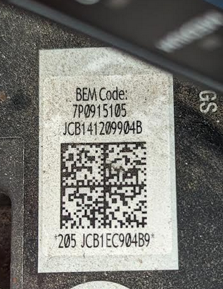

So the sticker on the car does have a BEM QR code on it so.. as you say, chances it's original though I was advised again that it was always Skoda maintained...- What have you done to your Superb III today?
