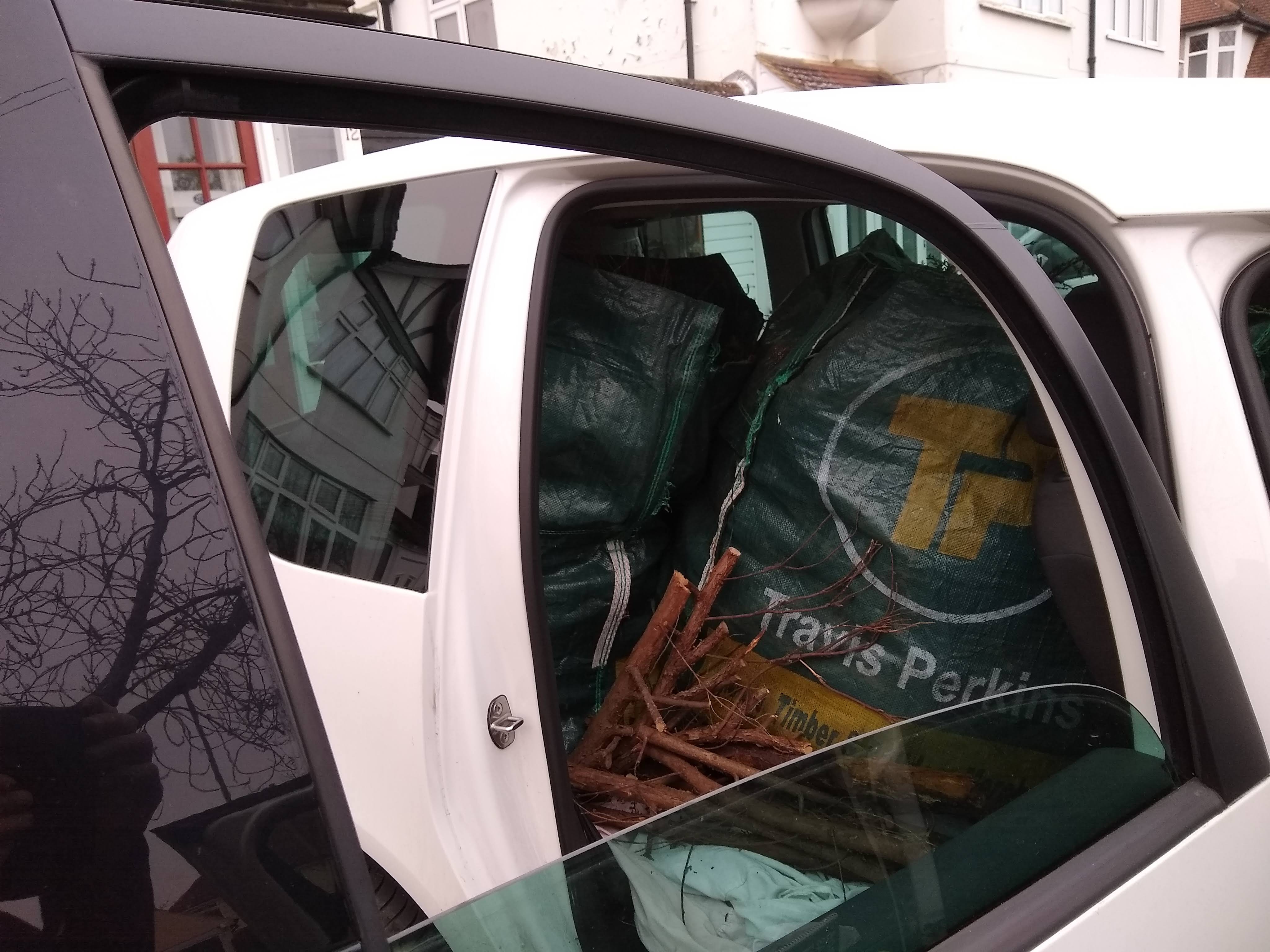

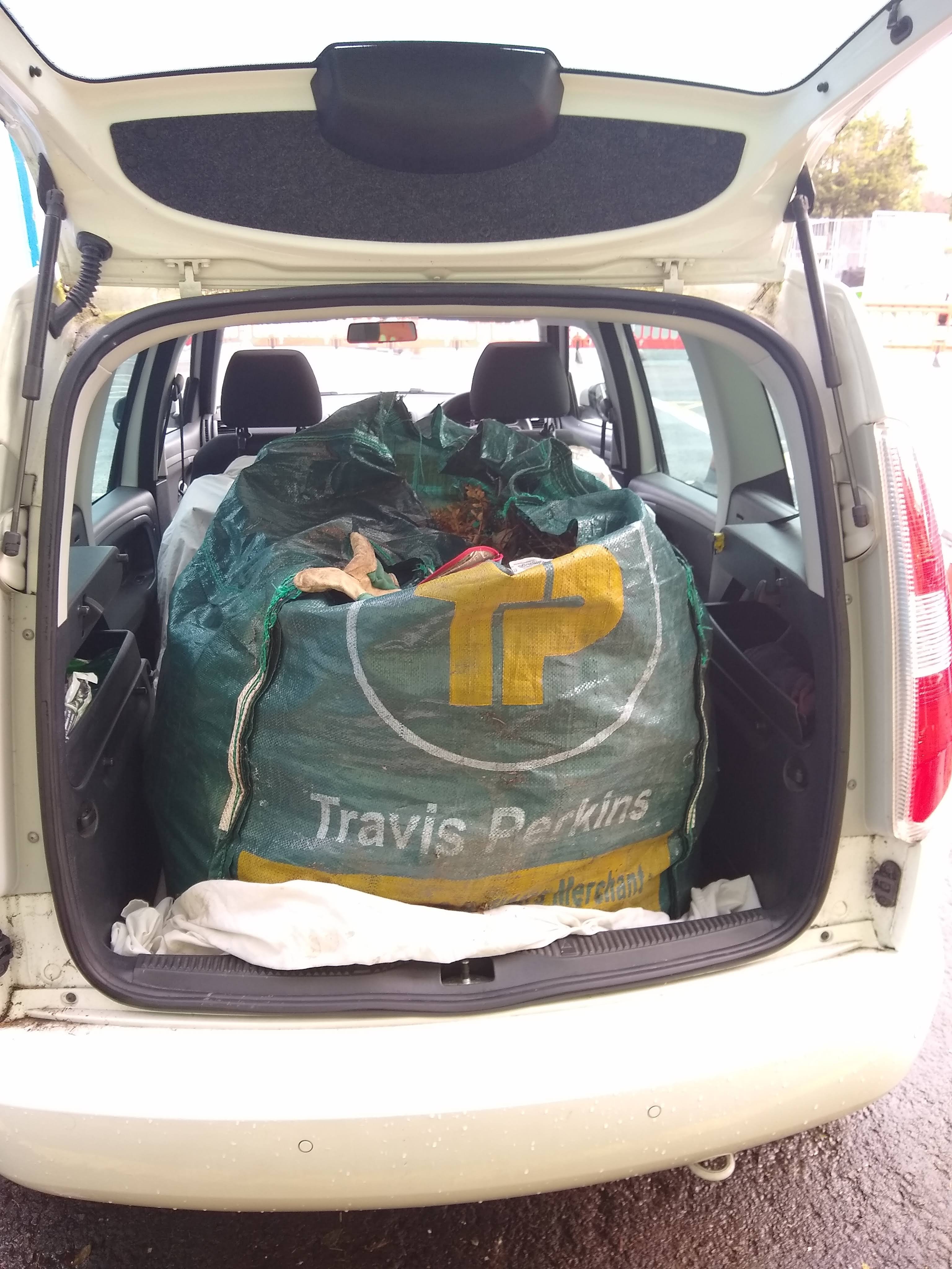

  10. Commiserations, glad to hear no serious injuries.
  11. DSG does make for a relaxing drive. I wish I could, but I can't master left foot braking; having spent 45 years driving manual cars before this first automatic I just can't educate my "clutch" foot to be gentle!
  12. Two bags with back seats taken out.
  13. If I'd taken out the seats there would almost have been room for another bag, or at least the kitchen sink.
