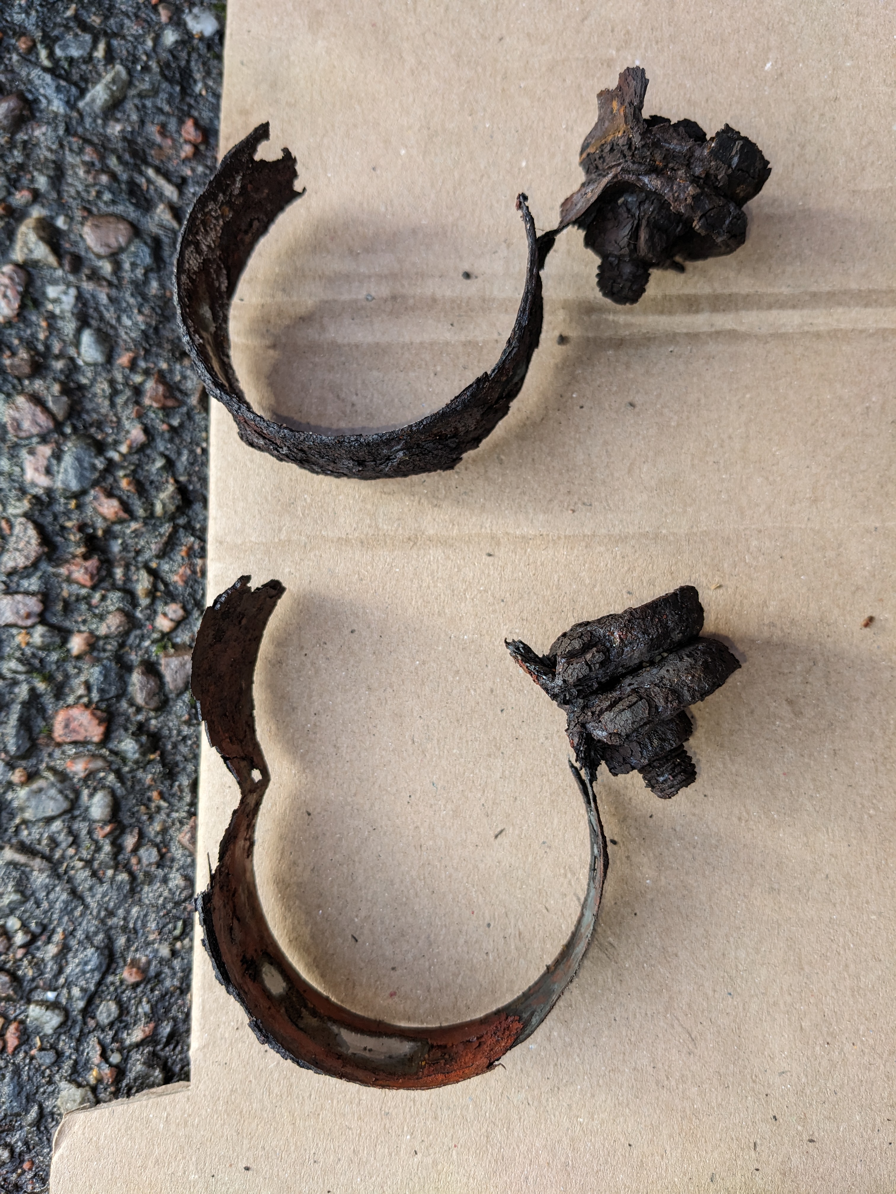

  3. Amazingly your part looks in much better nick than mine 😳, see attached. Hardly anything left of the clamps, sleeve was ok though.

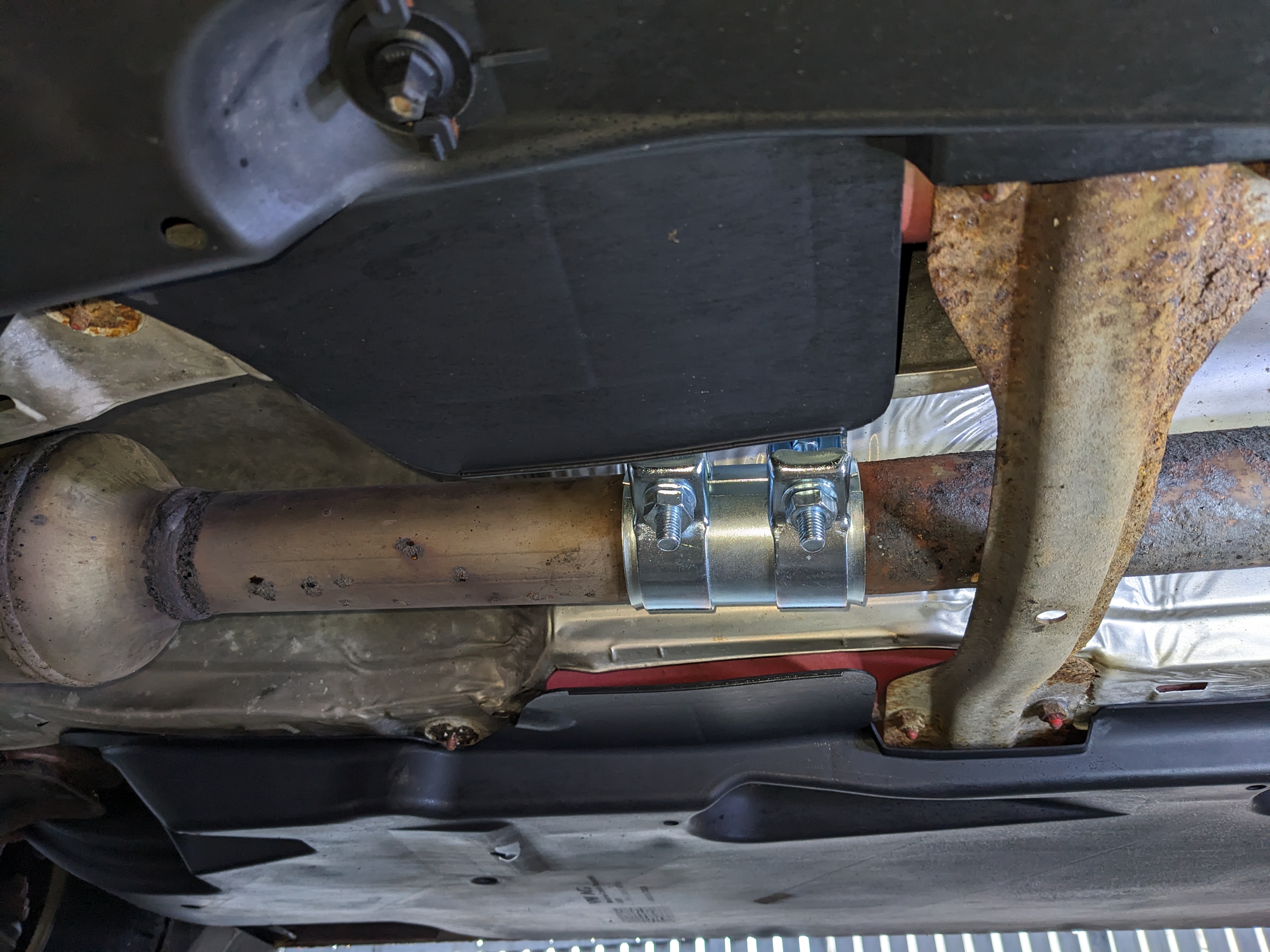

  5. Thanks, good to know re the axle stand When you say misaligned, do you mean each end of the actual exhaust or the clamps? The clamps do look slightly in different places in that picture to be fair. No I didn't use paste... seemed to be mixed advice about whether it was actually needed. Took the car out for a good run and all seems ok, but I'll check periodically for soot stains.

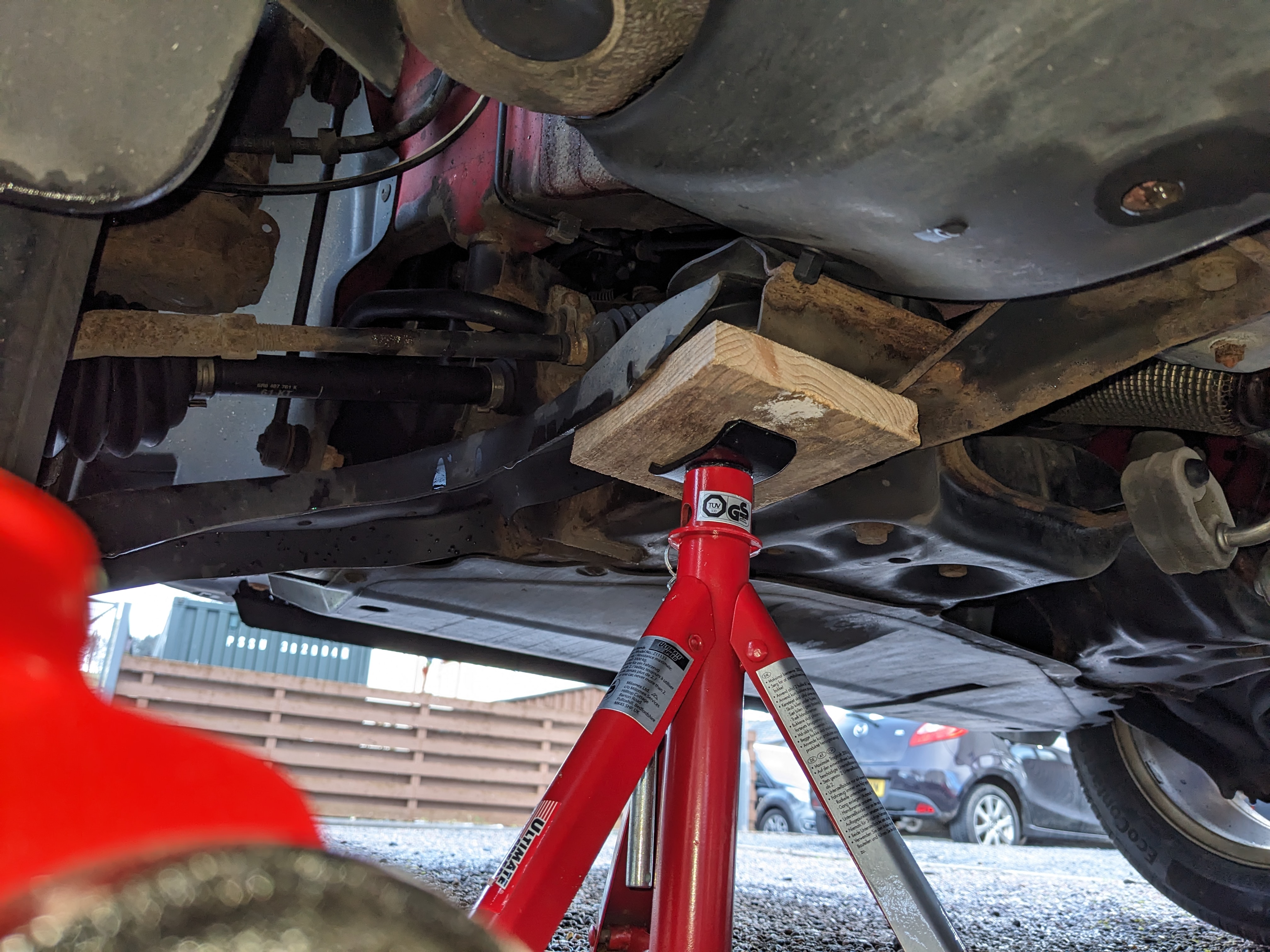

  6. Just coming back here to say thanks to everyone for their help. Job done and running like a dream again. Incredibly easy to fit the sleeve clamp, most difficult part was getting the car up on an axle stand. Ended up only needing to do that on one side as the job was doable with one hand. Incidentally the part I purchased did not have easily removable clamps, they were designed to stay in place I think. The one below specifically from onlinecarparts (autodoc). https://www.onlinecarparts.co.uk/fa1-2968115.html I may be at risk of a slagging, but was this a suitable place for the axle stand (wishbone I think?). Struggled to get the car lifted up very high with the trolley jack I borrowed so the axle stand is on its bottom setting. Many thanks Mike

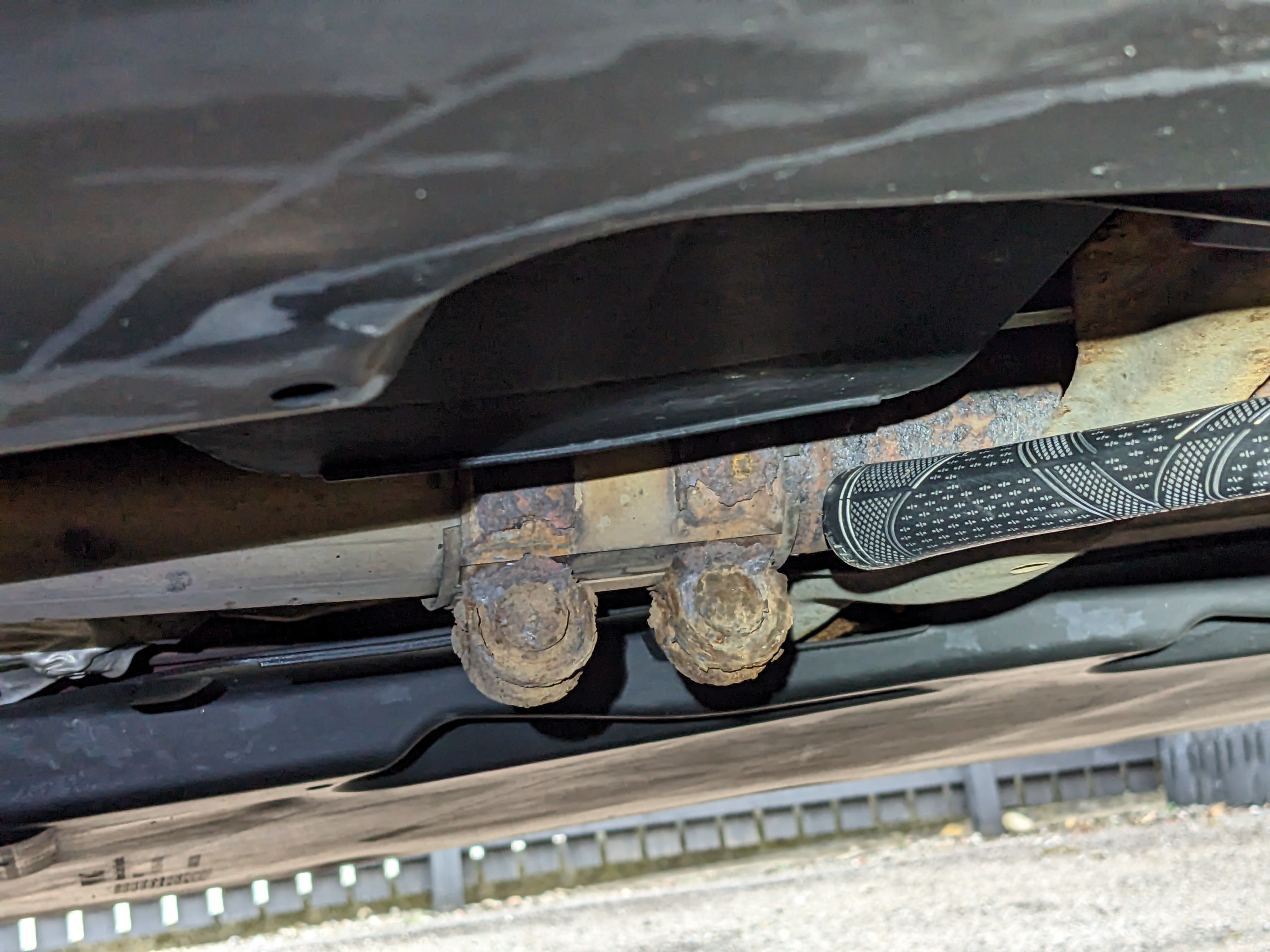

  10. Hi all, My 2016 Fabia 1.2tsi hatchback has developed the old 'boy racer' noises under acceleration and on jacking her up to check I've noticed the central exhaust area is very loose (see pic and video). So rusted! There is an effect on performance as well which I guess is understandable due to loss of pressure. Does anybody know if this is likely to just be the mounting that needs to be replaced or if these parts come as a group and have to be replaced completely? Part numbers for this would be really helpful as well if anyone has access to that 😍. I don't want to get a shock when I go to the garage with it, only recently replaced the timing belt (@ 69k mls) which cost £580 ! Love this wee car! Thanks in advance all, Mike PXL_20231028_153033628~2.mp4
