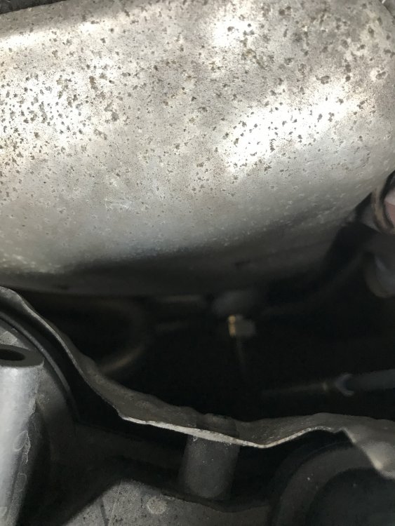

  3. Thanks for your help guys. Found it - almost, but not quite, inaccessible - on the front of the DPF (?) behind the oil filler tube. Changed it and no more flashing coil! Engine fault light still on, but I guess that will go away in time. If not I'll get the VCDS out again!
  4. EGT Sensor #3 has failed on my 2010 Octavia II VRS Diesel. VCDS reports "Exhaust Gas Temperature Sensor; B1 S3 P242A - 000 - Malfunction" and I get the flashing coil and "Engine fault- Workshop". Despite lots of searching (including BriSkoda) I'm having trouble finding out where it is. Can someone help, please?
