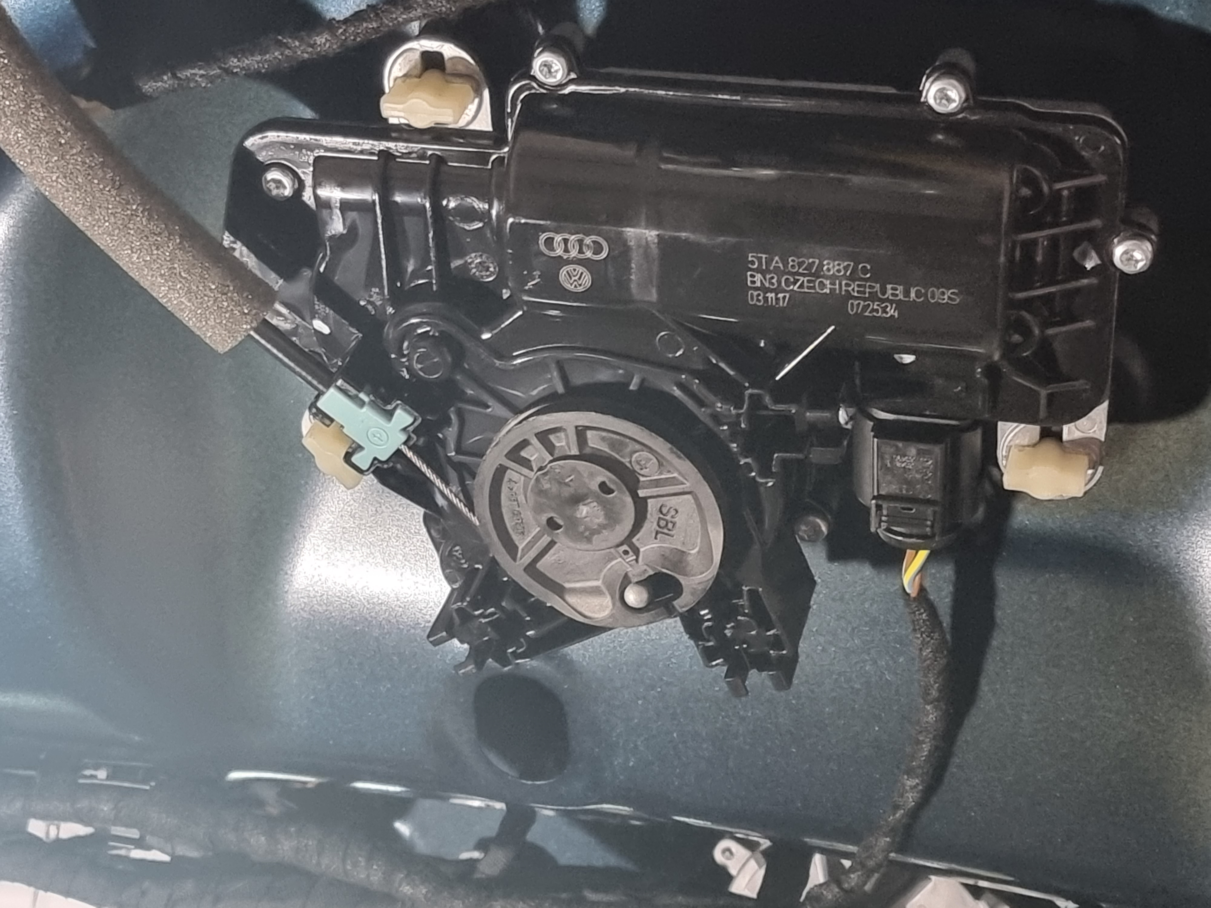

  2. quick update, friend from VW garage confirmed this is plug-and-play part, so all good. Just need to put it all back together, make sure all works correctly ... just in time for Xmas!
  3. Replaced the servo motor, in temp position now, it works! Tailgate closes, and soft-close locks the tailgate, then the light on the dash (boot open) disappears . Before I put everything back together in final places, is there anything in VCDS coding that needs to be done to this module? Checked all (I think) the service manuals and this servo motor is not shown anywhere, so no idea if there is any coding/basic setting to be done? Would be good to know so I don't end up breaking the new (£132) part shortly.

  6. New lock installed, unfortunately it works just the same way as the old one. The tailgate goes down but it is not locking properly - it sits 2-3mm above it's final position and dashboard still shows open tailgate... So it looks like it's the servo motor (attached) for the soft close that needs replacing... Is there anything I should know before replacing that? Seems easy enough, 4 plastic fittings holding it, one electrical plug and the cable that needs to be adjusted.... Again, not sure if there is anything to do with the VCDS?
