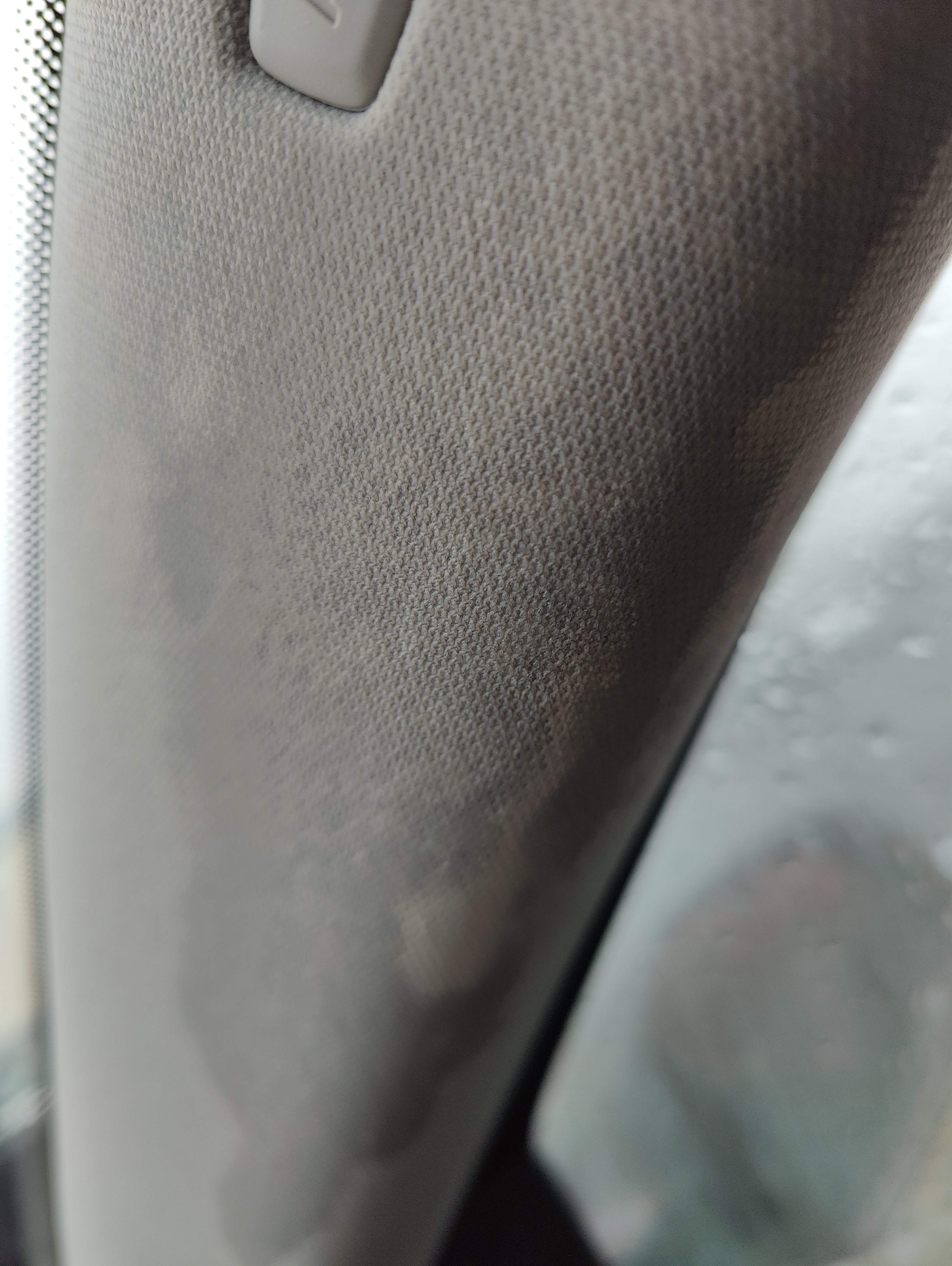

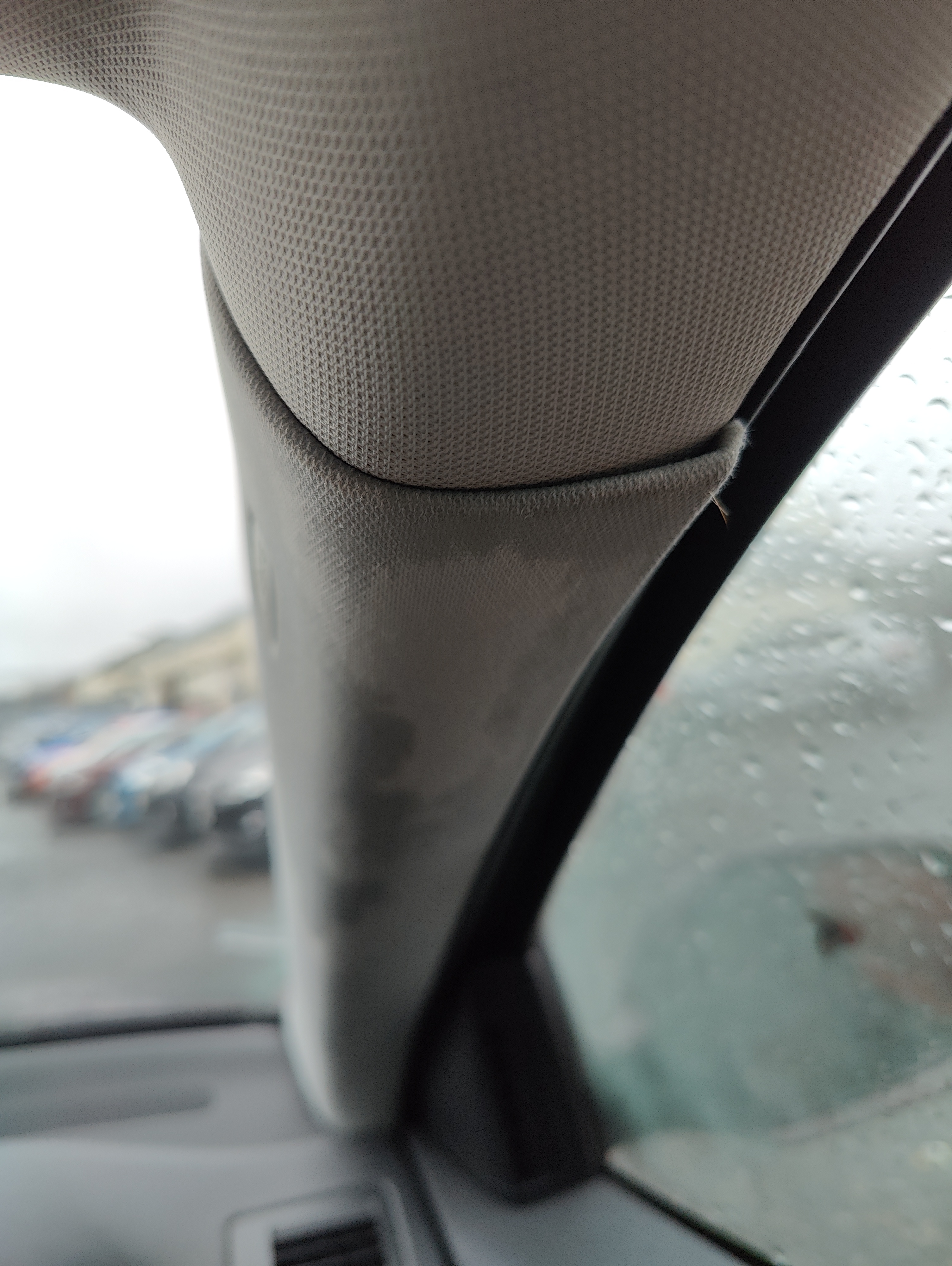

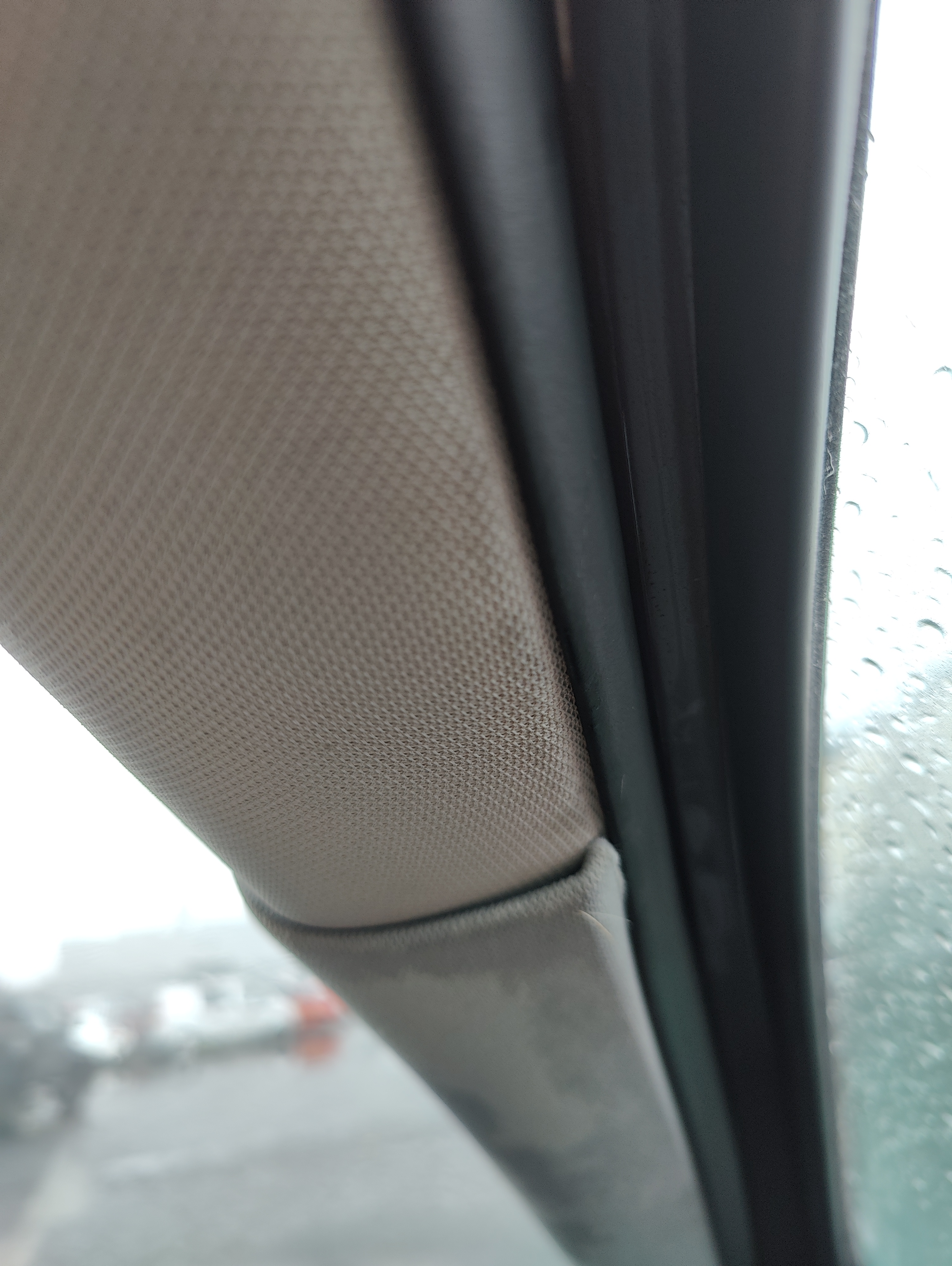

  2. I have sealed around the top corner of the screen and inside a pillar to screen, however I am also seeing water on the main door aperture seal and a water trail over the aperture seal drivers side front, so think I have got the screen sealed but possible door seal leaj as well.
  3. No sunroof as has thought of drain tubes, but no sunroof
  4. Hi my drivers footwell is wet and I had made sure the plenum chamber was clear and also there was no debris behind the wheel arch liner, however after rain today I noticed the a pillar trim was wet and was wondering if most likely the door aperture seal or the top door seal. Any advice would be appreciated Cheers

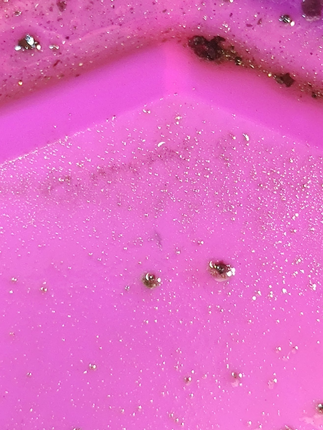

  6. carried out the 2nd oil change of the haldex and not had a lock up since but still early.
  7. Thanks for your advice, as there was some swarf in the haldex when we changed the oil & filter we are going to do another oil change & see what comes out. then review it from there,
