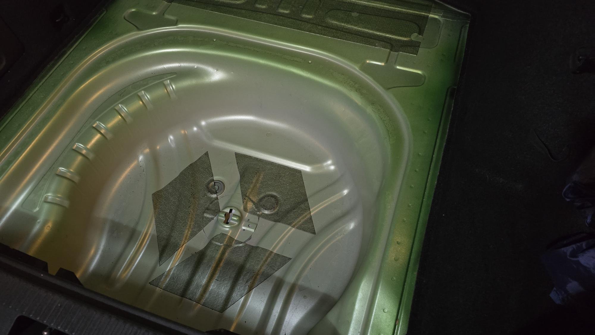

  1. Thanks for your reply @Carlston. Only just spotted this. That wheel is more expensive than the one I link to but your site does have the kit cheaper.

  3. Hi all, I recently bought a 2019 Octavia VRS estate and am looking to replace the 'puncture repair kit' with a spare wheel and associated insert/tools. Would the following combination be correct/sensible? https://www.theskodashop.co.uk/products/skoda-octavia-mark-3-vrs-spare-wheel-tool-kit-5e0093860a https://www.thewheelshop.co.uk/product/skoda-octavia-vrs-iii-l-k-18-space-saver-spare-wheel/ It looks like the Skoda insert and tools set includes the bit to actually clamp the wheel down? With the current insert removed my boot floor looks like this, and I'm hoping his can attach OK in the centre? Thanks.
