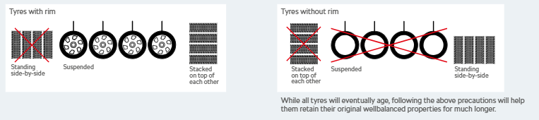

  1. Hi, As I was doing some research to order a winter wheels set for the new Octavia, I came across this info in the Skoda Winter wheels brochure Until now, I have always stored my spare wheels set vertically in a rack like the below one and I never thought anything wrong of it: After doing more research, I understand the concern about upright storage would be to create a flat spot and degrade the tyres. Since the tyre rack does not have a flat surface at its bottom but two bars, would it still damage the tyres? Curious to hear your opinion on this. Thanks

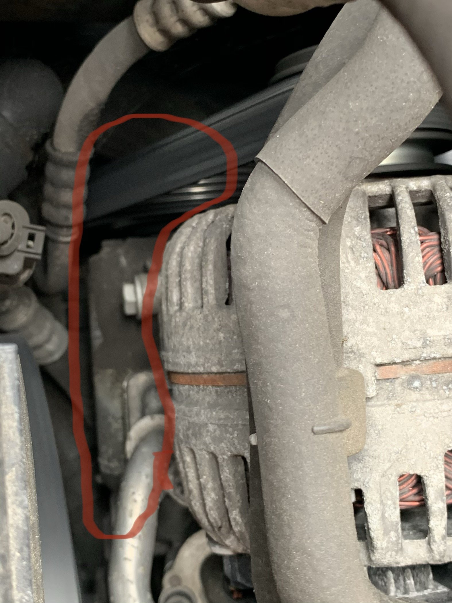

  7. Thanks a lot. I have ordered a diagnostic box so hopefully Thanks to amazon, I will be able to see if there is any tonight. When I press ac or set the temperature, the fan settings leds adjust accordingly; however, absolutely no air is coming out. If I'm correct, I have highlighted the AC compressor in the attached picture. The belt is on and it is turning normally. If I put my hand on the blower under the glove box, there is no movement/vibration whatsoever. The fuses in the fuse panels are all good. Is there a way to tell if it's the blower or the controller before it?? Or could it be anything else? Thanks again
