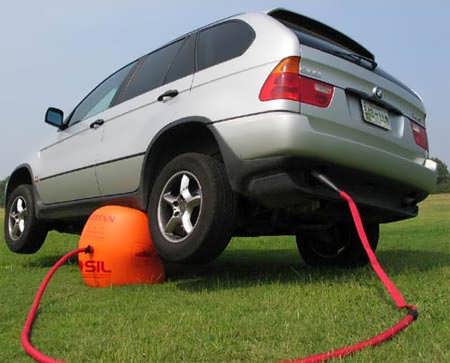

I think I'll invest in an oil extractor. Anyone up for a group buy?
Actually I was thinking of this. :rolleyes:
In all fairness when you're changing the fluids in your car half of the job is jacking it up, mounting on stands and draining oil. An extractor would halve the time. Hmmmmm.
Have used one of these before years ago in the middle east in the desert. Cool idea. Whack it on the exhuast and let it jack the car up for you. Only problem was the guy that used it on his Land Cruiser a few days previous to me placed it under the fuel tank and it dislodged the fuel pump. Doh!

I thought about one of these, but when else are you going to get under the car to give it an inspection? especially for things like the CV gators?
