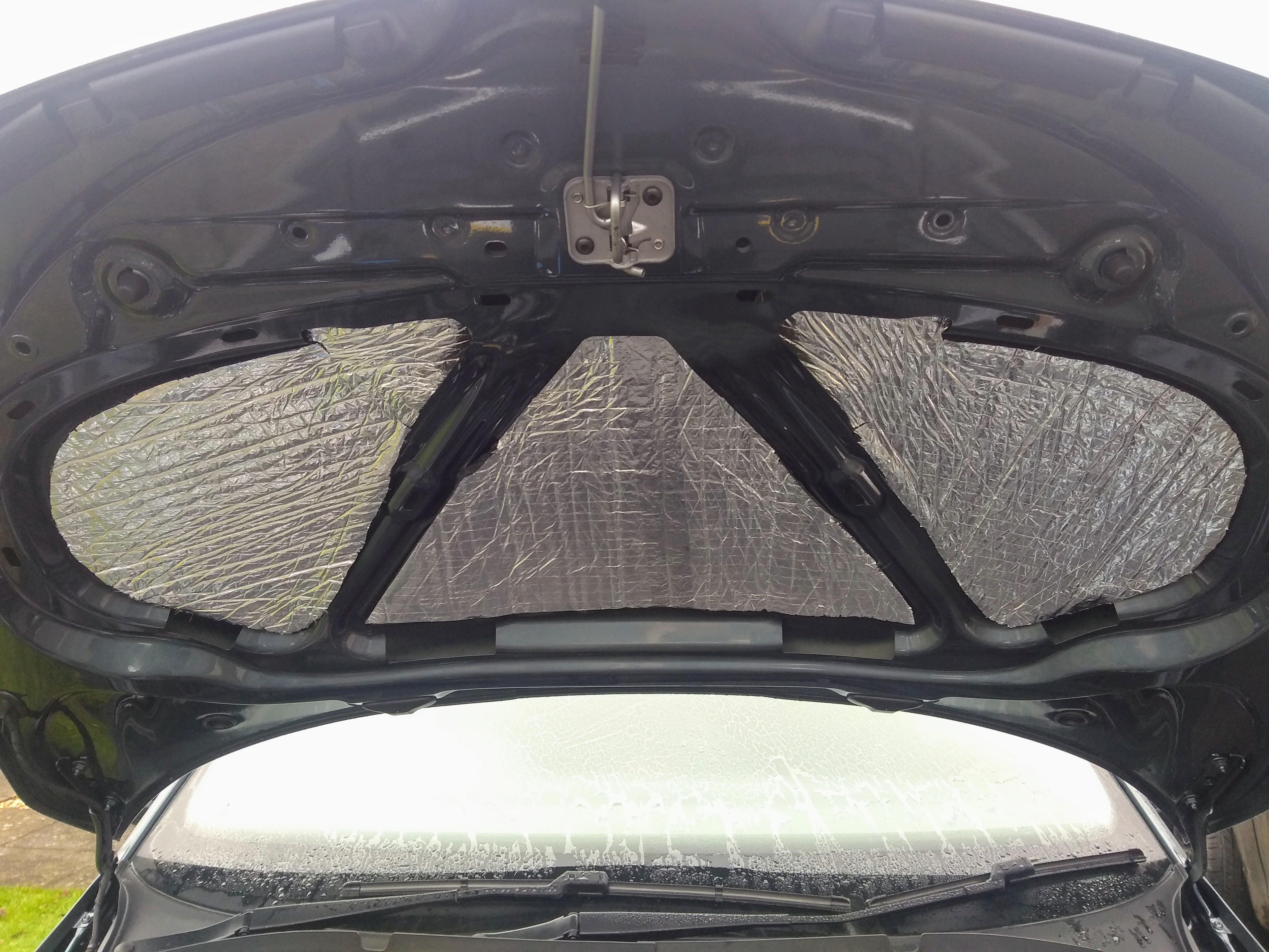

I know I can (and will) put sound deadening pads under the bonnet anyway, but a proper liner will look better covering those.

I want the liner more to cover up all the Noico soundproofing pads I've put under the bonnet.  If the liner adds any extra sound absorption, then that'll be a bonus, but at the moment the under bonnet looks somewhat daft.
