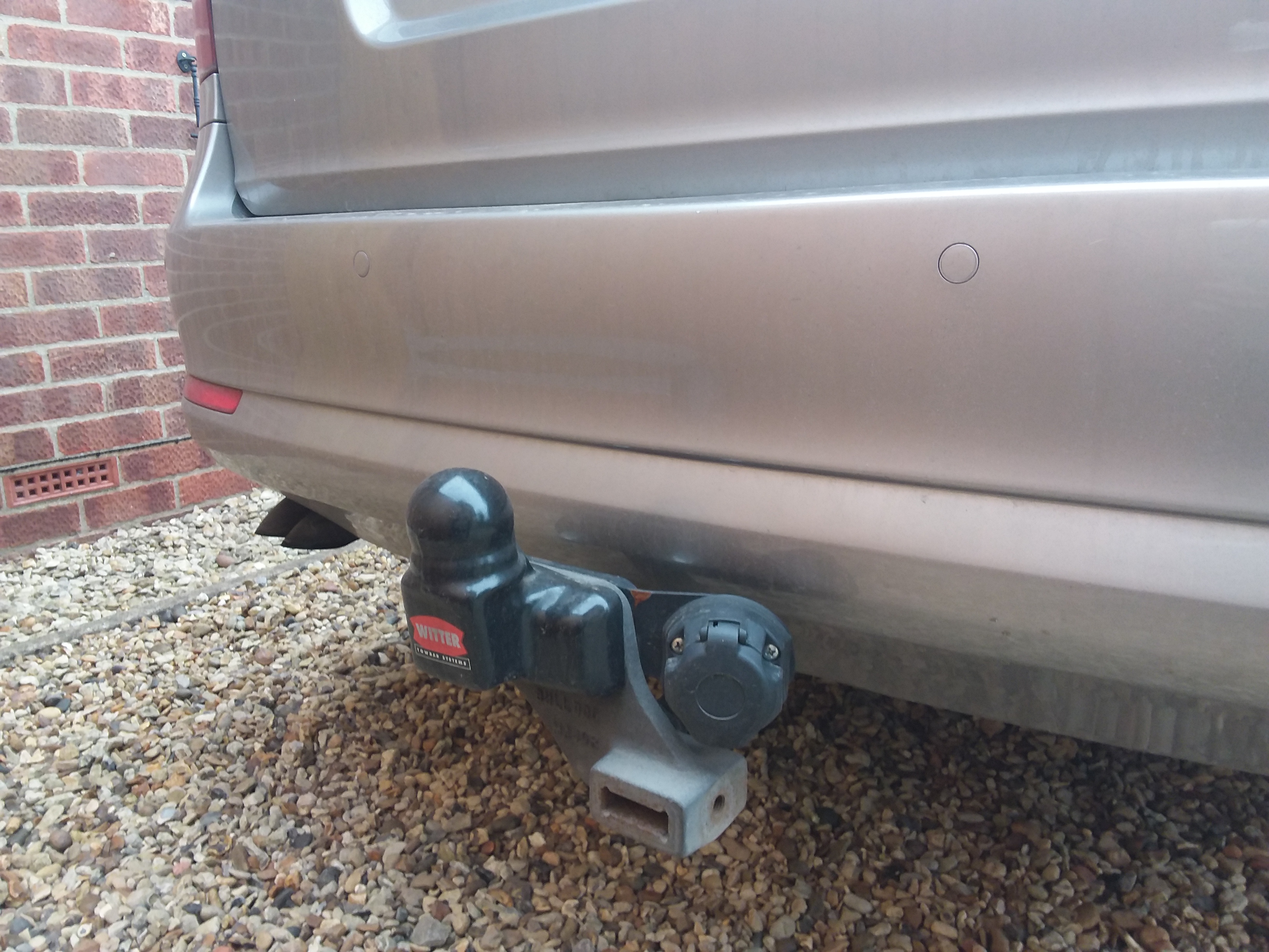

Am i the only one who really has problem with the sensors, it drives my wife up the wall every time i reverse. Th towbar is Witter and i presume standard electrics. Its been back to the dealer but they say nothing can be dione unless i change to the SKODA mega bucks one. I have tried first with the ball cover off then the electrics covers but still no good.Question, can the reverse sensors be turned say upwards so missing the bits?.
Did you have any luck with directing the sensors away from the ball to stop the interference but still allow you to use your parking sensors Alex
Fixed witter with no interference with reverse sensors, i used a dedicated electric kit so the reverse sensors and fog light's are disabled with trailer attached, also have heavy duty springs fitted which makes towing a lot more pleasant as the bar used to contact the road with standard springs, and that was with only 70 kgs on the ball.

Since my last post on this we changed to a 61 reg and the sensors work perfect on this year without any mods.Have same make riged towbar as before ie Witter
