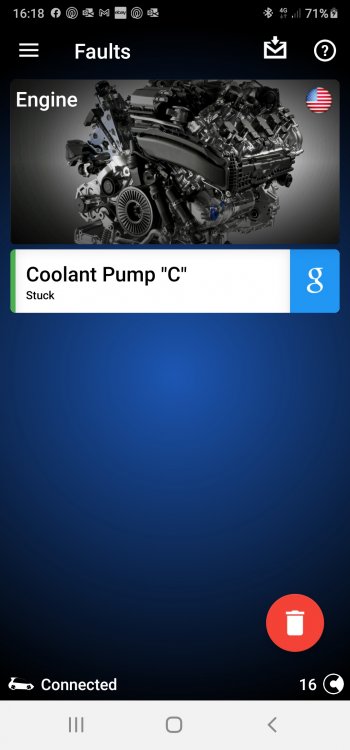

My wifes car 2017 Octavia scout 190 bhp has 2 common faults,
AUx Pump does it say pump B or C as has 2x aux electric bosch pumps plus main water pump. i had same issue skoda replaced twice under warrenty and still caused fault though me think this cant be like bosch to make faulty stuff turns out if theres even a small amount of air in coolant system will cause the fault to come on. you want to make sure engine gets up to tempurture with coolant bottle off and with some extra reving to heat up will cause any last air to leave leave to cool and make sure water level dont drop causing air to draw back into system. then you shall be fault free. also please remove slica gel bag out off expansion bottle will save you a heater matrix down the line.

Coolant pump 'C' Stuck
Hello, i have a 2016 skoda octavia scout with a 2.0tdi 103kw 150ps engine CRMB is engine code, since last december when i brought from a dealership have now had 2 coolant pump C replaced due to bring up fault saying coolant pump 'c' stuck. has anyone had this issue with there engine and if so how you gone to fix this as i believe it not the pump it self as its a bosch part and when run actuator test it works you can hear it spinning, so what else can cause this fault to keep coming back maybe a sensor???
