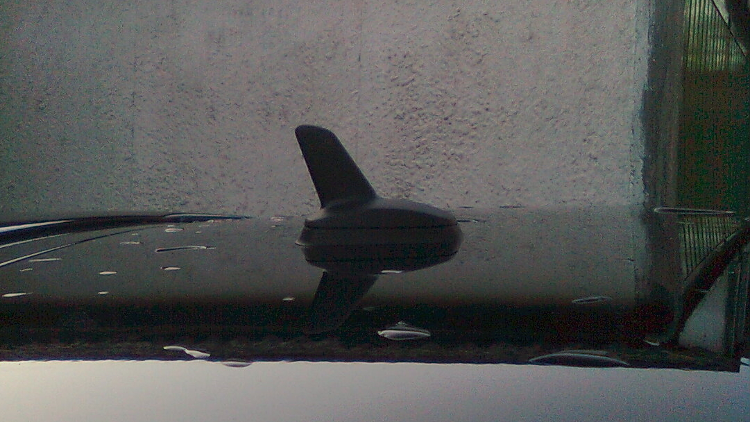

Hi mate. I've done this job although not with the vinyl.
I bought my sharkfin from Mike B.
I believe it's meant for a mark 5 Golf. Changing the aerial itself wasn't too tricky,
ultimately its one big nut... Which I'd guess was about 20-22mm.
Used an adjustable spanner so I am not certain of the actual size.
The connection for the aerial cable coming from the front of the car was
not a direct fit. I had to remove the plug sleeve thingy from the VW part.
There's a littele tab you pull out and it just comes apart. I then plugged the wires together
as they now could without aforementioned plug sleeve thingy. It was pink or purple IIRC.
Then I taped the bejeezus out of it to hold it together. Bodgy but effective. :D
What really knackered me was taking the plastic trim at the very rear of the roof lining off. :yes:
I broke mine completely and had to order another from main agent. It was only about
£7 to replace so not a massively expensive balls up. :dull:
Golden rule of removing this part is to pull it STRAIGHT downwards toward the chassis.
I tried to pry mine off and broke all of the plastic housing the metal clips on it.
They all stayed in their holes... LOL I just couldn't see how else it came off until I broke it.
Once you've got the impossitrim off. Gently pull down the roof lining to reveal the fixture for the
aerial. Try to keep the creasing to a minimum but there will be a little so don't panic if
you do crease the roof lining a bit.
When I put mine back together the creases sorted themselves out after I parked it in
the sun and the handy water stored in my rear footwells combined with the suns heat did the rest :rofl:
To the OP a MKV shark fin will cost you about £30-£35. Failing that have a quick scout about on ebay!
