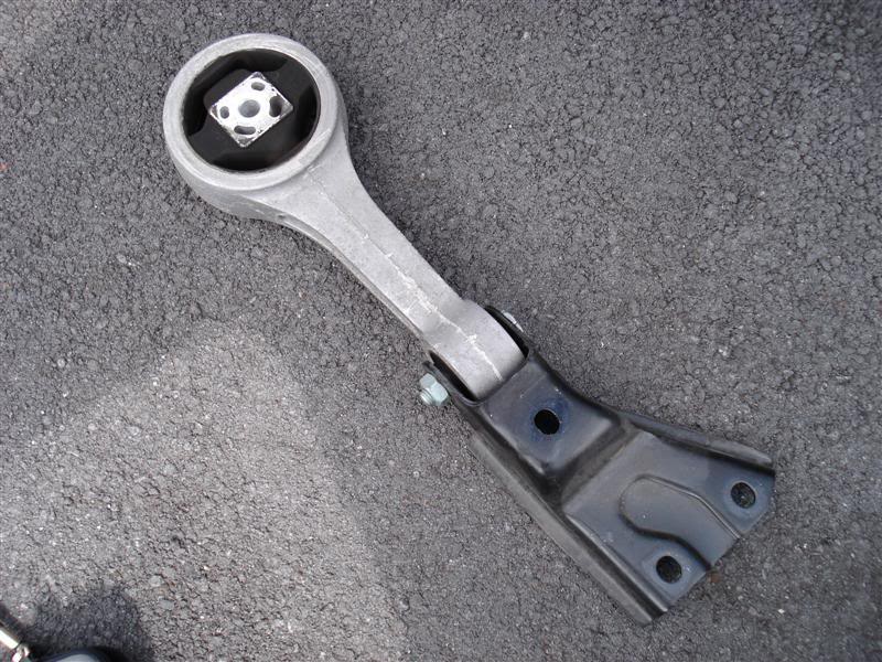

Could be dog-bone mount which is mounted under and to the rear of engine.
There is a write-up about it on this site, suggest do a 'SEARCH'
