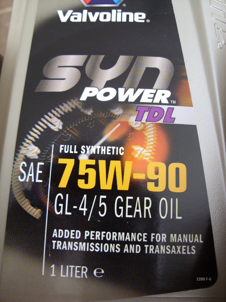

Gear-box type oil (attached photo)

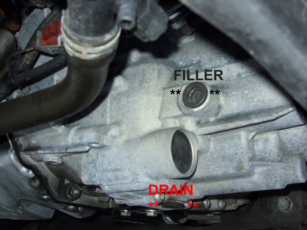

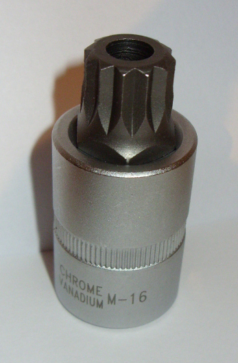

There is both a drain and level/filler plug needs special plug key (attached photo)
Gear-box holds about 2.3litres in total.
Skoda says gear-box filled for life or refill if leak develops.
