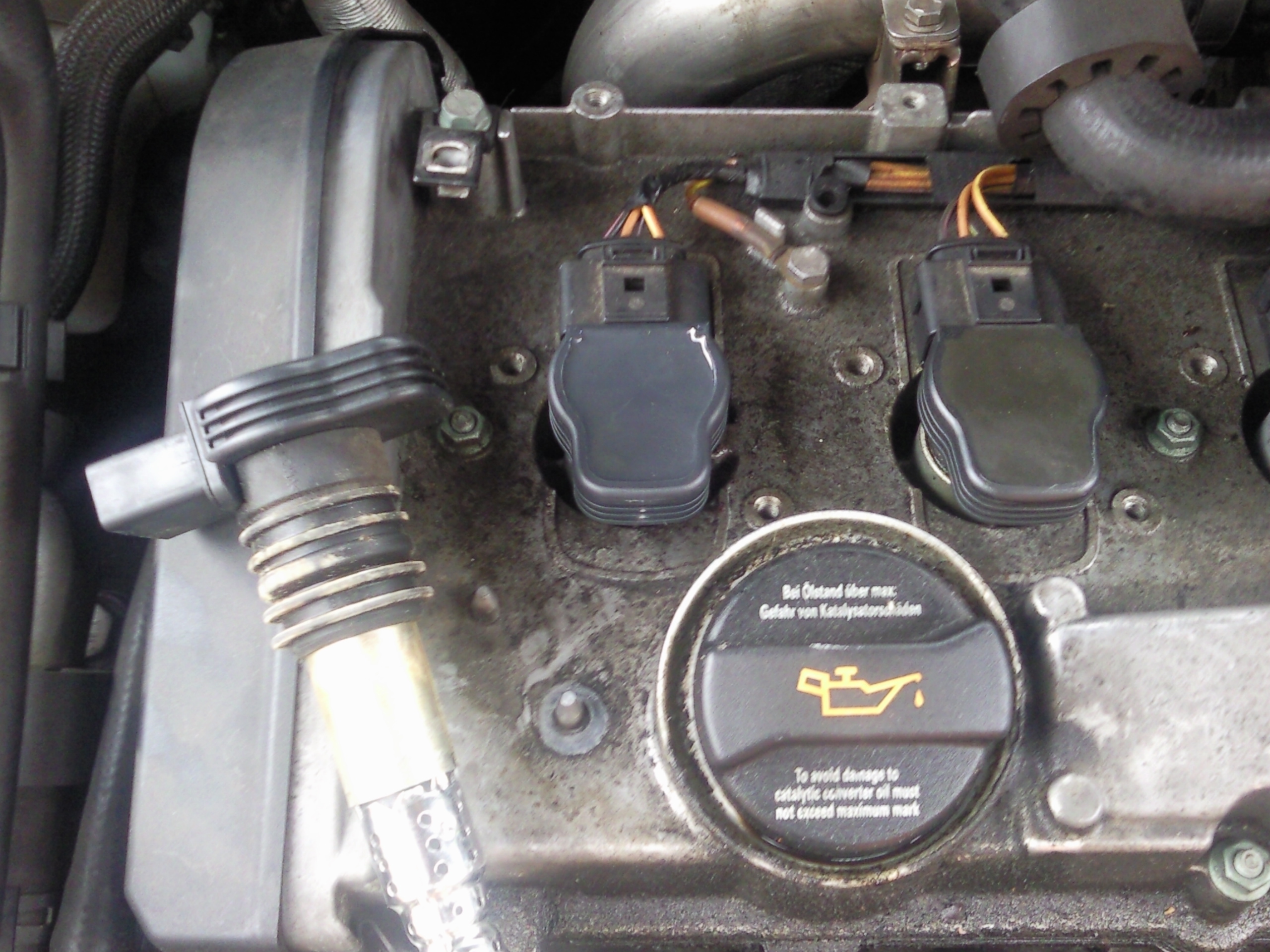

right chaps.. update
at work at mo so cant get any pics of crappy samsung phone argg - why cant they use the generic mini b type of cable like nokia..
anyhow, ive checked what i presume you meant chicken.. by removing the battery cover (pics later) no signs of any type of burning there.
Fired her up... and very very lumpy idle (worse ive ever known) even whilst sec air pump calms down...
then went to rear of car.. and i would say what is deffinately unburnt fuel kind of smell.. pointing towards coil pack again maybe?

Rather than remove electrical connector just pull up coil pack (only needs to be slightly pulled up). from spark plug one at a time until you either notice a worse running or no difference which each coil pack removed. If you get no difference then that is the coil pack faulty.
In the 3 years I have had my motor and it is mapped I have only replaced one coil pack. I would not justify buying all 4 until you have proven each one that is defective. Some members have had more coil packs go but probably more bad luck that being caused by fitting a new one. ( a spare in the boot good idea as mentioned)There are upgraded ones that are bolted down(Hitachi) but are a extortionate price and not worth the cost unless you are running a heavy modded car.
Also one area to check is the wiring to the coil pack plugs. This wiring can get hot from the turbo and the insulation can get brittle and crack and in worse case cause arching across the cam belt cover.
I had this on mine and re insulated the wiring and also fitted a Audi TT heat shield over the wiring which is a dealer standard part on the 1.8T Audi’s

coil pack one changed.... Fault codes cleared... fired her up.. straight away the car felt even better than prior to the EML coming on i have to say.. felt more responsive :rofl:
so took for a 10 minute drive.. engine fully upto temp... not an EML in sight :thumbup: Came back home, hooked upto vag com... no fault codes found - happy days
so goes to proove that sometimes extra fault codes can still be because of another one thrown up. Had a word with parts guy and he said he'd be suprised if it would be knock sensor as he'd only seen about 2 go in 14 years. Anyways am just happy i can once again have my wheels back :rofl:
Oh what i have noticed is that the faulty one is a 115J series (new one 115D), and noticed the new one had like a shiny top to it compared to the ones i've got
