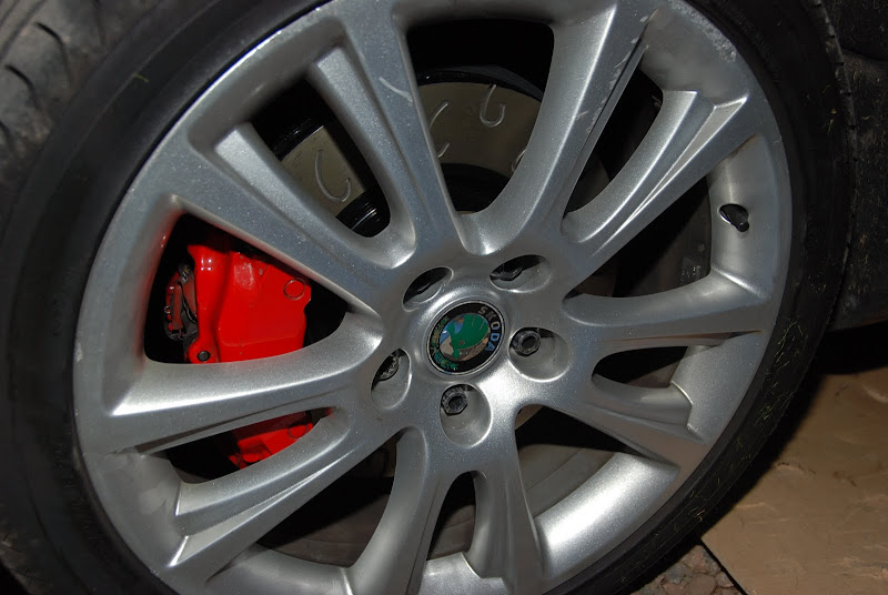

Here they are on the car
I guess the aesthetic looks of these things are about personal taste. Personally, I liked them although my main driver for buying these was to squeeze a bit extra braking performance...and lose the non-aesthetics of the existing rusting discs. On to the performance....
It is difficult to comment on braking performancewith respect to standard VRS brakes as I have never tried this and the jump-up with the new calipers would make further improvements a little bit more difficult to distinguish. Generally, I think that they are a tad better in low/medium speed conditions and in the dry. However, where I have felt a more notable difference is when hooning it and in the wet - these seem to react with notably better initial bite and braking thereafter. I guess this is not surprising when you look at the design which is intended to eject water, dust and heat.
Another thing that made me hesitate before buying them was a fear that these things would be noisy - not the case! In fact I can hardly tell the difference from the normal discs. With the window down and some hard breaking, I can make out a very faint 'zipping' sound coming from these discs but only when I am deliberately listening for it.
I think these would be well-worth considering for anyone looking to get some improvement out of the stock VRS brakes particularly with braking in the wet or at speed but for those looking at getting some decent capability out of their 312mm set-up, I think you will still need to be looking at better aftermarket pads or uprated calipers (imho, the standard pads/calipers have no right being on a remapped VRS, MkV GTI and especially and Golf ED30)

I'm not sure what DaveB would charge now but I guess it would be about £200 so a good £130 more than getting a pair of aftermarket standard discs so some thought will definitely be there on whether it is worth it to each individual. In fact, he did really target these at the more enthusiastic / track day driver rather someone wanting improvement with normal road use - I just ignored that bit :giggle: Perhaps DaveB will come on an correct me on the cost.
