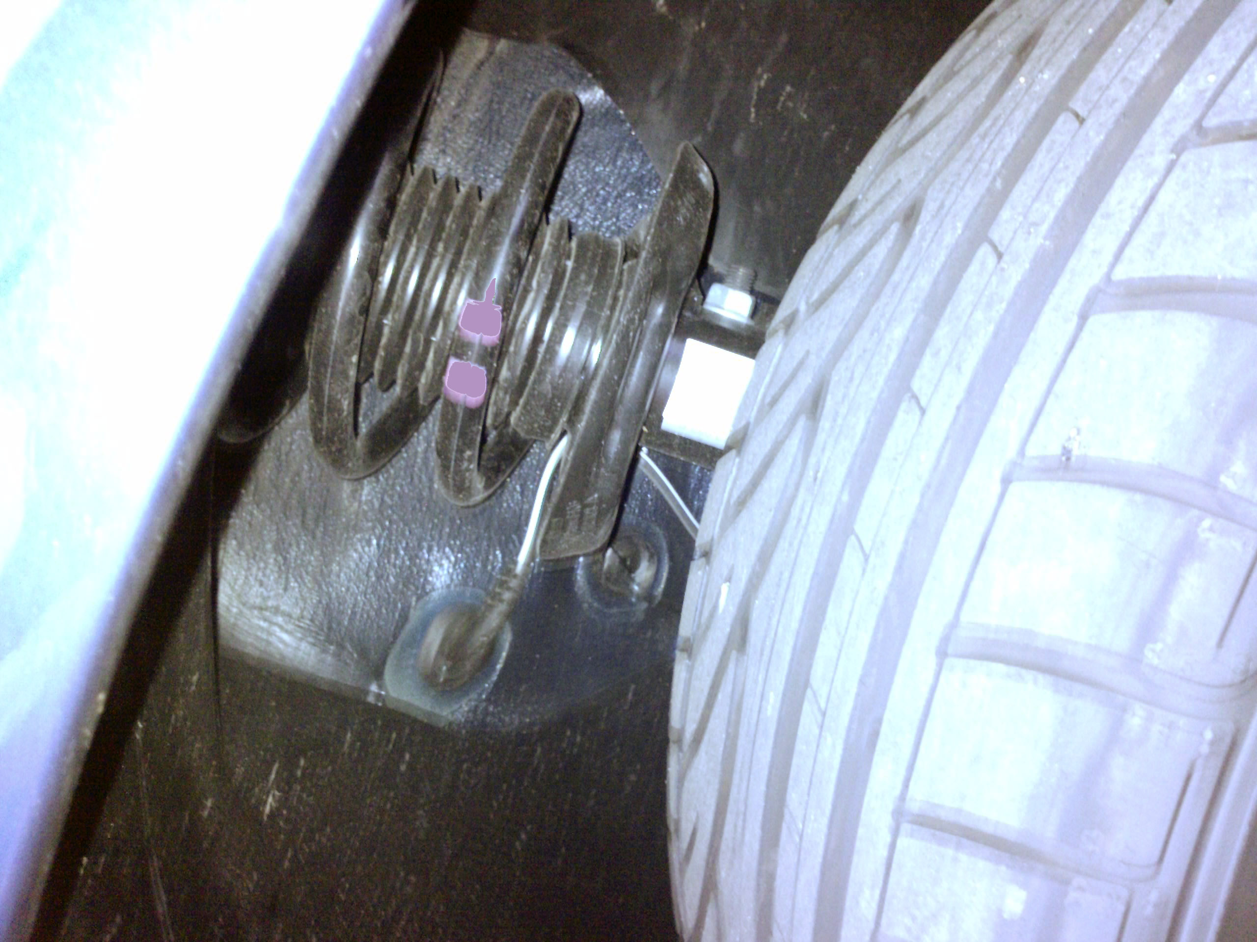

The 1.8 TSI front springs have two magenta paint marks on them - the colour code should identify the spring.
(Sorry about the crap image - had to photoshop a cameraphone pic to get the colour to show properly)
If anyone cares, then look under the wheelarch of a diesel Yeti and see if you have the same marks - if your marks are the same then your springs are the same :-)

For what it's worth, the front springs on our 1.2 have two pink and two grey paint marks on them.
