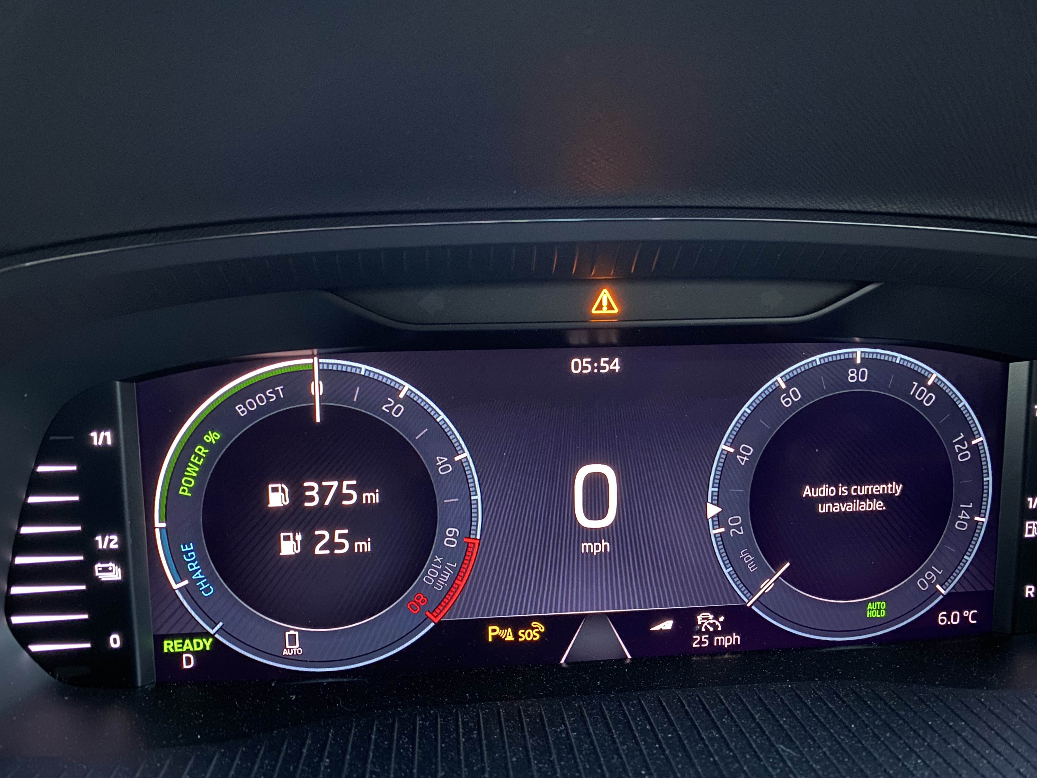

Has anyone had the re-boot associated with an Orange PDC warning? Mine is starting to system reboot (media) every few days, always in the first 5 mins of a journey and recently it has been preceded by a PDC warning... It seems to be happening more and more, now it recently re-booted twice before it worked properly. Compared with the issues I have had in the past this is just annoying, but if it keeps getting worse.... and the warranty runs out in November, so keen to chase this one down. I am on the latest software.
@matrix2020 The simple answer is probably yes.
I couldn’t say for sure I always get the parking distance control warning light first but this is what I see when the system starts it’s rebooting loop in my case.
Yes! Mine has started doing this randomly in the last month or so and it always occurs in the first few minutes of the journey.
I tried to get a video of it but, typically, it doesn't happen when I'm pointing a camera at it 😁.
Interestingly it happened the other day when I turned on the ignition (but not the engine) and was sat on the drive waiting for everyone to get in the car.
I had a front parking sensor replaced recently so I was wondering if it was related to that?
Same here, for a couple weeks ago, it started to reboot in the first 10 minutes in car. Occasionally with an error from parking assistant as well. After one or two reboots, its stable.
But today the car was completely dead so its in the workshop now.
So i shall expect mine to get there soon as well. So far i`m on the phase of 1 or 2 reboots when starting the engine, then it`s fine. 😞
