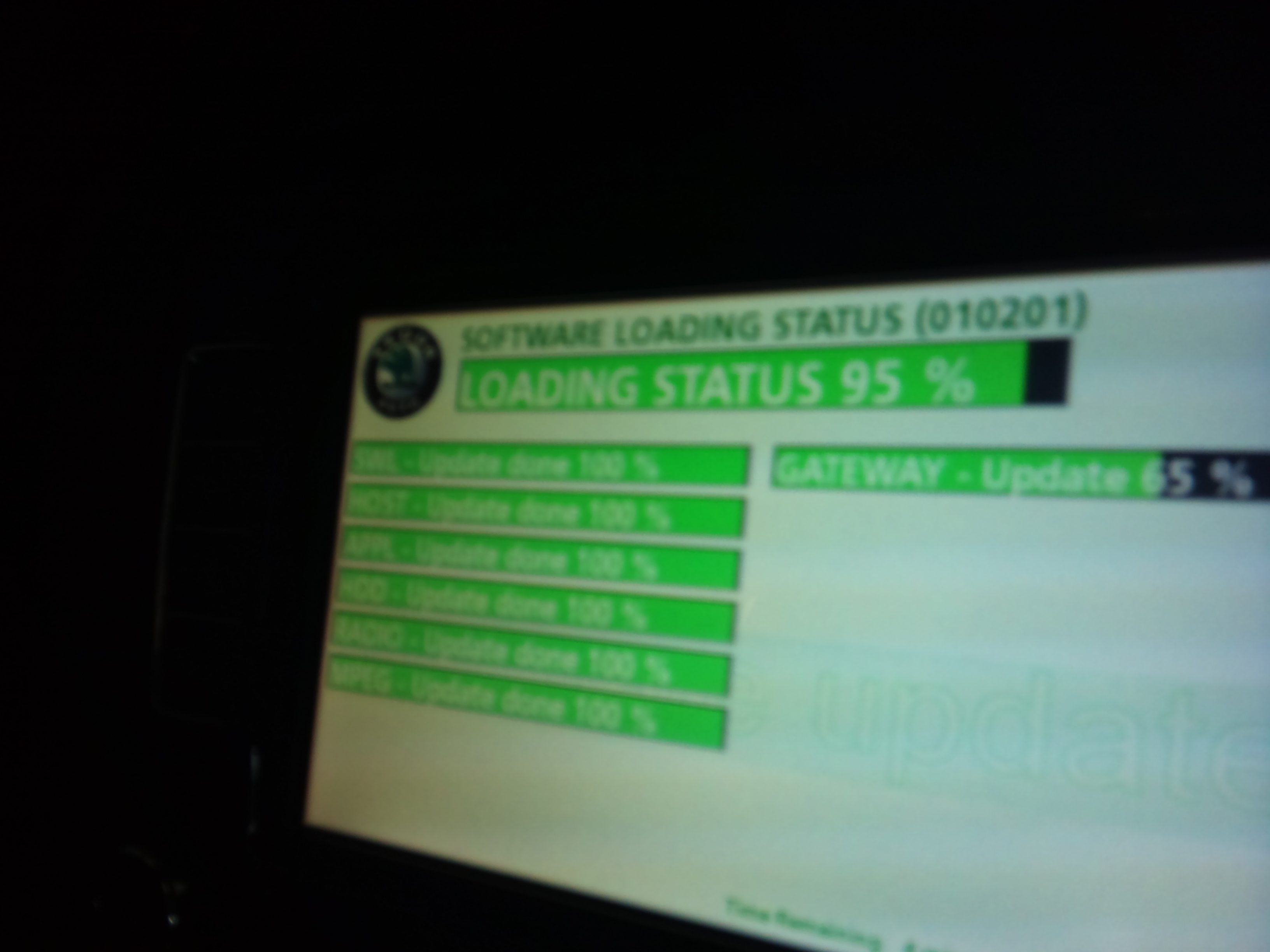

columbus firmware updated BUT,
as above . columbus firmware updated . mfsw now working but not the maxidot. When the frimware uploaded the navigation was on the maxidot but i could get into the other maxuidot function's . then when i shut everything down and locked the car and went for a cup of tea i came back got in the car and the maxidot was back to normal but with out the navigatin function. d9ose the cambus need updateing or should i reload the columbus firmware and try again??

It might just need recoding with VCDS.
Have you tried a reset by pressing < , > and I together until the Skoda splash screen starts.
Otherwise it must be a damaged firmware.
After I did my FL, it was the same as yours. All coding was correct, Also tried rebooting it but that didnt work. In the end, leaving it switched off for 2/3 hours did the trick and it re-appeared in Maxidot.
Make sure all your coding is 100% first though.
yes i think it needs ercodeing. ned to get towbar electrics coded so thats the next job on the list,
