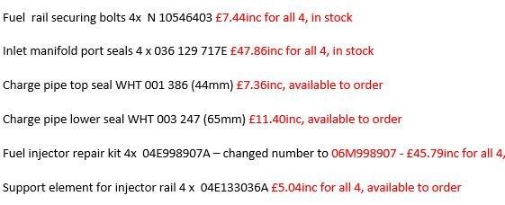

  3. 300 plus vat for parts, so not too bad I suppose. Must say, after having a new mazda 2 hire car,getting back in monte is an absolute joy 👌👍

  9. Sorry for the delay in responding. I have had the car taken to a local garage, i just simply haven't got the time to do it. I'll post the latest prices for the parts. Thanks for your help 👍
