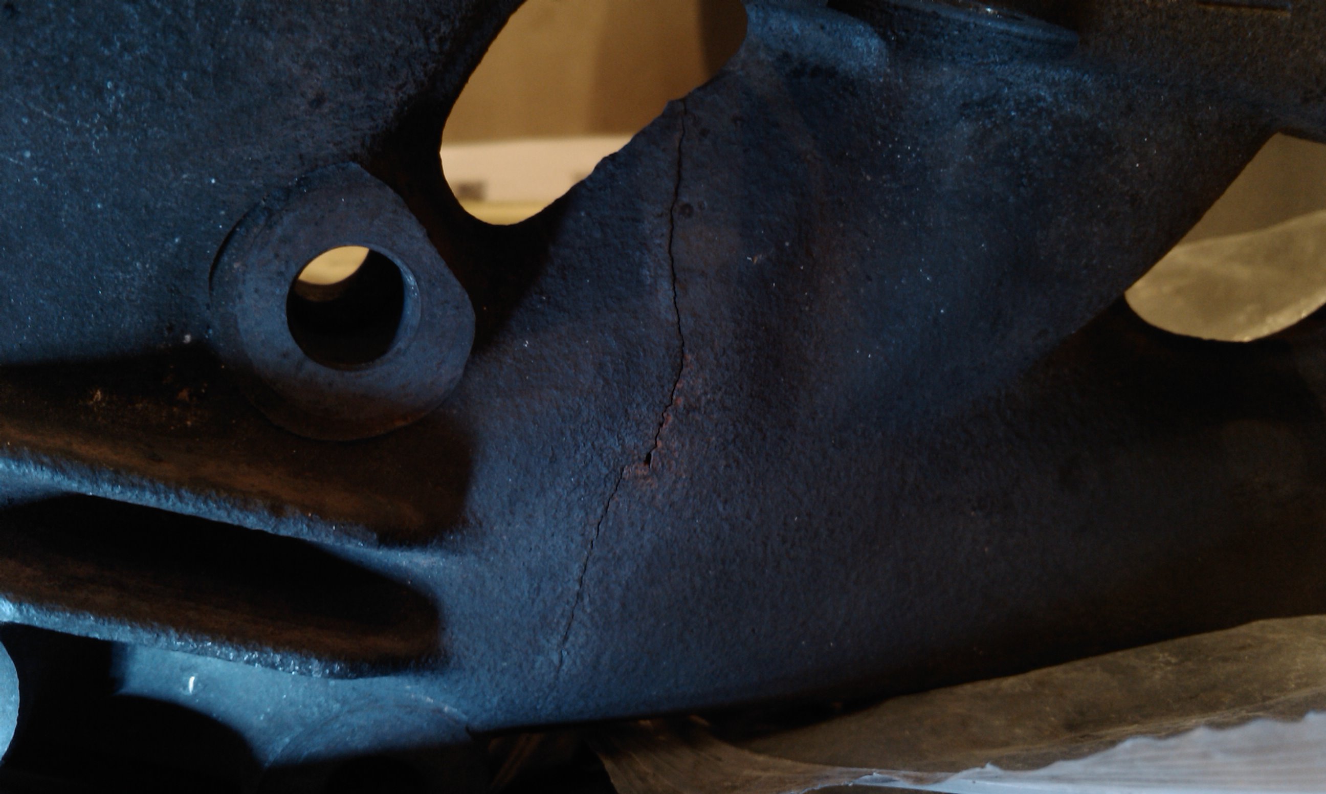

Pretty sure its a crack there is a line about 1" long just to the right of the turbo mounting bolts, which just for good measure i managed to snap one of the heads off :@

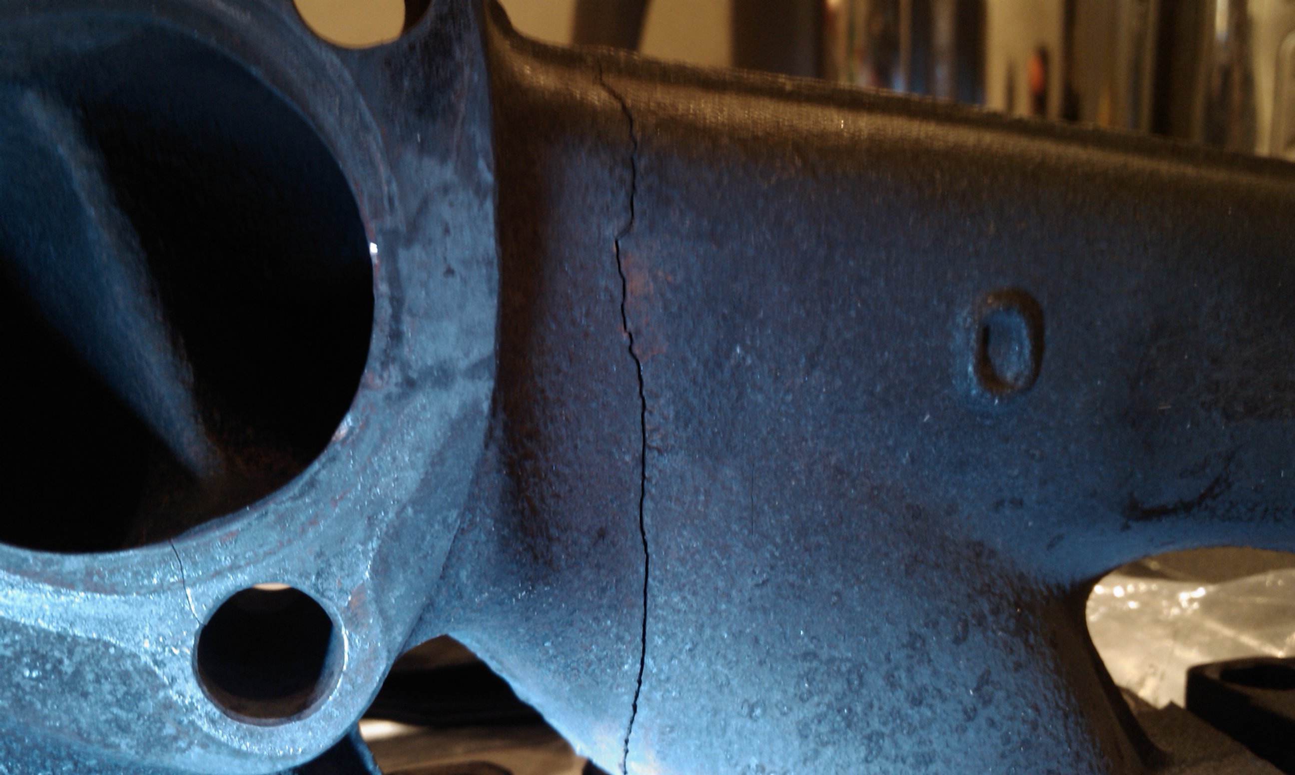

well i finally got the old manifold off and i think cracked is a bit of an understatment :doh:
:o
Ouch.... nasty!! I thought I had escaped cracked manifolds when I changed from a V70 to vRS! oh well...good luck in finding a second hand one.
