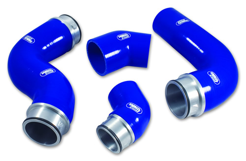

I have been looking at the above 2 kits and will be making a purchase in the new year. I can see that the forge kit has 3 hoses and Samco has 4? Where does the extra hose go, as I cannot see where it would fit in the system?
Any ideas?:wonder:
Yep, the top hose in the picture without any machined spigots fits between the throttle body and the OEM plastic boost pipe, the one on the right fits between the OEM plastic pipe and the intercooler, these are the cold side hoses. The other 2 are fitted on the hot side.

Thanks Bogwoppitemoticon-0148-yes.gif I had looked at these but I already have a neuspeed front intercooler pipe and can get the Samco/forge hoses about £130 cheaper than the SFS hoses. The extra hose in the Samco kit must go from the turbo to the metal pipe. I think I will opt for the Samco kit, as it replaces all the hoses.

I had an early birthday present from my fiancé in the form of the Samco boost hoses kit. I was well impressed when she said she would buy me these:rofl:
I have fitted them and could immediately feel the extra surge in power. With the OE hoses when ever I put my foot down the engine hesitated and for want of better words 'bogged down'. Then the engine would build up and go. Now there is no hesitation in the power delivery. It is very smooth and has improved everything from the low end, mid range and top end power. The engine is quieter when driving normally but put your foot down and it growls more. My MPG has increased by 2 and overall I am very happy with the kit.
The hose from the turbo is at less of an angle to improve the flow and is much less restrictive than the OE pipe. However it does mean that the metal pipe it attaches too cannot be attached to the side of the engine like normal. This does not cause any problems, as its held in place by the hoses either side, leaves plenty of clearance below the belts and does not catch on anything. The alloy joiners fit exactly and are tight unlike the OE ones, which move around from side to side and out wards causing a slight leak. They look good too and I am really pleased I have them now.
She paid only £151 from awesome for these hoses and thats £50 less than normal. If anyone is thinking of changing the hoses and thinks it may be a waste of time. Buy them and you will be impressed at the difference they make. My bum on seat dyno would say the engine feels like it has another 10/15bhp. It is that much of a difference the way the engine feels. Plus the kit comes with all the jubilee clips needed to fit. The only thing you will need to do it take the oil seals from off the OE hoses and allow 2 hours to fit on the drive.

The part number for the kit is EN-HO-SAM-325-SPECIAL. I am not sure of the exact diameter of the hoses wihout measuring but they are wider and a lot more rigid that the OE hoses. Also they are straighter in shape to help improve the airflow. You could try metal pipes but you would still need the alloy couplers and a small section of silicone hose to attach. On my old FRS I had the Samco hoses then some Stainless pipes from germany fitted. I didnt feel any benefit of the stainless pipes other than they looked bling in the engine bayB) The silicone hoses are very rigid and more than up to the job.
