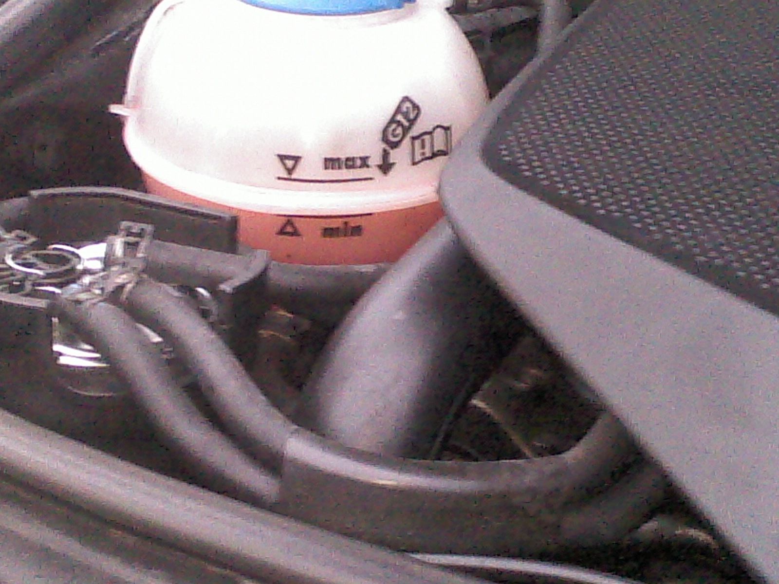

No - but having opened the bonnet and glanced at the bottle the number I posted is CLEARLY VISIBLE on the bottle itself!
So the moral of the story is look at what you've got!
Where's that, then?
Where's that, then?
Here !!!
