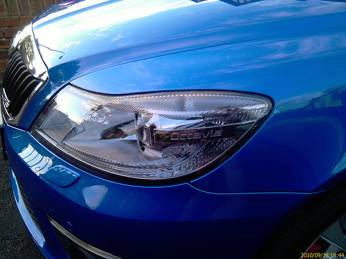

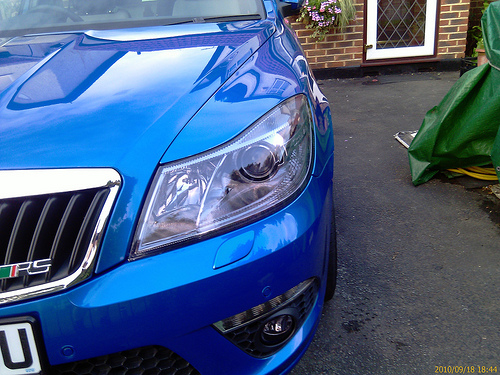

Sounds like you got a dodgy batch, the small bits I fitted on my DRL's were fine from day 1, below are a couple of pictures of a member's car with the headlamps covered in subtle tint!
