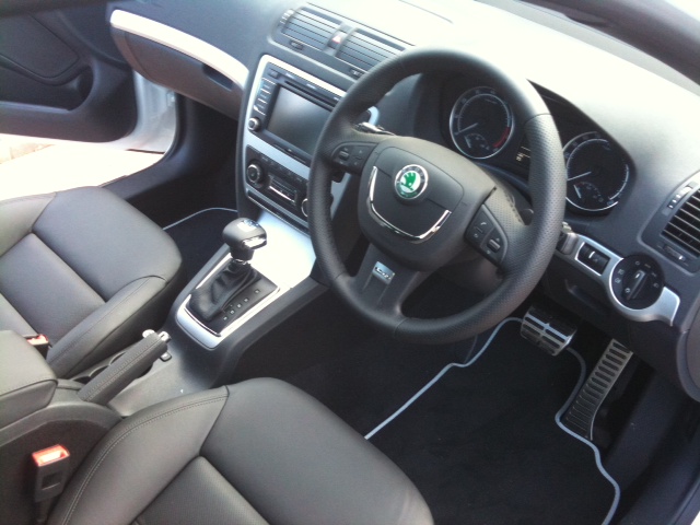

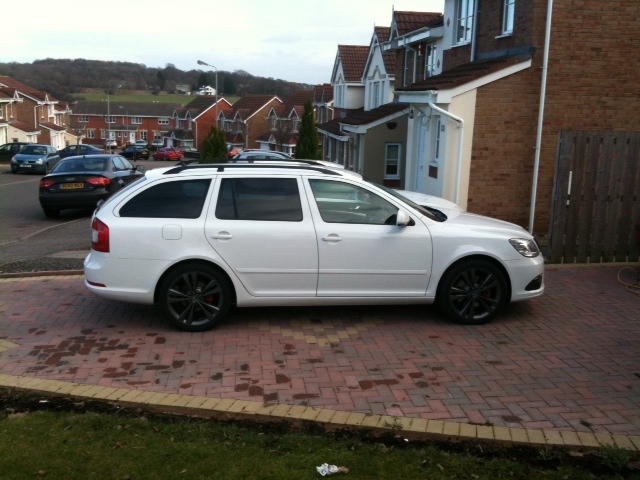

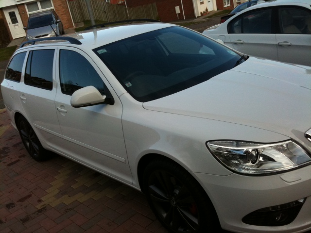

Pics will be near enough like looking in a mirror at yours ;-) Well, body's different and mine isn't as loooooooow yet :giggle: Here's some from a phone:
That interior pic was taken after i'd taken the dash all apart and put it back together again after fitting MDI + ipod lead in the ashtray in front of the gear stick, Bluetooth, SatNav in the top box.
You'd never know i'd been at it :giggle:
