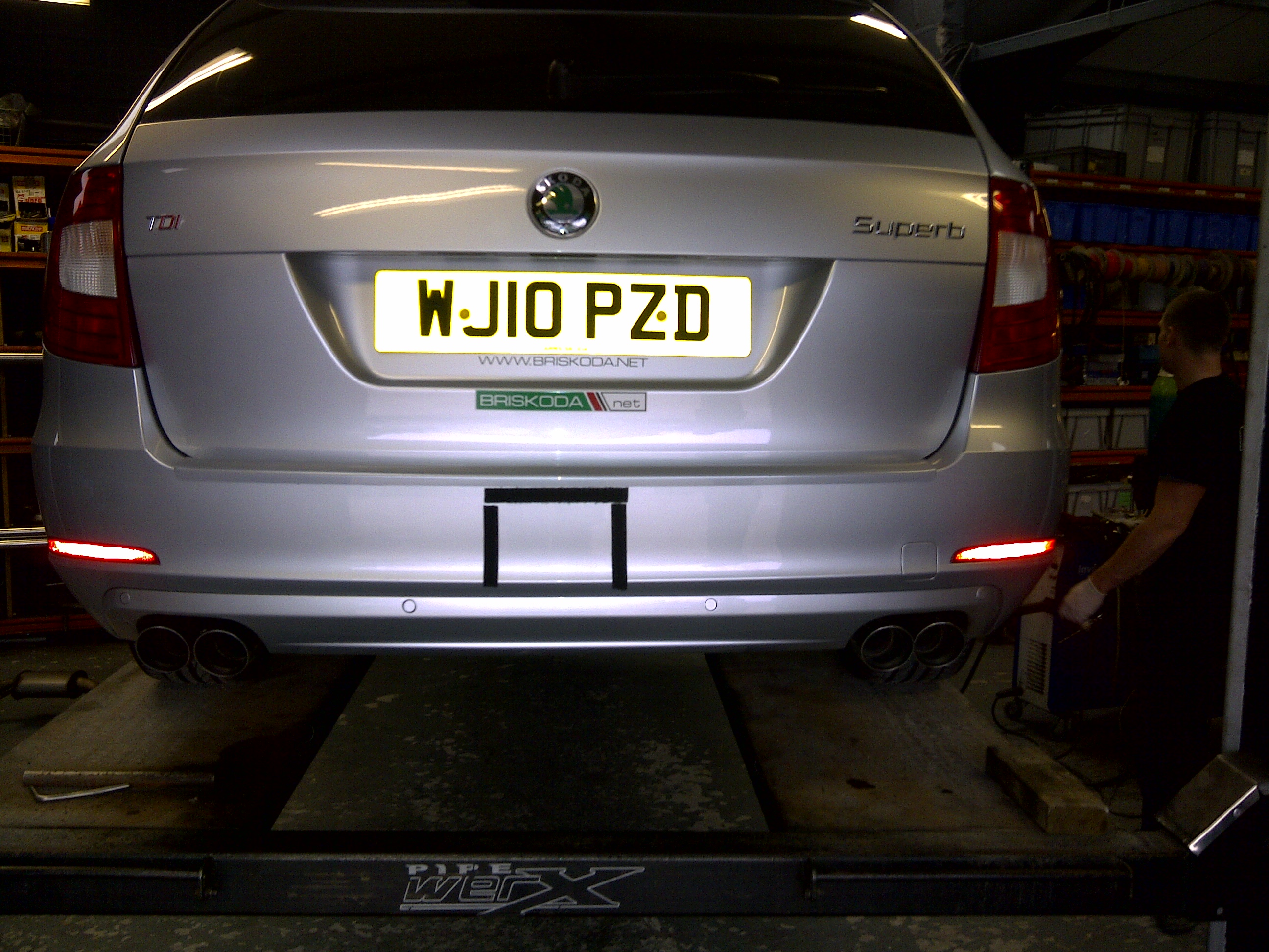

Yesterday (Friday) I went walkabout up north and visited Jeff at Pipewerx. Yes .....you guessed right.....I finally had quad exhaust system fitted. And boy oh boy am I pleased....you bet I am.
Jeff the owner of pipewerx did himself proud as well as me proud. The whole removal (from cat back) the disign and manufacture of the exhaust system was well worth the day out. jeff made me feel welcome and allowed me into the inner sanctum of his workshops to watch the whole process from start to finish. I must say that I just recommend anyone to visit his establishment as they will come away with the biggest ear to er grin ever. The sheer care, thought and precision that Jeff and his team took was just simply awesome. Each stage was explained fully. Also some of the machinery there like rear engined polo with some 500 bhp was a sight to behold let alone Jeff's twin RS3 engined VW Caddy van...absolutely blinding.
So back to the quad exhaust.....absolutely stunning. On start up it sounds like a normal tdi. driving the car as usual taking it easy the sound from inside the car is as per normal. However knock the gear lever back into sport and poke the gas pedal to the floor the car simple rockets forward with a subdued growl. The number of times I had car almost rear ending me just to see wot was wot....a bespoilered Superb estate tdi with quad exhausts. One minute doing 85 then opening her up and showing 150 on the clock and 144 on Road Angel Vantage.....just awesome.

Tankdave.....you will need the rear spoiler/difuuser which has the cut already marked and is simply cut out with an air saw. Also on the new spoiler you'll need to drill out the four holes which are clearly marked for your reverse sensonsors. Fitting of the new spoiler is dead simple. :D

tankdave....you will be suprised that we started the engine and revved it WITHOUT the standard exhaust system....god it was so quiet it was unbelievable. I then decided on Jeff's advice just to have a centre section. I have today used the car locally and clocked up 80 odd miles....not a squeak of noise or boom or rumble on normal town driving. Poke the load pedal and there is just the faintest rumble from the exhaust.
The diffuser is a genuine OE from the local stealer. I purched from spoiler, roof spoiler and the diffuser. The diffuser fitted to yr car does not have any "cut outs" for the exhaust. The new unit is just a push and click fit on the top edge above the reverse sensor and with four torx screws underneath.
I had my bodyshop paint and fitted the fron and roof spoilers. They also cut the section for the rite hand exhaust and drill out the four holes for the sensors. They then painted the diffuser. I took the diffuser in the boot with me.
It took Jeff a matter of 2 minutes to remove the "old" diffuser and around 5 minutes the reove the entire system as one unit. Base mesurements were taken from the old system for reference for the centre section to be made and hung.
The reverse sensors were removed from the old diffuser and with new double sided tape were transfered to the new unit. The diffuser then took about 2 mins again to fit and connect wireing to the sensors.
The car was again fired up and revved after the new centre section was fitted to test for noise level. I was gobsmacked at how quiet it was.
The whole removal of the old system, design of a new system and manufacture of the same was around 5.5 hours and that included a lunch break and two tea breaks. Total cost of the system was £550 inc vat labour and parts. It comes with a lifetime warranty. Personally I think this was real value for money and it was a pleasure to spend it and certainly far cheaper than an OE system.
The engine now breathes far better and therefore responds better and quicker. Despite the city driving today I got 38.7mpg and still had fun every now and then.
Had a lot of VERY positive comments from loads of peeps today including the stealer dealer whoose jaw dropped on seeing all 3 spoilers fitted and painted and the quad exhausts.....it was first time for the stealer to see anything like this in the flesh.
Jeff at Pipewerx at www.pipewerx.com on 01704 897778. Sorry for the plug but I AM NOT on commission. I am just an extremely satisfied customer and i defy anyone to try their services and not come away 100% satisfied. Those that are contemplating this should just GO FOR IT!!!!!

Tankdave.....circa a oner for the diffuser. My paintshop charged me 75 notes to paint, cut/drill rear spoiler and fitting or roof and front spoiler. Hope this helps :yes:
