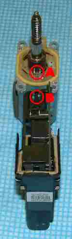

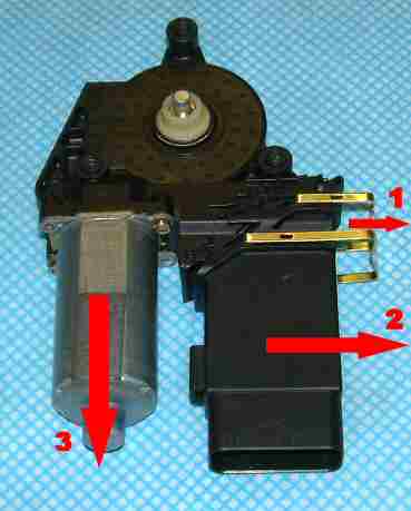

Does everything else working on that door?
Check the central locking by pressing the lock/unlock buttons on the driver's armrest.
Check all four windows switches on the driver's armrest
Check the LED flashes when the doors are locked.
Check the interior light comes on when the door is opened
Check the mirrors and mirror heaters.
It is often the electronics in the box attached to door motor unit that fail.
If it is only the window that is not working, it may just be the motor contacts.
Remove the motor unit from the window regulator.
Remove the spring clip.
Open the six plastic latches and pull the control unit off the assembly. Examine the contacts (B - second pic) that stick out of the control unit.
If they are OK, undo the four screws that hold the actual motor and withdraw it from the gearbox.
Hold the motor vertically. Apply a voltage to the two contacts of the motor (A -second pic) for one second. A 9v battery is fine. You should feel the motor trying to turn. If it does then the whole motor assembly will need to be replaced as the electronics in the box has had it.
If the motor itself is dead, and you can't find someone on here who has a complete unit then PM me

The motor is working but it seems to be the electronic box which is not sending out power. Can you recommend a place I can buy a new unit from. I've tried Skoda and they want £210.

Unfortunately, you can't buy the box separately, so you have to buy the motor which includes it. If you want a new one, you have to go to the dealer (or TPS if you have a mate in the motor trade). There is no aftermarket solution.
The best option is to find someone breaking a car or go to a scrap yard (£50 seems to be the going rate). Make sure you get one with the same part number (usually on a white label on the motor part of the assembly.
