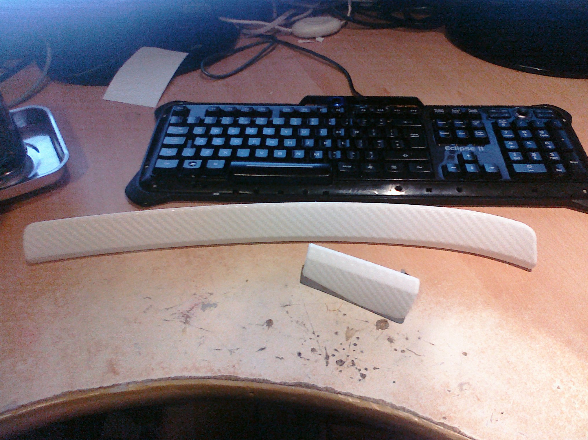

been vinyl wrapping
white carbon fibre to match my white leather seats!

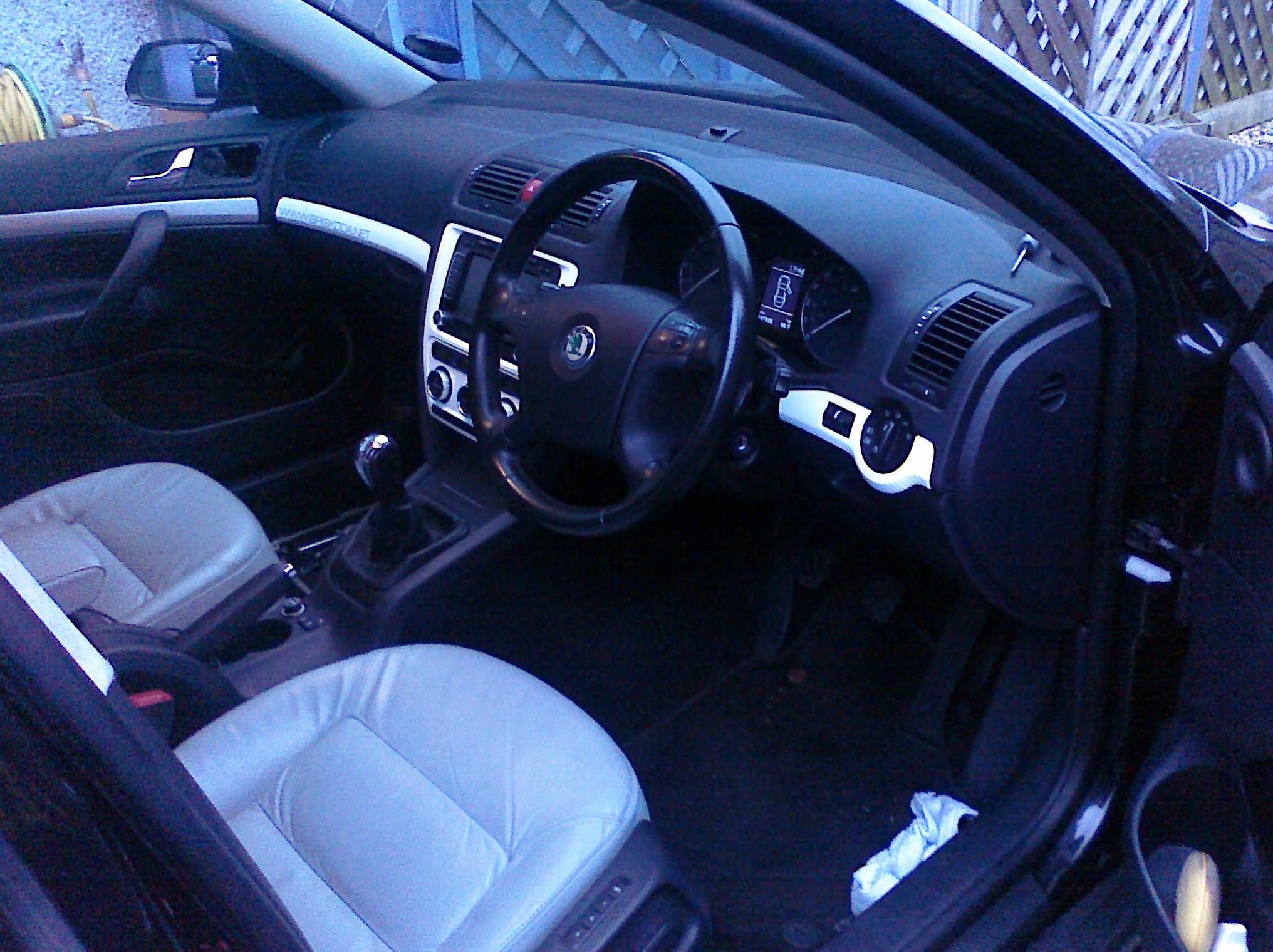

here it is all fitted
the car is being worked on so it's messy inside. I usually keep it spotless - 'tis my baby!

Hi, looks great!!
Where did you get the white carbon fibre wrap from?

how difficult was it to get the trim off ?

Thanks dude! I got it from eBay, it was about a tenner for a big sheet. I ordered two large sheets incase of FUBAR. I'd like to see some piccies!
Right, it is quite an awkward job, but not awfully difficult if you've had experience of car trim before. The light switch surround just pops out with the light switch module. The small piece of trim between the steering wheel surround and centre console just pulls off, get your fingers under it and prize it off. I do have a nice trim removal tool and I'd reccomend one to anyone, it made the job a lot easier. The strip below the passenger airbag was a complete pain, mainly for accessibility, I have a really bad back and found it hard to get down on the floor.
You have to drop the glovebox and surrounding trim to gain access to the strip and there's three torx bits, and speedclips holding it in place, access is really tight behind the trim so you need small hands. Also, when you drop the glovebox make sure you don't let the weight of it hang on the cables going into it, as they're for the airbag switch and it could mess the whole system up costing big bucks!
