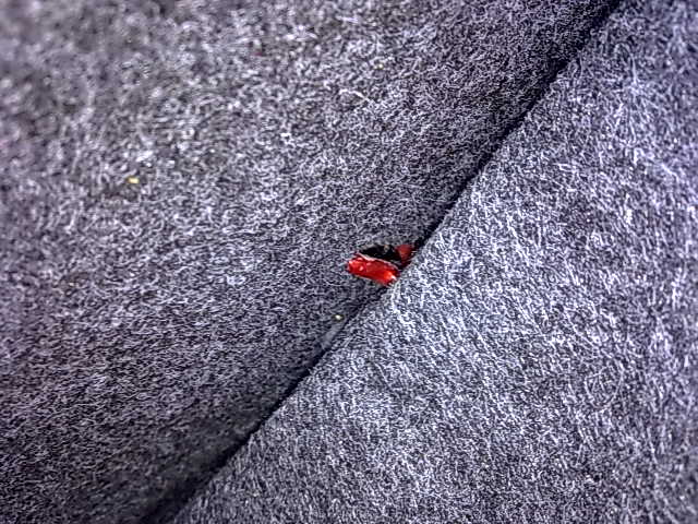

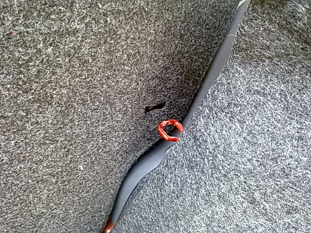

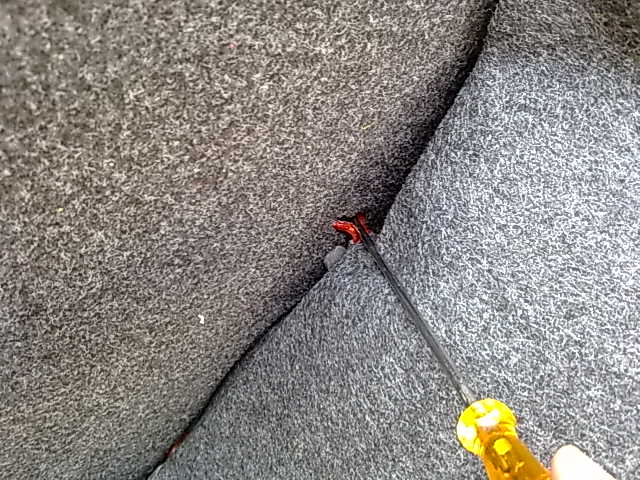

Open the boot and use a long flat head screwdriver to lift the latch holding the seat in place, that's how release mine after it broke :thumbup:
Can take pictures if required.

Yer any pics would be helpful.
Will take some tomorrow
As promised some pictures
Thanks for them. Managed to do it and getthem out. Halfway through now :-)
