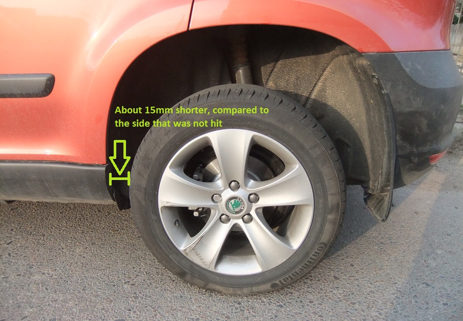

And it looks like I made the right decision. This morning I checked out the damage in the daylight and something did not look right. I took some measuring tape and after the accident my rear left wheel moved to the front by about 15 millimeters (see photo).

Obviously just guess work but I would suspect it's trashed the assemble carrier (sub frame) and attached wishbone :wonder:
Possible distorted the mounting points highlighted; it's only pressed steel.
