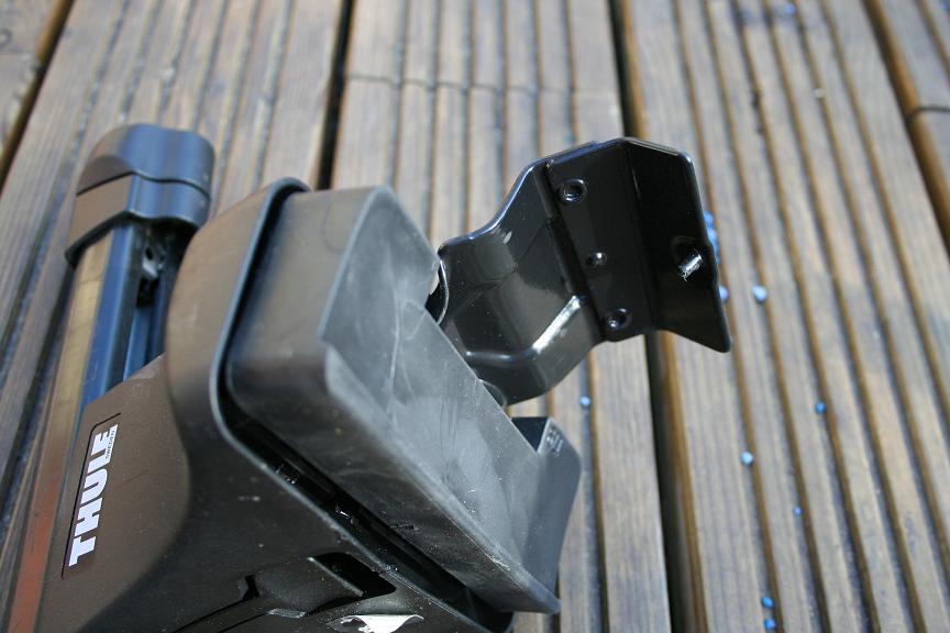

The 'feet' part of the system, have a little nob which fits into the whole you are talking about. They also have a rubber mound which fits on to the ridges running down the side of the roof.

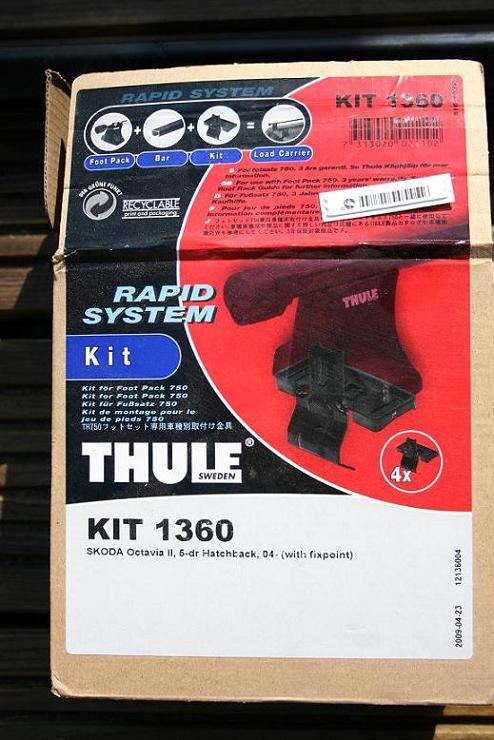

Should be these brought mine on e-bay for £50 it was a bargain as they cost £170 new.Thats with the bars as well.
Thanks Chris - picture says a thousand words etc. :thumbup:
