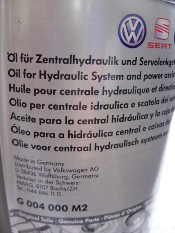

I was issued this for my 2005 Fabia VRS by Skoda parts dept.
