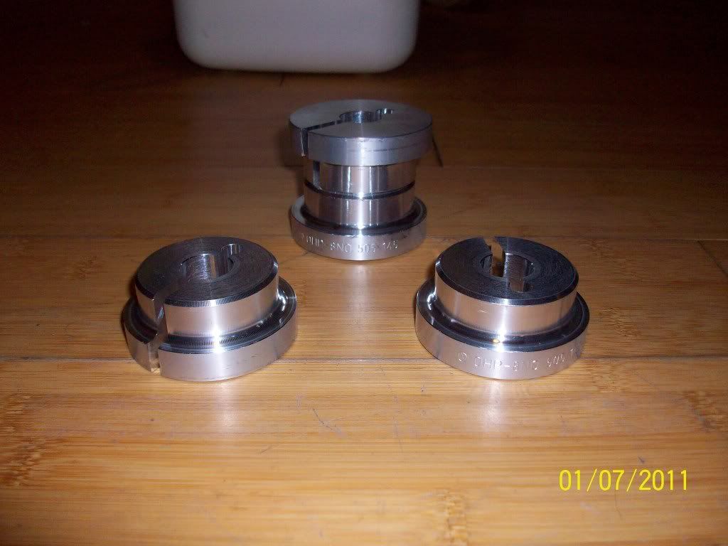

Well four bonded 'rubber' mountings for the rear subframe turned up today;
At least they are very shiny.
They're not OEM ones surely?
Do look cool though!
Yep they are genuine parts. Have the Audi partnumber stamped on them. Got them from an Audi dealer in Northern Ireland.
Yeah, I can see the 8NO number now that I look.
They seem a bit shiny for OEM, look like something Compbrake would make.
They do look a bit bling, thought they would be rubber coated similar to the front subframe bushes really. Haven't got them fitted yet, need to order some new bolts first.
