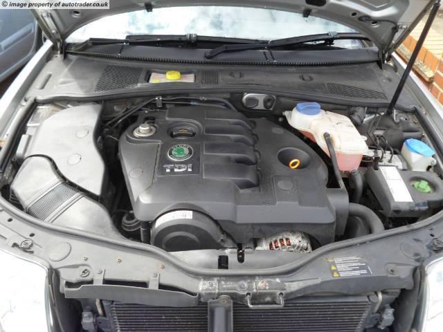

could someone look under there bonnet on there Superb for me :rofl:
Were looking toward the bulkhead on N/S there should be a little cover or something that holds down the covering to the wheel arch area (nearish the bonnet lifter) can someone pop theres off and get me a part number as my local skoda dealer keep fobbing me off with there struggling to find the part as there only used to renaults :doh:
I know its only a little part but everytime I open the bonnet I see this little painted thing sticking up.
Cheers folks

If it's what I think you mean (a picture would have been good) is the locking cover on the wheel arch liner. IIRC, it's an oval shape.
If that's the part you need, then it's 3U0809967 and £3.50
had a looksie on autotrader and found a picture although it looks like it hasnt got on either
top right of picture to the right of bonnet lifter theres like carpet/sound proofing material with a little peg showing through a circular cutout.
Now I know which bit you mean.
Unfortunately, there are quite a few sound absorbing components that are not available as spares. This is one of them.
What you are probably missing is a plastic washer. If you look in the hole, it the head still on the plastic spike? If so, then you will need to make a plastic washer for the head to clip into.
