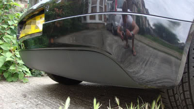

Not my car but it shows that a perfectly smooth finish is achievable, it's the part below the line and number plate....
