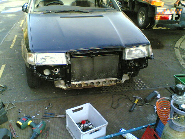

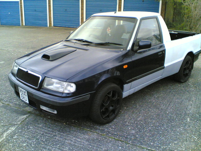

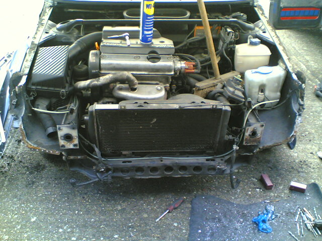

post-68203-0-09957100-1315846567_thumb.jpgpost-68203-0-77608300-1315846620_thumb.jpgpost-68203-0-77608300-1315846620_thumb.jpgpost-68203-0-53128600-1315846154_thumb.jpg
hi, i changed the front, i did change the whole front panel but you could just change the slam panel & alter bonnet cable, the head lights all bolt in, its a fairly easy job,
