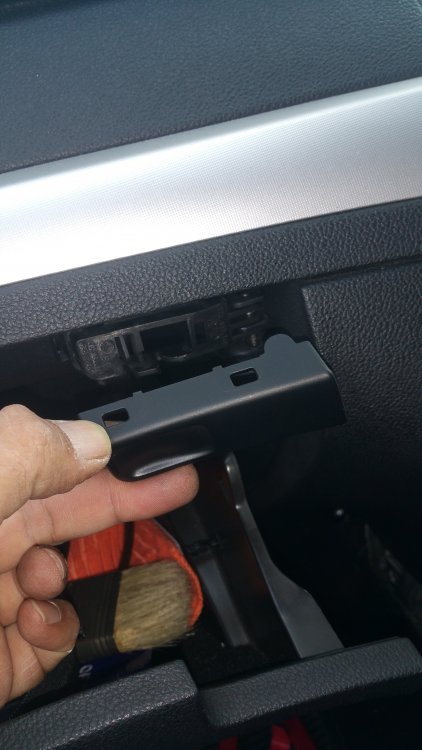

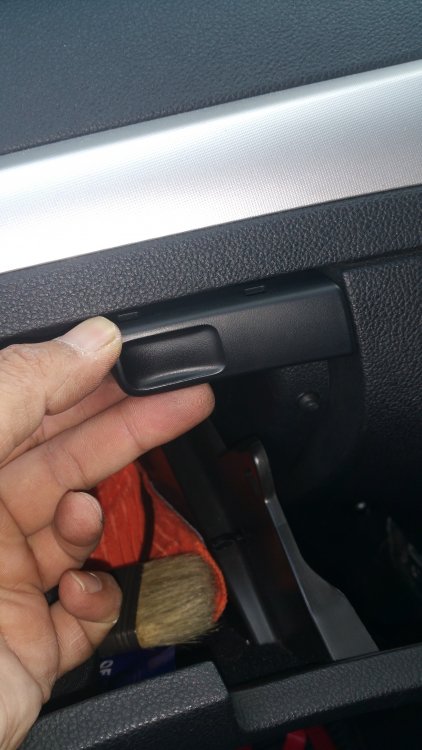

This is the problematic handle:
And this image shows the hook, and also the screw behind:

I can't believe I'm having this much trouble with something so seemingly simple. I'm pushing the tab in, but the handle doesn't slide in any direction. I'm trying to force it with screwdrivers, but it is as if it is glued in place.

The cover doesn't slide. Once you push the button underneath in then gently lever the bottom half towards you. There are two catches on the inside (on the top) which will disengage, and then you can gently lever the top half towards yourself as well.
The button will come off with gentle pressure, do not use too much or the catch will break.
Sorry about the delay. I'm sure Dustpuppy's method would work, but I couldn't get it to. I ended up buying the L shaped torx, which finally enabled me to get the glove box off.

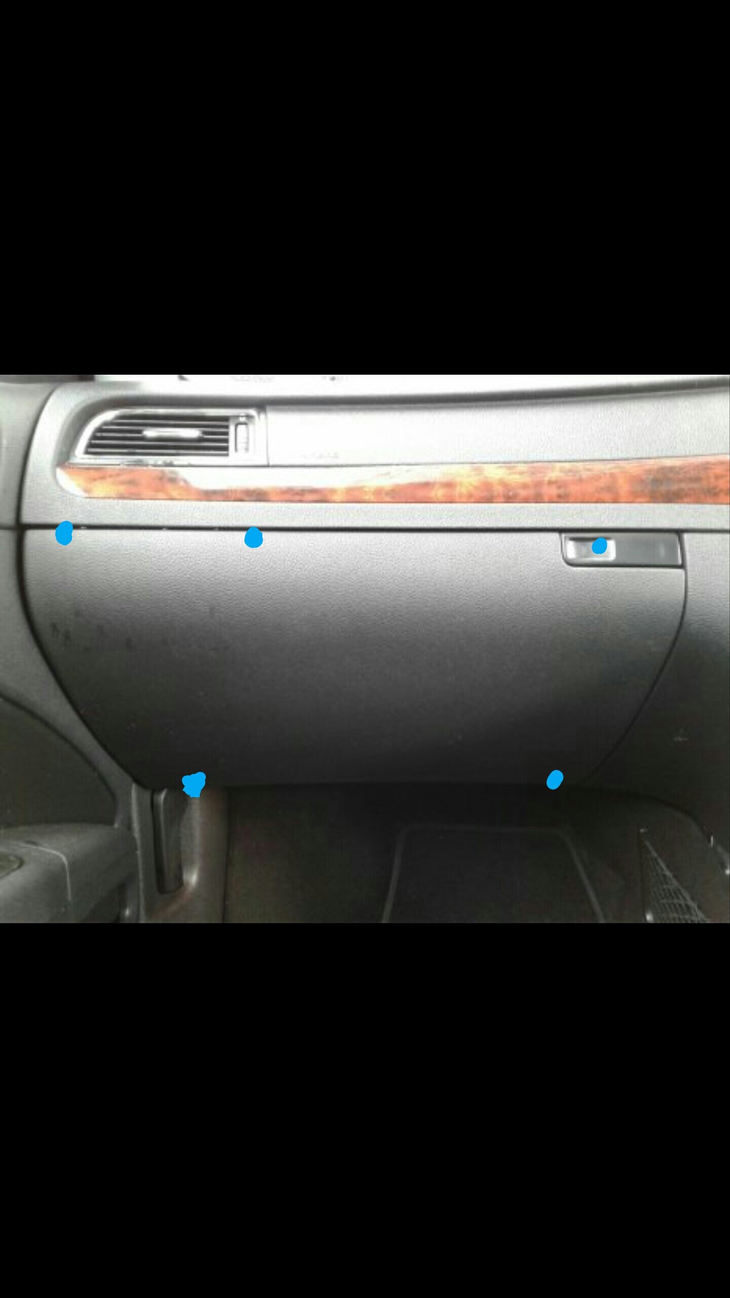

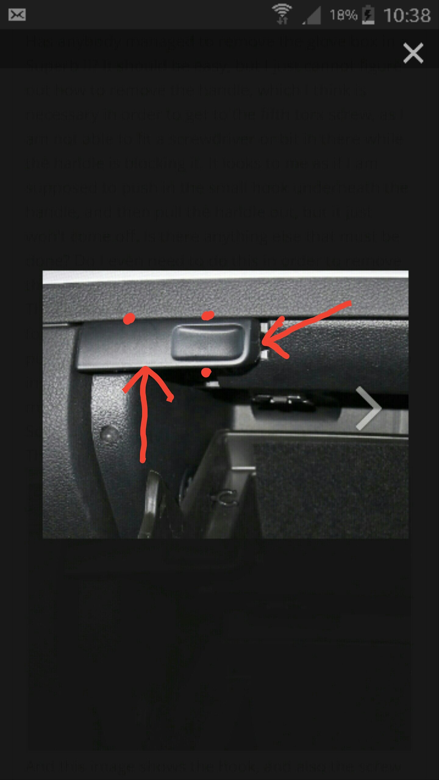

If you want to run wiring at the back of the glove compartment then you will have to remove the compartment  !  It has 5 screws blue dotted.  The 5th screw is behind the push button.  The button it self is a fascia or trim clipped on to the mechanism.  The red dots is where it's clipped on and red arrows is where you want to grip with fingers or use a trim removal tool to pry it towards you . Once the button is off you have access to the 5th screw .
Edited by 9@zA
To explain differently
Don't go crazy on it. Gently will do it !
