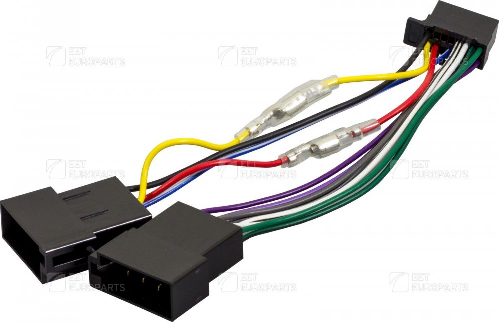

Sorry to re-open this topic after such a long period of time but I am having trouble with my new Sony stereo which has a bullet connector on the yellow and red wire.
I need to swap the red and yellow over but I have no idea how to open the bullet connector! Do I yank the wires and hope they come out and then swap them over? I can get the rubber casing away on the red wire but not the yellow one.
I've spent so much time researching and yet I've found nothing... Decided I'd create an account here and hope for the best!
Please see the image of my ISO adapter which came with the stereo. Just a heads up I am a massive newbie with electronics so be gentle! Thanks
Pull forcefully!

It might be worth mentioning that the yellow cable has a double bullet connector and I am unable to peel back the rubber cover which protects it. I have however managed to move the rubber off the single red wire and bullet connector.
When I removed the rubber from the red I was pulled with a great deal of force and there was very very little movement. Do you still advise to pull? Should I grab by the metal or by the wire and pull?
Thanks!
It might be that the connectors are covered in shrink wrap so just cut that off first. You can use electricians tape to insulate after reattaching both cables. :thumbup:
Marvelous thanks John, I'll give it a go :thumbup:
Thanks for your help John, I managed to pull the cables apart last night and switch the red and yellow over. The memory sticks now when I turn off the ignition. :thumbup:
